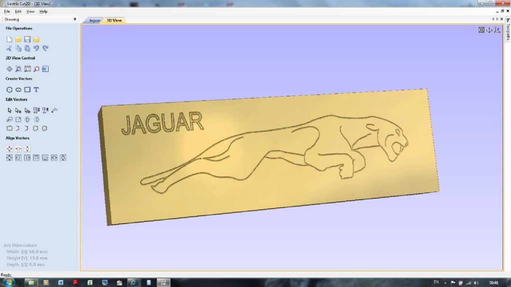

I am just starting out on cnc and trying to use 2DCut to generate G code for Mach3.
I have tried several projects, some from dxf files and others drawn in 2Dcut but all with the same result.
All seems well in the 2DCut programme, the preview works OK. It saves the Gcode as a text file, when I load this into Mach3 there are masses of circular tool paths As can be seen in the above screen shot.. The actual tool paths wanted are in there (red lines) but obviously something is a miss.
Anyone using Vectric 2DCut and Mach3? Any ideas of what the problem is.

Here is a Preview from Vectric showing what the expected result should be.

Have you got the post processor definitely set to Mach2/3 mm (or inch)? The choice is in the drop box immediately above the Save Toolpaths button. I've been using Cut2D with Mach 3 for the past year and it has always worked well with no interface problems with Mach3 on a KX1 mill.
Jim.

In Mach3 go to the Config menu on the top line, select General Config and in second block from the left 2 down ? there are two radio buttons for Arcs.
You will have absolute selected, change this to incremental, close the program, reopen and jobs a good un.
As Jim says you need the correct post processor.
Edited By John Stevenson on 09/10/2011 18:54:09

Mach as setup out the box is mainly imperial. If your code has G20 at the start it will work in imperial or G21 makes it work with metric but there are other underlying parameters that force some imperial moves.
When Mach load up it reads an XML file that is saved from your last settings and if you don't tune these setting you have a miss matched set.
For the metric guys go to Config > General Config and roughly central is a line called Initialisation String.
Not sure what the default is as I don't have a standard program on my machine but I think it's something like G80 F6.0 this tells the program on load up to cancel any drilling cycles and run at a default feed rate of 6 inches per minute.
If you are working in metric this is then read as 6mm per minute which is an absolute crawl.
A metric users string need to have the following
G21 G40 G49 G80 G91.1 F125
This will put it into metric mode, cancel tool length offsets, cancel tool offsets, cancel drilling cycles, put arcs into incremental mode and run at 125mm per minute which is a nice default speed.
Again close the program, reopen it and you are now in full metric mode.

Jim, yes I saved under mach2/3 mm
John, I made the config changes you stated and it's now working perfect.

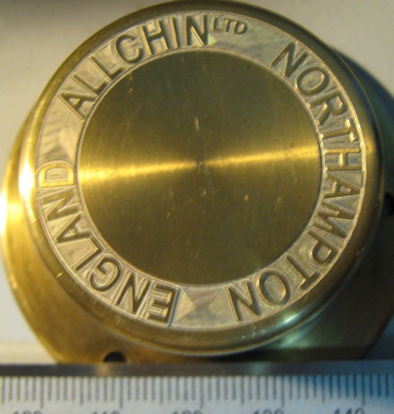

Result
1st Vectric 2DCut engrave
2nd Vectric 2DCut - pocket mill
Allchin Front Wheel Hub
Milling cutter 0.2mm x 20 deg engraving cutter, 8000 rpm, 200mm/min max.
23500 lines of code.
A liitle more conventional machine work to do then just need to infill with red enamel and polish

I am a Cut2D Mach3 user - recently graduated to BobCad Cam for 3D work. How did you generate the .dxf file for the brass hub caps (or whatever they are)? Cut2D has very limited cad capability so I tend to bring .dxf files from Autocad into Cut2D then add the text in Cut2D but I wasn't aware you could fit text to a curve. Are you generating the text elsewhere?
Ian
GoCreate19/11/2011 12:29:19
avatar
387 forum posts
119 photos
Hi ian
I use autodesk inventor for my work so I am able to use this for creating quite a few dxf and stl files for my cnc work. This software allows you to fit text to a curve.
