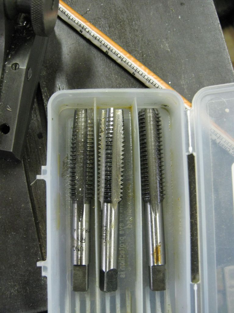

notice that the tap on the left has more taper. the tap in the centre has shorter taper and the tap on the right almost no taper.
from left to right we call them start, intermediate and bottom taps.
