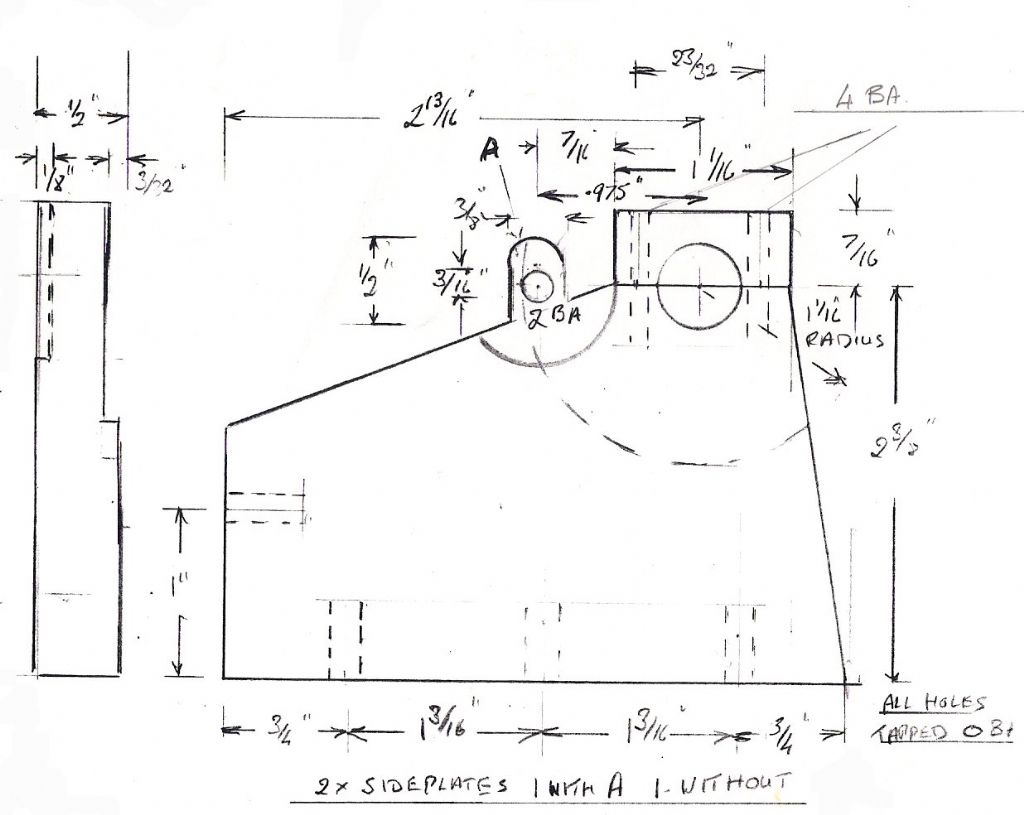

In the latest issue you have asked for comments on the drawings that acompany these two items, a few points I have spotted:
Rena Fig1. There seems to be some inconsistancy with the decimal "fractions" some are given to only two decimal places eg 2.28, one assumes this is 2 9/32 which should really be 2.281. Some are rounded down and some rounded up eg 3.345 assume 3 11/32 so 3.3438 but as you seem to be rounding to the nearest 0.0005 then 3.344 would seem right. Again 2.155 assume 2 5/32 would expect 2.156. I have no issue with printing to the nearest 0.0005" as this is what most peoples digital callipers/mics etc will read to but can it be consistant.
On both models there are radiused corners and edges, no radius is given. I know this is not a critical part of the model but would be nice to have.
Again on Rena the two side plates Fig 2 &3 are drawn to different sizes, this is possibly to keep column widths the same but I would personnaly like to see the parts to teh same "scale" even if there is a bit more air around them.
Apart from that they are fine to follow but a beginner may be trying to mark out to the odd 0.001" or so accuracy rather than 1/32nd increments.

Numbers are not rounded up or down but are as drawn.
Four decimal places looks stupid on say a 16.0000 dimension.
I redrew it from the pencil original and most of the dimensions were originall fractional but not all of them.
The drawings were all drawn to scale and must have got altered in size during the production process.
regards David
 David I agree that the 000 can be left off the end but if the original sketches were in fractions why draw it 2.28 when the decimal equivalent to 2 9/32 is 2.281 or was this originally a decimal.
I can see why some of the dims were originally given as decimal, the gear ctrs and the setting out of the PCD being two examples.
Jason

9/32 is not on the original drawing.
2.28 is the way it worked out after redrawing.
Click on drawing to enlarge.
It more likely came from the .975 gear centres and was a compromise so that the radius between the gear pillar and the edge of the bearing cap was a standard size, 2.28 - 2.155 = 1/8 rad or 1/4 diameter cutter. If the average reader tried to use the original drawing, half the dimensions are missing.
This is a typical example of drawings received.
regards David

I had to redraw it so it is decimal not fractional.
I also have to make sure it fits together.
regards david

Thanks for the clarification David, I can see that the 7/16" and half the bearing cap width dont add upto the gear centres and you have done the best you can with what you were given
