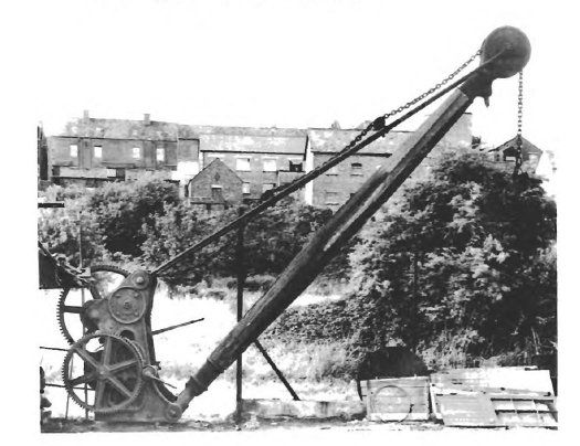

Martin W11/02/2010 18:06:09
940 forum posts
30 photos
I found this picture of a crane, not the same as yours, but it has a chain to the hook and like yours the stay from the jib to the column has several cross members which appear to be the chain support.
Cheers
Martin
Stub Mandrel11/02/2010 21:23:50
avatar
4318 forum posts
291 photos
1 articles
Martin, that's an amazing photo, the wooden beam is extraordinary!
I'll have to add that pic to my 'future models' file
It's rather bigger than mine - you can see it has two sets of gears instead of one and the handles are quite low down by comparison (or the crane is bigger and they are the same height, if you get what I mean). I'd guess the cable drum at right is about 4' diameter.
I see what you and Ian mean about rollers.
