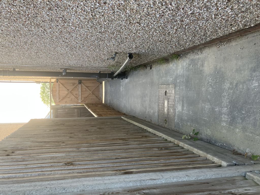

Hi
At some point in the near future I have to disassemble my 1ES into manageable chunks in order to get it down the side of the house and into garage.
im thinking, table off, overarm off, motor out, then removing main column from base. Anyone have experience taking the 1ES apart. I’m sure I could work it out but any help/things to avoid doing would be greatly appreciated

Thanks. It’s not really the moving of it that’s the problem, it just won’t physically fit down my side entrance as it is.

The base is too wide to fit through so will have to go in it’s side
so might be able to leave motor in, but column would have to come off

How many parts did you break it down into Clive, I’ve had another measure up and might get away with just taking the table off, but it’s going to be tight.
I 've just got to know lol , how wide is the alley way.

about 30” same as the base. Where there is the Will lol

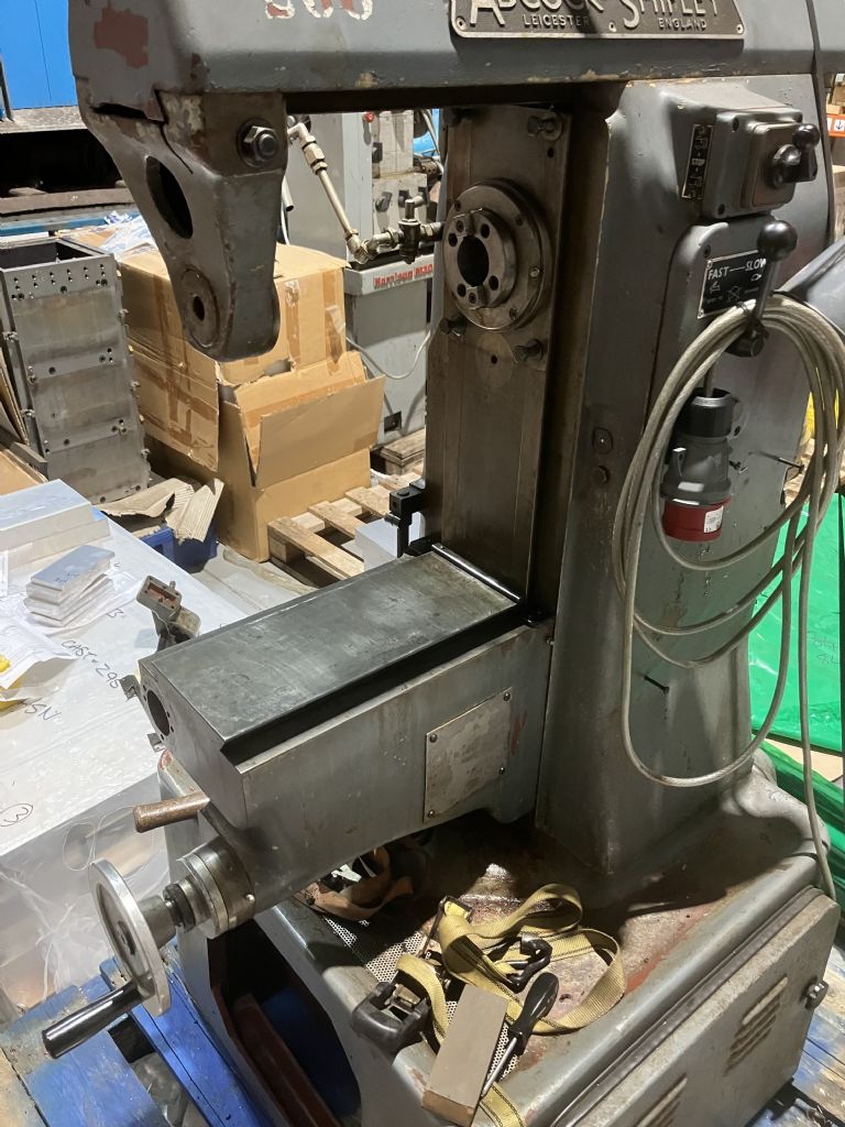

I dismantled most of the machine in this order: Removal of vertical head, table leadscrew, table, table base with gearbox, cross-feed, knee (which had to be removed vertically), motor, feed pulley, countershaft, electrical gear, disconnection of coolant pipework, and finally separation of the column from the base. I didn't remove the rear bearing cover or disturb the gearbox. Reassembly was straightforward. Hope you find the best solution for you!

jason evans20/09/2023 13:30:35
69 forum posts
16 photos
well I’ve got it this far, not quite sure how the knee comes off without taking spindle out though.img_5863.jpeg
