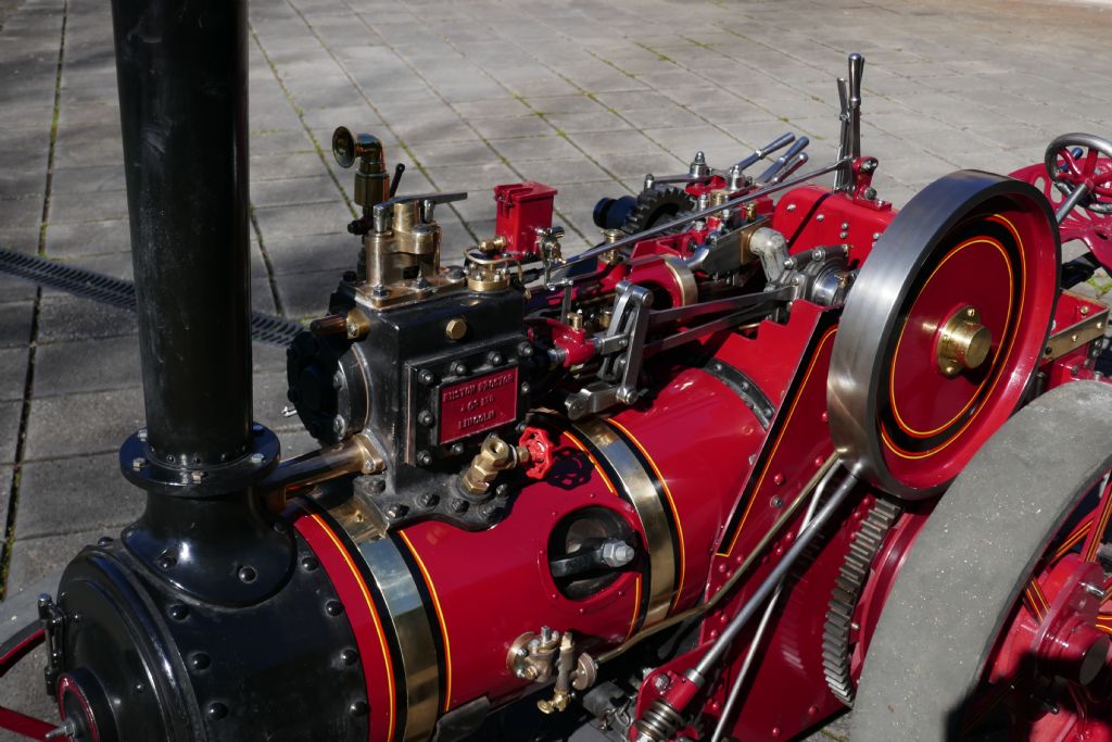

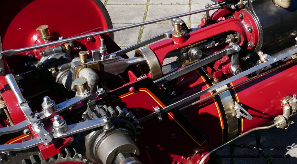

On my Ruston Proctor engine, the quadrant link is up when going in the forward direction. If is was assembled in the down position it would just be a matter of swapping the connection of the links to the eccentrics to go forward.
A difference with the Ruston, compared to some other engines is the control lever points up where others point down.

Most traction engines (Three Shaft Engines) run link down to save wear and tear on the lifting link pins, on a Four Shaft Engine which the crank shaft runs backwards, in order to get the link down in forward gear the eccentric rods have to be crossed.
Michael
