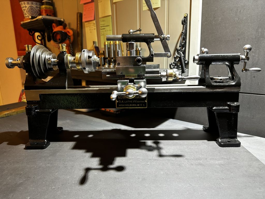

Hi everyone.
a couple of years ago i bought this George Adams lathe on eBay, as a had always wanted a small lathe that i could use. When i received it, it was in worse shape than i thought it would be. The whole chuck had massive wobble, and the lathe bed was in very bad shape. It also was badly rusted. So i ended up just putting it into storage.
this year i took it out again, and decided to give it a go, and try to get this lovely little machine back into somewhat working order. And this have led me to come here. Both to ask some questions, and i suppose i wanted to show it off.
Pulling it apart, and inspecting the headstock further, i found it to be in pretty good condition. The spindle and cone bearings all look perfect, and it has no slop in it at all. The huge wobble turned out to stem from a bent backplate on the chuck itself. Which leads me to my first question:
this backplate, are these custom made by craftsmen back in the days, or are they possible to buy somewhere? Since this machine seems to be very rare, and very little information to be found out there, i suppose finding one that would fit both this spindle and type of chuck is impossible.
The chuck itself also seems to be one of those things that just dont exist in the world anymore. Which leads me to my 2nd question:
The chuck reads Goodell Pratt Company. I have not been able to find much information about this specific chuck, at all really. But my chuck jaws are completely worn out. It wont hold anything, as it just clamps down at the very back of the jaws. Is it possible to find new jaws that would fit this chuck? If not, i need to try and re grind them.
on the headstock, it has these beautiful brass oil cups. But one of them has at some point had the lid broken off. I have searched everywhere i could, but finding a replacement has so far been futile. Any tips on this would be greatly appreciated.
I am sure i have many more questions, but these are what i could remember when i tried to write this post.
i havent done anything with the bed itself yet, other than remove the surface rust that it had. But i plan to find someone who can re grind it for me. I also need to make a new “nut” for one of the lead screws in the cross slide, as the threads are badly worn.
and yes, i know i have painted the lever tail stock in a different paint. I just wanted to try something else, as i am not completely satisfied with the black colour that i have used on the rest of the machine.
***okay, so i tried to add in my pictures here, but i have no idea on how to actually do so embarrassed***

Here are the photos of mine:

That looks a smart lathe from here. Although you cannot really tell from photos, the bed doesn't look in bad condition. Have you taken any readings from it? Using a micrometer or a jig and test indicator?
Plain lathes don't get quite the wear that a screw cutting lathes do on the bed.
Do you have a straight edge? You can get a feel for major wear using a straight edge and a 1 thou shim.
Obviously you would need a surface plate to assess properly or scrape - but these can be purchased reasonably from ebay, but condiiton is everything. I have a new inspection grade one that I know is right and then a couple of smaller ones from ebay for layout and workshop use.
But as I say the lathe looks a good starting place to me.
James
Simon Rundsvoll03/08/2023 20:44:19
12 forum posts
12 photos
The worst of it you cant see, as it is under the tail stock. But it has very large, and quite deep pit rust there. So the tailstock is basically just resting on the high spots. But no, i havent really measured it. I am pretty new to all of this, but i have invested an immense amount of time into the rest of this lathe, to restore it into what it is now

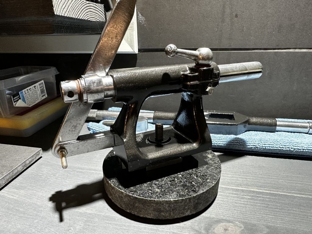

That second tailstock is interesting - can you provide a better photo of just that please.

The damage to the tailstock area is worse than I had thought. You're not going to scrape that out.
Whilst I agree that having a perfectly flat and aligned bed isn't essential on a plain lathe, for accurate, consistant and timely work it's nice to have. If I'm honest though I wouldn't spend the time on this bed getting it to that state.
I think the view that you should use the lathe and see where you go from there is good advice. You might find it does all you wan it to do, or else you'll out grow it but know what you want in the future.

Yeah i did this yesterday. And it seems to have worked quite well. Now to look into the jaws..
here are some pictures of the 2nd tailstock
