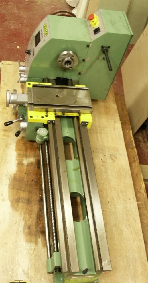

On my 280 I took off what would come away easily, wound the carriage to the far end and then put a nylon strap around the bed making sure not to squash the feed screws then hired an engine crane to lift it onto the stand.
I found the stand OK but replaced the flat middle panel with some draws

The GH stand comprises two vertical cabinets that act as 'legs' with a steel back-panel between and 2 shelves. They are topped by a full size tray with folded sides and welded corners and the whole lot together forms an adequately stiff structure.
Mine arrived with the lathe, think they were on the same pallet, crated lathe on the bottom, stand components on top, whole lot wrapped in transport film.
I moved mine (twice) as outlined by Jason, put a couple of bits of 4x2 under / against the bed to keep the slings off the leadscrew, I slung mine under the bed against the headstock and simply used a small ratchet strap between the hook and the tailstock end to level the thing up.
A 2t engine crane will lift it at full boom extension no problem.
