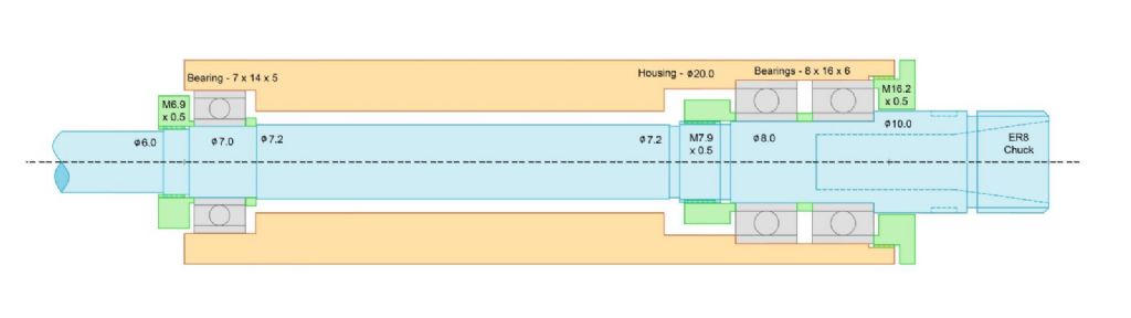

Steve Crow22/07/2023 15:38:42
429 forum posts
268 photos
Critical comment time!
Preliminary drawings for my spindle with a few critical dimensions. Front end first -spindle front 1.jpg
And for wht it's worthh, the whole thing -
The colours are for clarity, they are not meant to represent materials.
Steve
duncan webster22/07/2023 19:21:46
5307 forum posts
83 photos

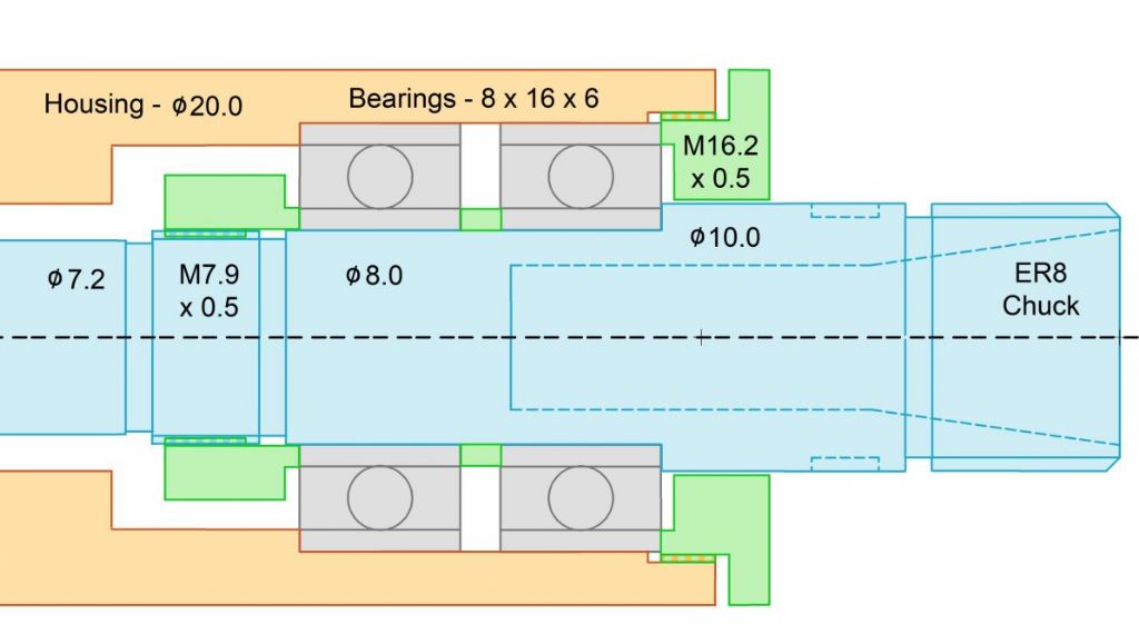

Is that to scale? You can buy ring nuts from SKF, but not to those odd sizes. If you bore the centre section to say 14.5 diameter you can assemble the bearing to the shaft first, then slide the whole thing in from the front, this is a lot easier than trying to assemble the back bearing in situ. 7mm ring abutting a 7.2 mm step isn't a lot, you could omit the M7.9 nut and have a sleeve between the bearings
HOWARDT22/07/2023 19:41:45
1081 forum posts
39 photos
Minor diameter of M16.2x0.5 is 15.7, so that is a no, would need to be at least 16.5. Spacers between both inner and outer rings at the front, ground to suit the bearings will give some preload, otherwise nut is not locked in place. Use a snap ring below the upper bearing to give a larger thrust shoulder. Use M7x0.5 for rear thread, no point in odd size. As previous bore through for simple assembly. Make front pair bearing nut M8x0.5. It is quite normal for the bearing locknut threads to be same size as bearing bore. Machine to ensure concentricity of all bores. At 15k use light air oil lubrication, will also help o keep the swarf out.

Steve Crow22/07/2023 23:17:09
429 forum posts
268 photos
Posted by HOWARDT on 22/07/2023 19:41:45:
My error the, thread should be M17 x 0.5.
The odd sizes were just meant to show clearance on the thread crest. Effectively, they'll be M7 and M8.

Kiwi Bloke22/07/2023 23:37:55
912 forum posts
3 photos
Not a criticism, but a suggestion...
The design can be simplified, removing one screw-cutting operation, and making the spindle itself simpler to machine.
Instead of a ring nut against the nose bearing inner track, a tubular spacer can be substituted, between the inner tracks of the inner nose bearing and the inner track of the tail-end bearing. Everything is tightened up by the tail-end nut. The tubular spacer should be a close fit to the spindle shaft, and will increase stiffness as a bonus.
Probably need a simple locking arrangement for the ring nut abutting the outer track of the outer nose bearing.
John MC23/07/2023 10:38:05
avatar
464 forum posts
72 photos
A rather complex solution that can be simplified as Kiwi bloke suggests. Also, remove the spacer between the two nose bearings, clamp them together. Maybe a circlip rather than the M16 threaded holding the outer races?
The mounting of the third bearing is as it should be.
Another thought. Why not reduce the overhang from the nose of the spindle by removing what looks like a plain diameter with spanner flats(?). Then contrive something at the other end of the spindle to hold it while tightening the collet nut.
Its good to see a design that doesn't (grossly) over constrain the bearings as many do, that are published in the world of ME.,

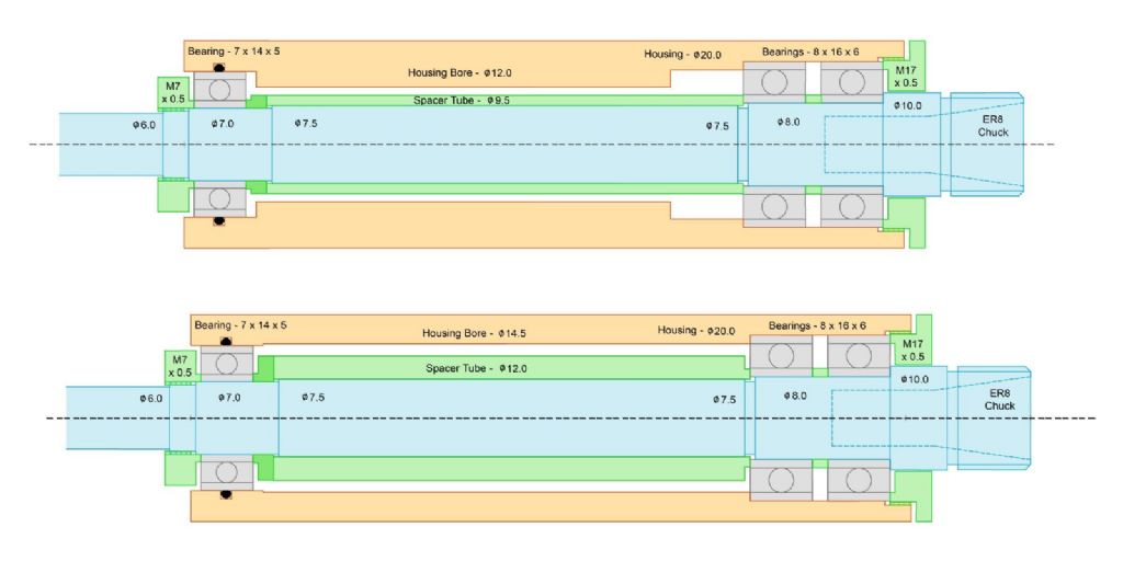

Steve Crow23/07/2023 11:18:08
429 forum posts
268 photos
Thanks for alll the suggestions. I'm all for simplifying things.
The tubular spacer sounds a good idea, I will do another drawing.
Reducing the overhang as John MC also sound good but I'll only lose 4mm that way. Still worth doing.
The spacer between the nose bearings was an earlier suggeston from Kiwi Bloke though maybe I misinterpreted it.
Regarding the internal circlip at the nose, I thought you would need a degree of adjustment here to clamp the outer race against the housing shoulder?
As for suggestions that I bore right through 14.5mm so I can fully assemble the spindle first, I don't understand how I would secure and locate the rear bearing?
Steve

Kiwi Bloke23/07/2023 11:48:53
912 forum posts
3 photos
The tail-end bearing's inner track is sandwiched between spacer tube and nut, so that's OK. The spindle is fully axially located at the nose end. The outer track of the tail-end bearing should be allowed to 'float' (a snug, sliding fit), to take care of possible thermal expansion. Andy_G's illustration of an O ring bearing on the outside of this track is good practice - it reduces the ability of the track to slowly walk around the bore of the housing.
Agreed that you can't fully assemble the spindle before assembly into the housing, but all the important bits can be in place, except pulley and nut, of course. I'd keep the nose bearing spacer, unless you're going to buy expensive matched pair bearings. Adjustability is good...
Talk to your bearing supplier about bearing seals. It's possible to get non-contact 'seals' that don't drag on the spindle. Conventional seals can add a surprising amount of drag. And oil is probably preferable to grease. (I think someone else said that, but I'm editing this now, and can't see previous posts...)
Having now re-read the whole thread properly, I'm conscious that I've essentially re-stated Duncan Webster's ideas, although perhaps with different emphasis. It wasn't my intention to steal his thunder. Just two (great?) minds thinkng alike (or suggesting standard solutions...).
It's heading towards being a really nifty, scalable spindle. Well worth your writing it up for MEW. It would raise the tone of the mag considerably...

Steve Crow23/07/2023 16:39:07
429 forum posts
268 photos
I'm really appreciating all this advice and I've tried to work in the suggestions for these drawings-
The second one can be assembled first and has a beefier spacer. Things are getting simpler!
All comments welcome.

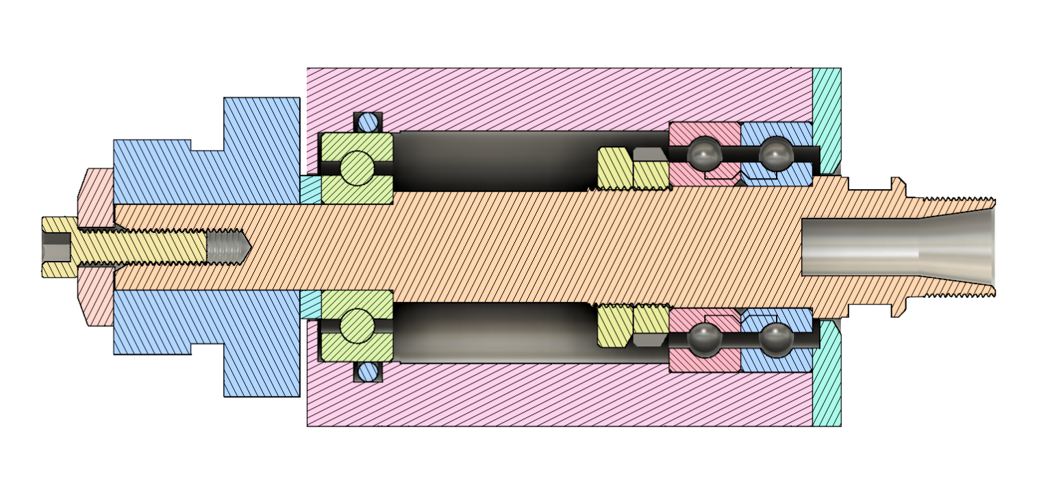

Iain Downs23/07/2023 17:49:51
976 forum posts
805 photos
I'm very interested in this thread as I've been in the process of building a similar type of spindle, but somewhat more naively.
In my approach, I only have one bearing at each end and I'm interested in what sort of issues this is likely to cause. In one design (I'm trying several!), I have the bearings loctited in each end, a loctited washer to act as a stop at the collet end and a nut to apply preload.
I'm using various chinese components, especially for the spindle proper (extension rods they call them), which I don't believe I can produce to anything like the needed accuracy.
I look forward to hearing how it goes!
