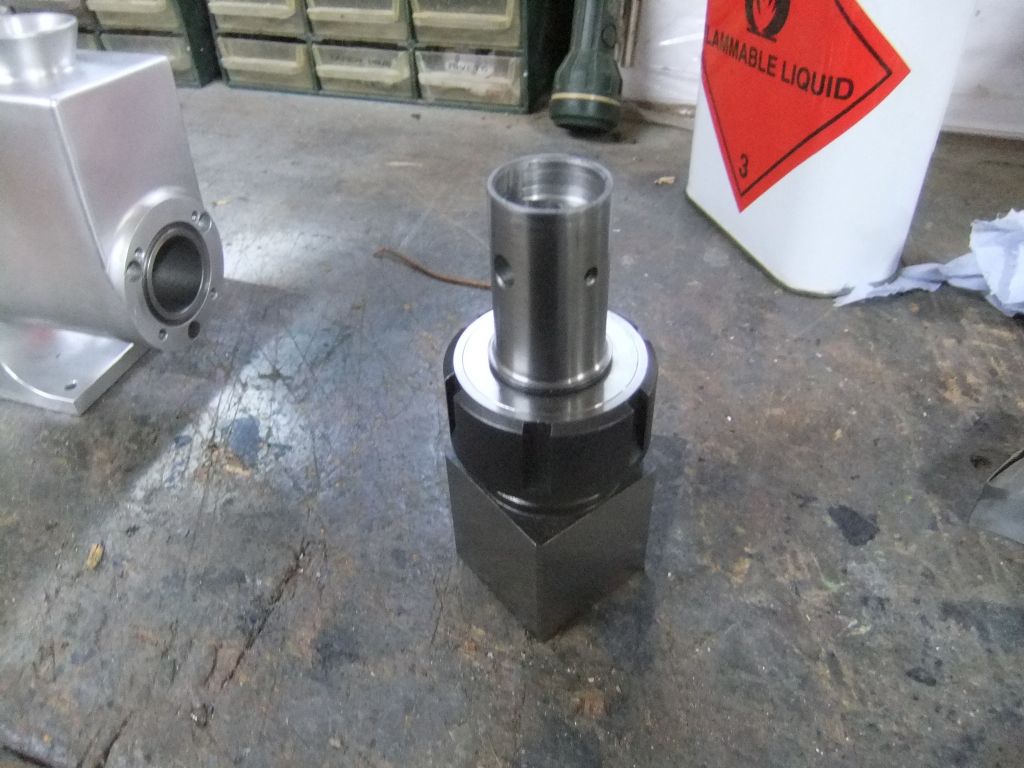

Today was a slow day I turned the end of a cast iron bar down to 19mm to fit a collet at one end and also a small section of the piston over size so I could reverse it in the 4 jaw chuck. I then reversed the blank in the chuck and turned down the piston to the correct size and faced off, this will be the bottom of the piston. so there is some drilling and milling the bottom as well as a cross hole.
That will be done in a square collet block as the features need to be at right angles to each other. Hopefully that will be done tomorrow as I spent a while getting the piston to a very comfortable fit in the cylinder. As a learner to the hobby like most things it takes a lot longer than a more experienced machinist.
The photos show the piston during machining with a magnetic tray in place catching the cast iron swarf very little ended up on the lathe, will need to turn the bag inside out to contain it. I must buy some plastic bags as the wife keeps on wondering where all the bags are disappearing to :LittleDevil:
The last couple of photos show the cylinder liner in place. If you look carefully there is a small witness mark at each end this is so I can line up a oil hole in the cylinder with the one in the hopper

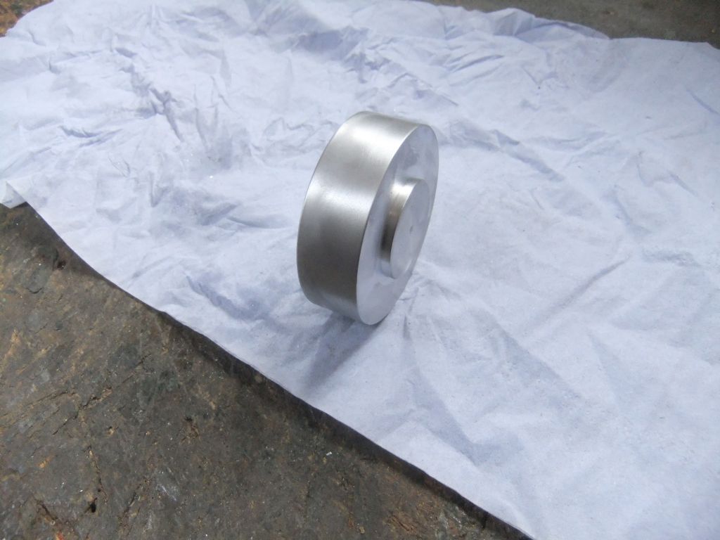

Not posted much but realised that I had not posted the progress on the piston all turned to diameter and the inside milled out and hole drilled and threaded. Still need to part off to length and do the piston ring groove when the o ring arrives
Had a very minor mishap on the inside but nothing that would need any more than a little clean up as it I can barely feel the little ridge looks worse than it is.
I did the piston above a few days ago and decided to make the con rod in the mean time while waiting for the o ring.
After two attempts at this I threw the parts in the scrape pile and ordered some replacement ali. Yes two made and both buggered up by me making stupid mistakes
Any way having a day off of the Farmboy I returned today and turned the blank for the head at least that went right after double checking and double checking again was not going to have another con rod episode.

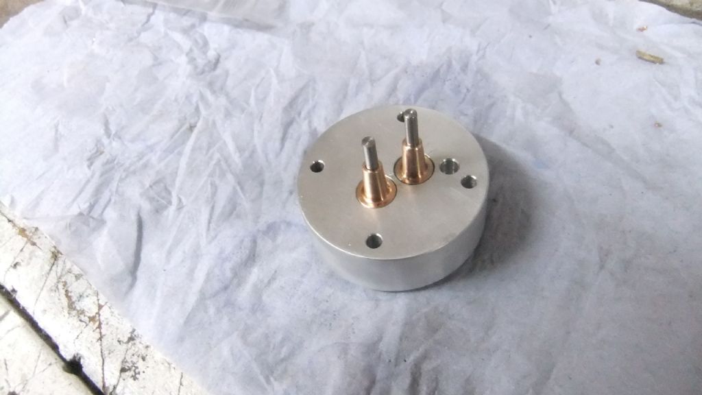

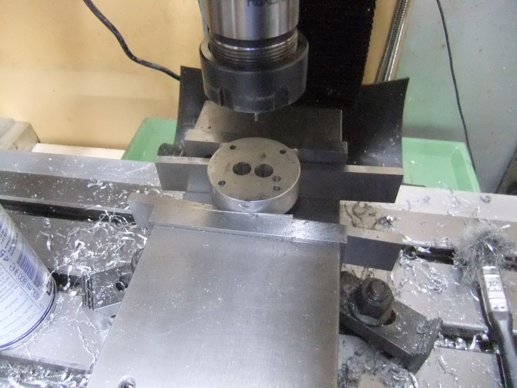

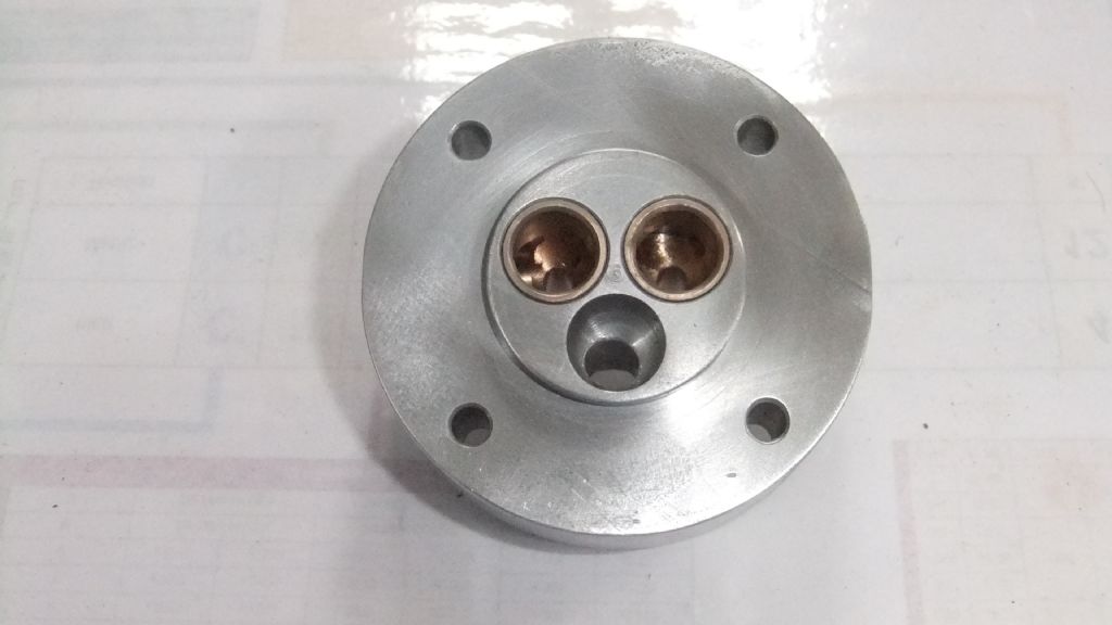

Dalboy28/07/2023 20:40:32
avatar
1009 forum posts
305 photos

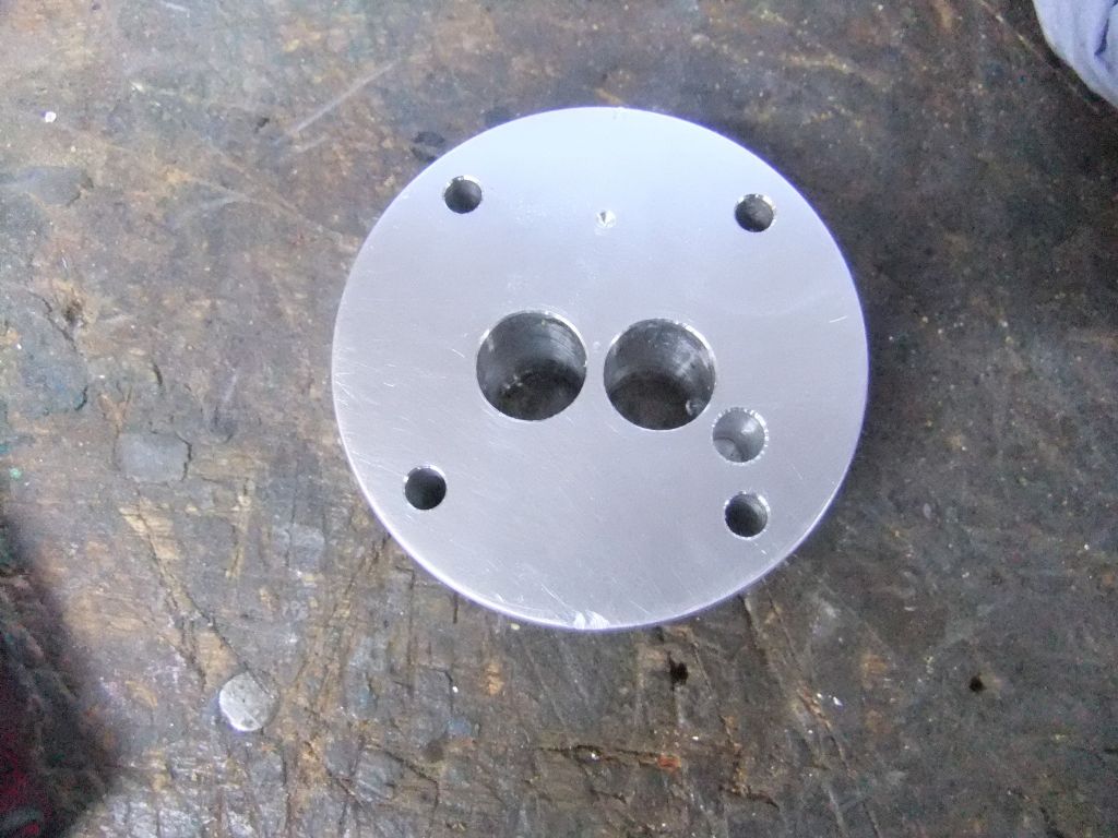

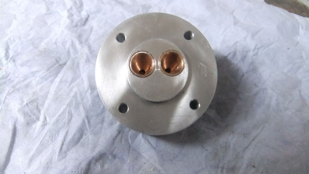

Started on drilling the cylinder head first was the small hole for a post to take the exhaust rocker. Also drill and ream the two holes for the valve guides

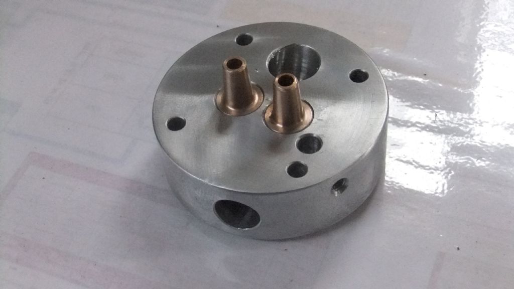

Then onto the four holes for the head bolts also while it was there I did a small dimple which will be where the spark plug will go. The reason the spark plug is not drilled yet is that it needs to be at an angle
top and bottom view of the head the dimple can be clearly seen. There are still more holes to drill some can't be done until the valve guides are made and in place
Edited By Dalboy on 28/07/2023 20:41:14

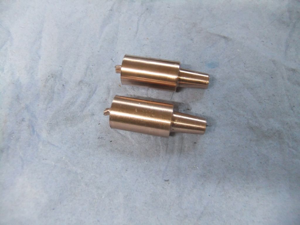

Dalboy30/07/2023 21:56:31
avatar
1009 forum posts
305 photos

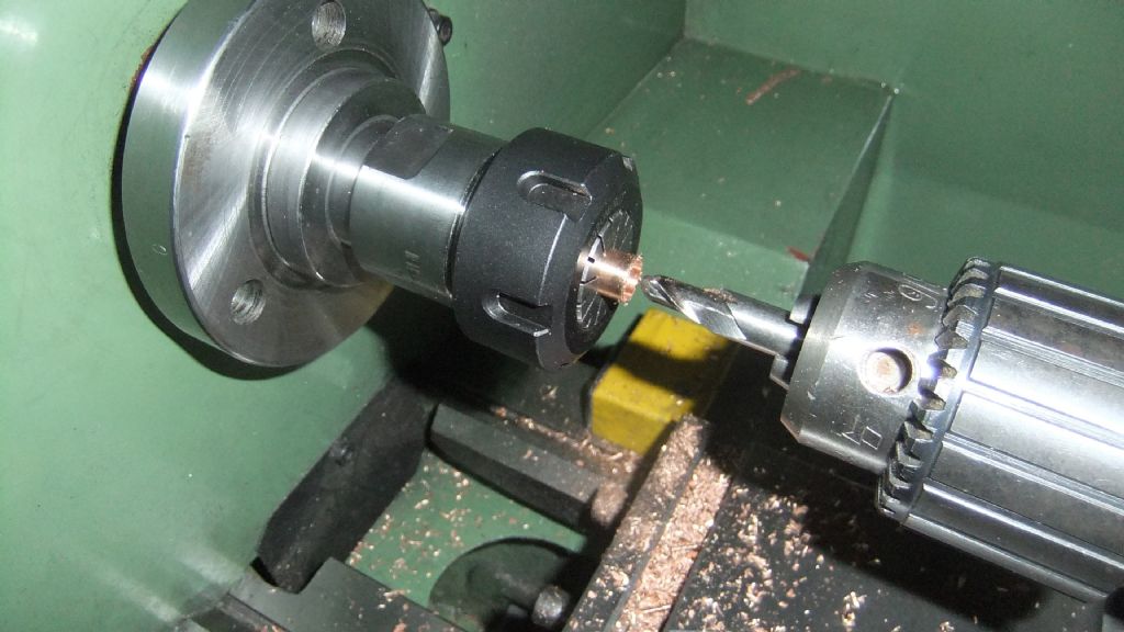

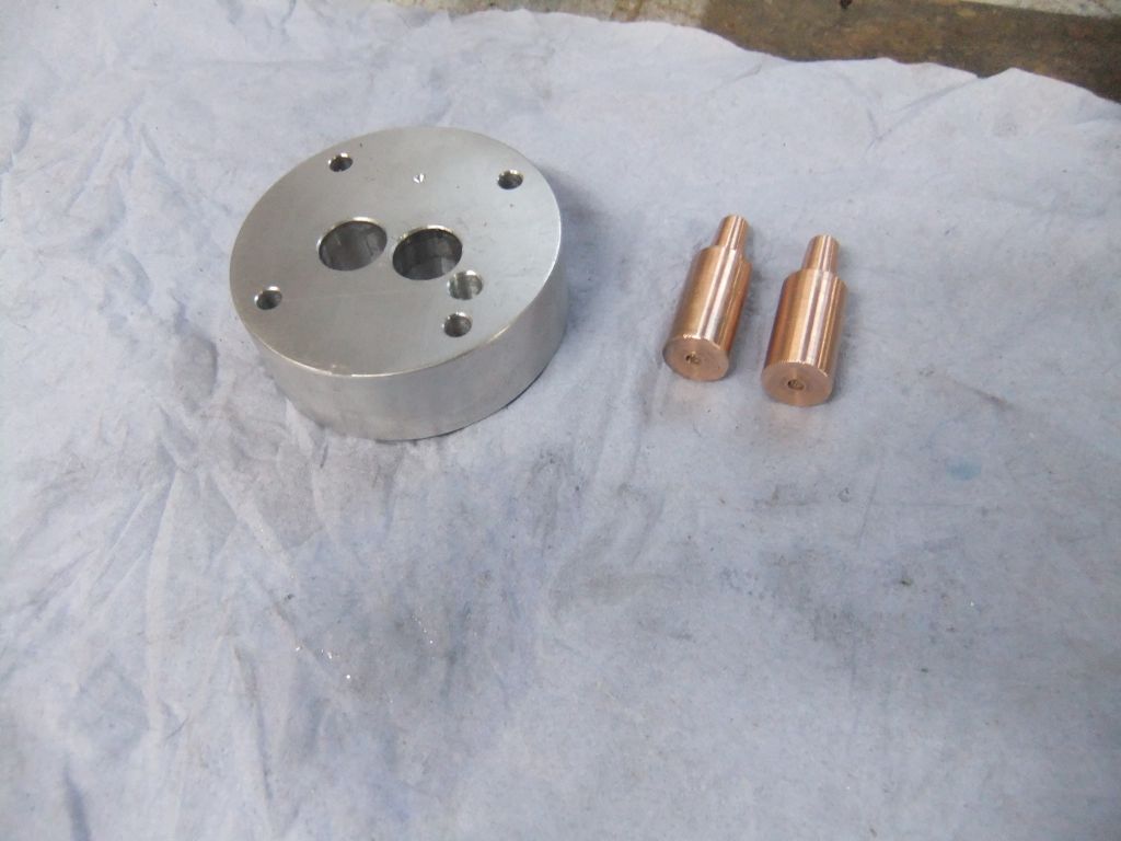

Been working on the valve guides as these need to be inserted in the head before some holes need drilling
Shaped the outside was the first job as well as drill and ream for the valve stems to fit. You can see that the bases are not yet opened up in the second photo.
Changed to a collet chuck so that they can be opened up note the bull nose cutter in the drill chuck to give a rounded bottom to the inside

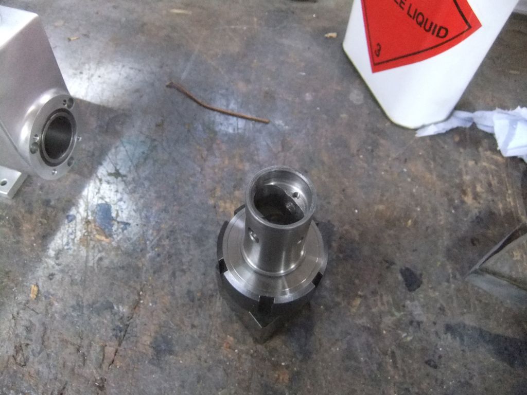

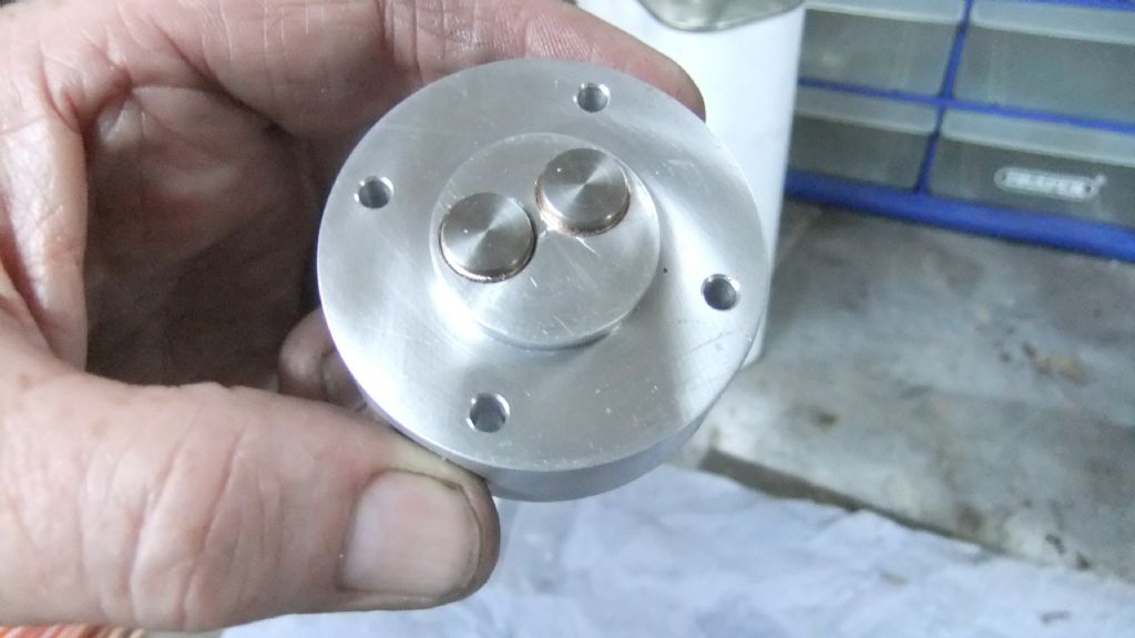

All complete and pushed into the head. They are not going to move now not only can I now drill some holes into the valve guides from the side but they also will aid in getting the at the correct angle as well allow for lining up the fuel chamber where the spark plug pokes through into the cylinder. As well as this it will aid lining up the angled threaded hole for the spark plug which I spotted earlier on in the head(see previous post)
Slid the valves in just for show, I will fit these properly when I have made some more parts for the head

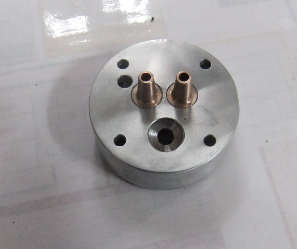

Dalboy01/08/2023 17:40:28
avatar
1009 forum posts
305 photos

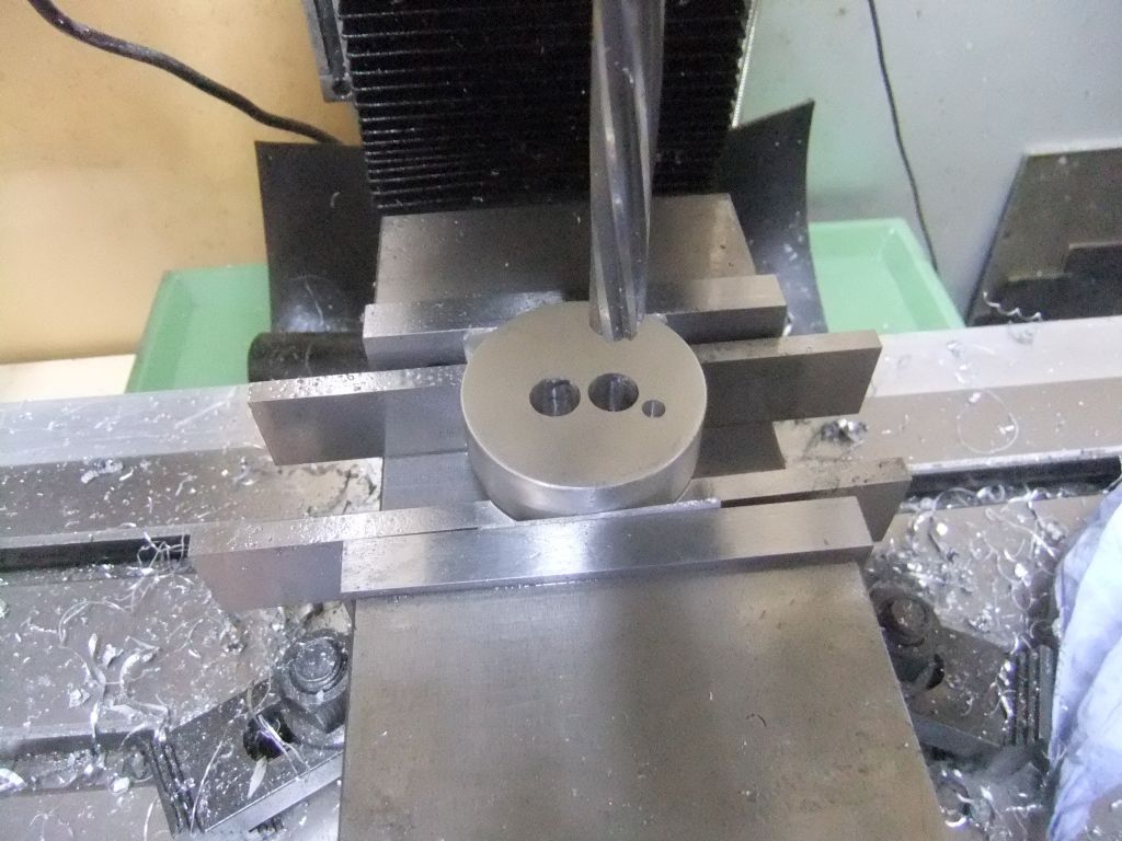

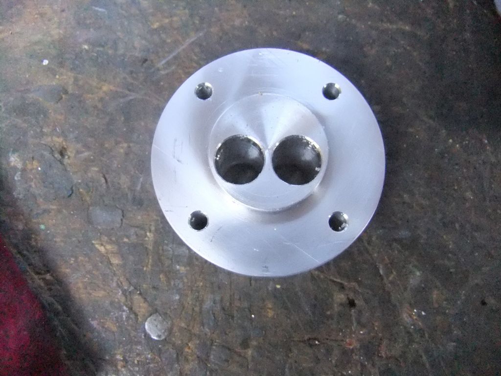

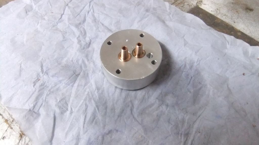

Except for the spark plug thread which is 1/4" X 32 and I only own a 1/4" X 40 which I seem to have a lot of, so have to order these are ME threads. The head machining is now complete, time to start on some of the furniture for the head like making valve springs and rocker assembly. In the last photo(sorry about the quality) you can make out where the inlet and exhaust ports enter the valve guides. The four holes which can be clearly seen in the bottom of the head photo are for head bolts, the other hole seen in the top of the head is for the rocker arm support and the little hole in the side for a grub screw to lock the support in place.
It seems as if everything turned out OK as closer to completion of the head I was worried that if something went wrong there is a lot of work to get back to here.
JasonB01/08/2023 18:52:57
avatar
25215 forum posts
3105 photos
1 articles
Looking good
One point to watch is that glow and miniature spark plugs are threaded 1/4 x 32 UNEF not ME - different angle
Roderick Jenkins01/08/2023 20:06:50
avatar
2376 forum posts
800 photos
In practice, I have found that 1/4" x 32 ME works fine but if you have to buy a tap you may as well get the right one.

Dalboy01/08/2023 21:26:32
avatar
1009 forum posts
305 photos
Thank you Jason for that info it just seems to be missing on the plans. All it said was 1/4" X 32 TPI so I assumed it was ME thread
