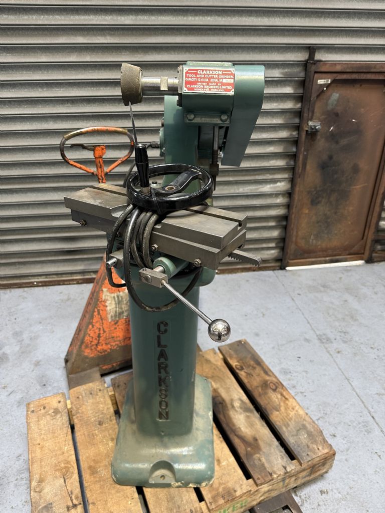

I wasn't shopping for one but somehow managed to acquire on last week.
It was delivered today and I took a bit more of a detailed look at the machine I'd stumbled into.
It's missing a few bits, handle for the infeed and the handle for the elevation of the wheelhead, plus there aren't and electrics apart from the motor.
Since it only has a set of centres I'm looking for some tooling for it, if anybody has some for sale or knows of any tooling for sale please let me know
Ian

The only tooling you need after a basic square tool platform is the universal head which is now rare and expensive. Just look at the fixtures for the Stent which is a sort of mini Clarkson or look at pictures of others and make your own. Solid lumps of cast iron rather than angle iron is the order of the day for solidity and freedom from vibration. There are some (normally green) universal heads of far eastern origin around for about £180 but would need modification.
Oh, the 'basic platform' above only needs to be a couple of blank angle plate castings bolted together, not some fancy wobbly arrangement intended for plain grinding wheels.

Thanks for the link to the website, there is a lot of information contained there.
Sometimes it's easier to purchase the required tooling than making it, or adapt tooling from another tool & cutter grinder.
I saw a MkI radius tool sell in Ebay for 150 in the last couple of weeks so tooling does come up at a reasonable price sometimes. I bought a Weldon 200 air bearing a while ago for just under $100.
There is some work I will need to do to it before it is ready for use anyway. Fit an inverter and since the motor is single voltage the inverter will be 240v to 400v, saves changing the motor.
The feedscrews are all threaded BSF, 5/8-14, and they all look original.
The MkII had dials on the infeed and the head elevation can anyone tell me what the graduations on the MkII are?

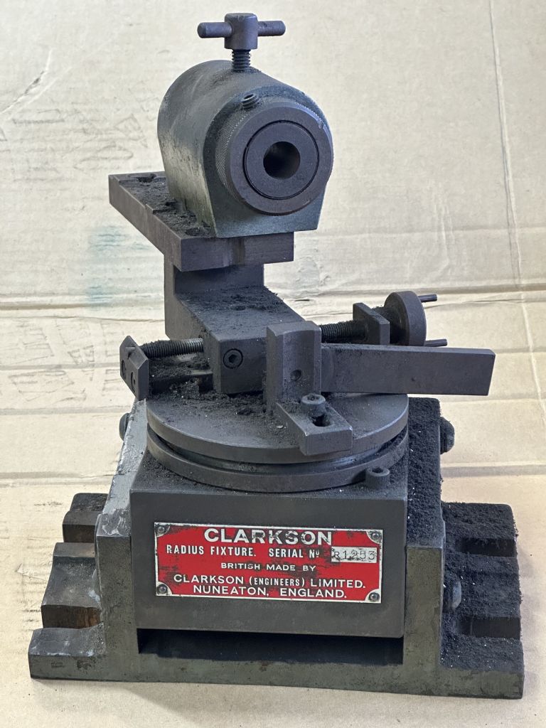

I made an enquiry with a friend and managed to purchase a radius fixture for the Clarkson for the princely sum of 2 x 24 packs of Speights
It's a bit dirty but should hopefully clean up ok with a bit of work

Do you have instructions for the radius fixture?

I believe so ! I will dig them out. Noel.

Gentlemen, The instructions I have for the radius grinder are the Mk2 which is different to the Mk1 though the basic principles are the same. It is a small booklet in printed form, and I'm not sure how one turns it into something I can send out. I will run it through the copier and and see if it will copy and convert to A5. The "bedroom workshop" is a vast collection of pictures of Clarkson gear and there is Mike Haughtons 6 part work in MEW 148 - 153 that is worth reading. As for the attachments, they often cost more than a good tooled grinder when they come up ! As for the belt a poly V run inside out will work if the original is not available.
Ian the motor is a 1/2Hp 2pole 2820rpm and since you only have the motor it may be as easy to change the motor to a single phase. Or use a static converter. The spindle speed is 4000 rpm. If you PM me I can send the machine instructions. I may have a universal head, I will look in the shed. Wheel balance is vital, I twice had a wheel come off ! ! ! Till later. Noel

I have purchased an inverter that is suitable for a 1hp 3 phase motor, it steps up the voltage from 240v to 400v so will run the motor with no problems. The cost of the inverter was NZ$100 including shipping, so most likely less than the cost of a single phase motor to convert it to single phase.
Since I don't have the cover where the switches go I will have to make one, so I measured the existing hole and by extending the opening down I can fit the inverter to the back of the cover I make and fit a start and stop switch above it then fit the cover. This will hide the inverter inside the stand and enable me to use the existing 3 phase motor or fit a .75hp in place of the 1/2 hp motor if I want to in the future.
If I did that I would add a speed control to the inverter and adjust the rpm to give 6000rpm.
The universal head is one of the things I am looking for, then I will need to make some sleeves to hold the cutters, I'm assuming the same sleeves are used for the radius fixture as well. I'm also looking for the vise and any other accessories, they aren't very common here in NZ.
I would like to convert the table to run on rollers, and possibly convert the table movement to wire rope in place of the rack. I think the rack is binding as it feels very notchy when moving the table and you feel every tooth, it makes me wonder if the rack and rack drive gear are original.
From what I gather the grinder was part of a deceased estate and dismantled at that time, the person I got it off had reassembled it but didn't have the final bits to complete the job.
I have looked at many photos of the radius grinder online and see I am missing a few bits and the bracket the spindle housing attaches to looks like it has been fabricated but it obviously works.

Nice chip out of that cup wheel. Needs replacing before use and a wheel guard would be nice. Not too sure about revving up to 6000 rpm on an overhung spindle like that - definitely check instructions first.

Ian, Your spindle has an extension on it, that unscrews, lefthand ! Whilst the Mk2 grinder was made to run to 6000 it had a different bearing set, and you will need to watch the rated speed of the wheels you use ! If you need dimensions for bits let me know. I will send a PM re the instructions. Noel

You don't need any sort of converter/inverter to run a small 3-phase grinder because there is very little starting torque required. Simply put the motor into "star" configuration and put a "run" capacitor across one of the windings, I think I used a couple out of old florescent fittings. The motor will stutter and buzz a little when the power comes on but it will run up to speed in about 1 second and then it is quite happy to run for ever more. I have been running my Clarkson and another small grinder like this for years with no problems at all. Easy and cheap way of running grinders like this.

If you can feel the rack teeth I'd suspect the slideways are worn to the extent that the table has dropped (and the rack with it). That rack looks original (the curved end). If you were in the UK I'd point you to rotogrip who sell plain cast iron angle plates cheap. I bought a 5" one and cut it up to make a universal head bracket. An ER32 collect chuck on a 32mm straight shank and a lump of cast iron to mount it in.

The ways are in excellent condition, given the machine was dismantled when the previous owner got it He can’t guarantee all the parts used to assemble it are original.
There were multiple machines dismantled, lathes, mills, grinders etc, the previous owner of the grinder had everything left to him and he had to reassemble everything. Since some parts are missing some things must have been mixed in with other things and ended up going with other machines or being left behind and disposed of.
I will strip it down and check everything and also add dials to the feeds, if I can find a set of MkII table raceways I will convert the table to bearing slideways.
please let me know where I can source the angle plate, I can’t seem to locate lumps of cast iron here in New Zealand ,I’ve been looking for a chunk 325 x 175 x 50, but can’t locate anything. Is cast iron readily available in the uk?
