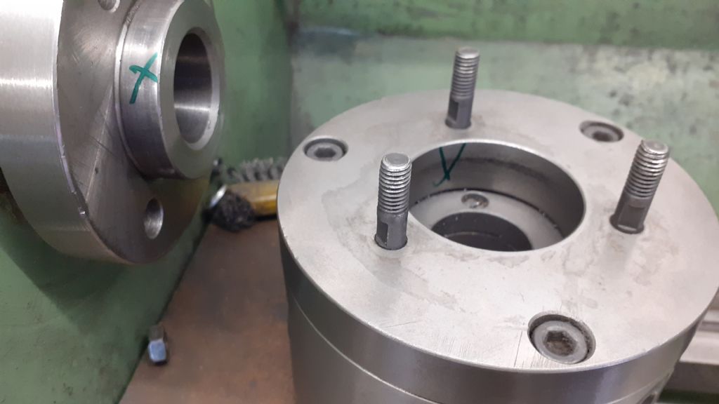

JasonB05/05/2023 18:41:19
avatar
25215 forum posts
3105 photos
1 articles
For those that don't know what they are talking about this is the spindle of my Warco WM280, the WM250 is the same
The spigot on the spindle marked with a green cross is 52mm nominal diameter. The hole in the chuck backplate also marked with a green cross is 52mm nominal diameter. On the other side of the backplate is a 95mm spigot that the chuck registers to.(125mm chuck)
The three hole sin the larger flange on the spindle are approx 9mm dia and easy clearance for the three M8studs sticking out the backplate and positioned on a 75mm PCD.
To change chucks the nuts behind the flange are undone, the backplate complete with chuck slid off and then another chuck slid on and the nuts replaced,
Worth pointing out that as supplied the backplate on my Warco 3-jaws chuck is a tighter fit than that on the 4-jaw and faceplate. This is because the fit of the 52mm diameters is what registers the chuck/backplate combination to the spindle each time it is changed. The fit is so close that the nuts need to be used to jack the chuck off and nipped up in turn to pull it back on. Originally this had to be done for the full length of the spigot but if you look closely at the hole in the backplate I have added a 1degree taper to 2/3rds it's length so only nee djack about 3mm before it is loose enough to pull off by hand.
A quick measure with the digital callipers shows my spigot spot on 52.00, the hole in the 3-jaw backplate also 52.00mm and the hole in the 4-jaw backplate 52.01mm allowing for the fact digital callipers are not exact on internal bores I would say there is maybe 0.01mm clearance but I machine the other backplates I have to fit by feel not measurement.
<>The article linked to in the previous post is about the chuck register,
<>Think of Bernards question as  machining a raw backplate casting to fit a Myford nose eg the thread and the REGISTER, or machining the taper on a D or L series or DIN backplate
Edited By JasonB on 05/05/2023 18:49:56
Bernard Start05/05/2023 18:58:57
17 forum posts
Hi Niel thank you for your interest.
The lathe is a Weiss WBL250F manufactured 11/2022
The spindle is basic 3 hole and not camloc. The spindle flange is : -
15mm thick
100mm diameter
52mm diameter register boss
8mm register boss hieght
24.5mm spindle bore
3 M8 fixing studs on 75mm PCB
All with my guessing stick
I hope you are unbaffled
