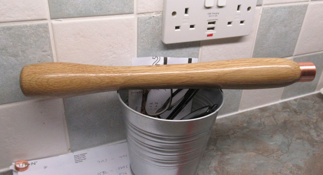

Making own Carbide Tipped woodturning chisels. I have a box of Square Tungstan Carbide square tips (german made ones) 14x14x2mm and these need to be fitted with a countersunk M6 machine screw. (or at least the hole in the centre is 6.5mm and ones fitted to the planer/thicknesser are fitted with M6
I have plenty 10mm square bright steel bar. is that just too thin to take an M6 ?

Anyways, made the handle tonight out of a bit of oak I salvaged out of a skip (old bed frame)
Hopefully get my 10mm sq bar milled drilled and tapped sometime this weekend - I'm needing a lesson for that, should be interesting.  I'm very new to turning metal and now have full access to what I believe is a decent lathe with attached mill.
