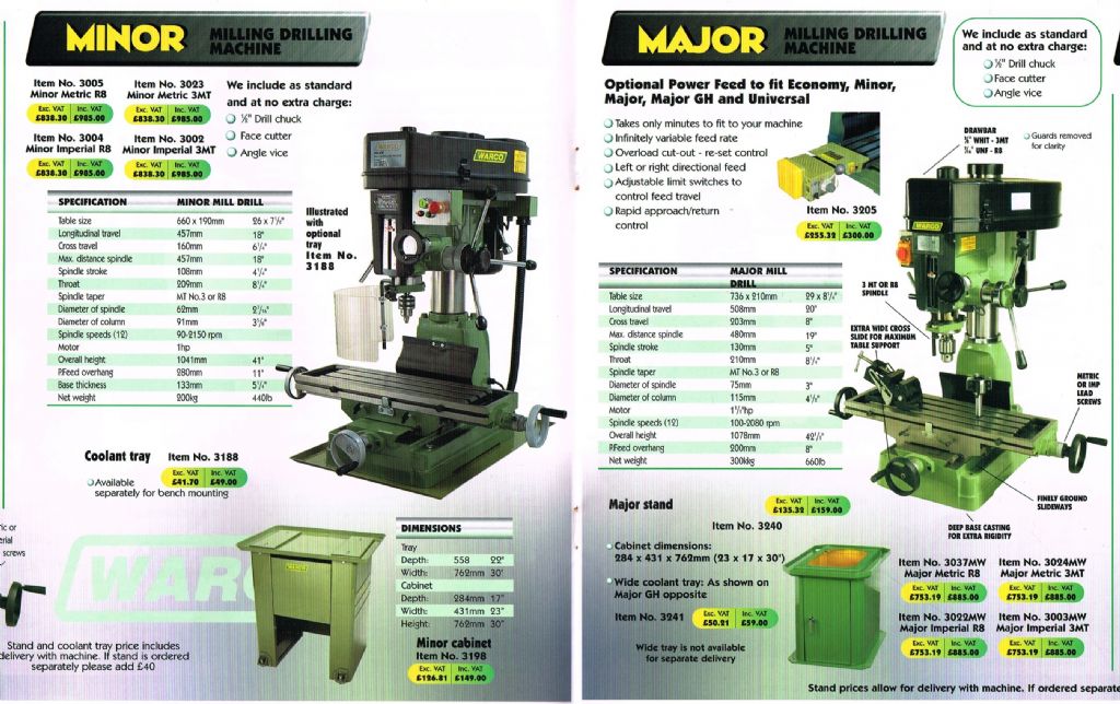

Nicholas Farr27/03/2023 23:32:04
avatar
3988 forum posts
1799 photos
Hi DiogenesII, that one is different to mine also, if you look at the scan below, it shows both the Minor and the Major from Warco's 30 year catalogue, the label on the front of the belt and pulley cover on the Minor one has Major on it, and I think this is the one that Paul has, as the electric cable entry and the column fixing is the same and the angel iron bracket under the belt and pulley cover which can be seen in Paul's photo can also just be seen in the scan on the Minor one. To be sure, the table size on Paul's machine needs to be known, but it does match the one in Old Mart's link.
Regards Nick.

Dave Halford28/03/2023 11:33:31
2536 forum posts
24 photos
That explains why Pauls doesn't match the info from Warco.
So can we now assume that the missing clamp bolts may be why the tram is off and why he's somewhat unhappy?
paul mcquaid28/03/2023 11:49:37
34 forum posts
12 photos
Hi.
Table size is 736 x 210 which is the mill drill on the left even though it says Minor.
Mine looks exactly like this major even the X and Y handle bosses are the same Green colour the new ones seem to be yellow. But mine is a central Nut not two bolts.
I have been communicating with Paul about this and have sent some more photo's hopefully he will put them on, As I have been finding it quite difficult..
I have found a youtube link from Forme Industrious restoring a 1984 mode RF30 which also has this single bolt arrangement.
