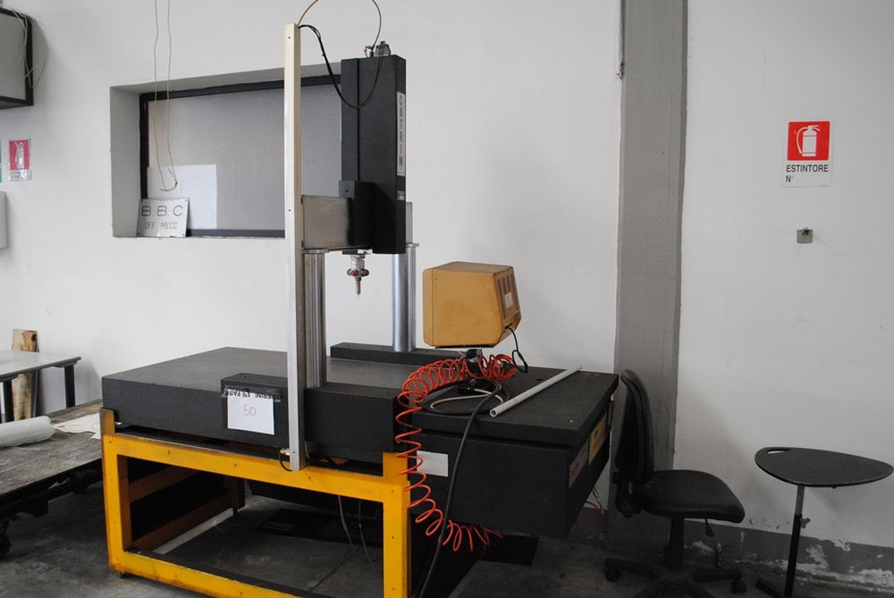

I spotted this surface table in Bedford on a old industrial site. The surface table has a series of drilled countersunk holes, any idea what the table was used for.

Base of a Measuring Station maybe, with all the goodies removed. Something like this:

Looks like the base / table from a co-ordinate measuring machine (CMM)
The two rows of close pitch smaller holes on the LHS look like where a gantry guide rail would be attached. & the wider spaced pattern would be used to clamp the component to be measured - either directly with clamps or to attach fixtures.
In the picture above of a similar CMM to the model we had at my last employment, the guide rail on the LHS is covered, but the pattern of component clamping threaded holes can just be made out.

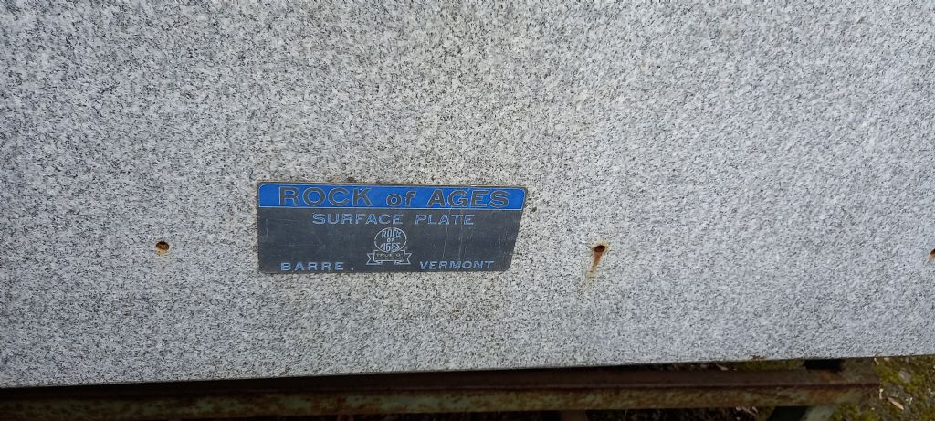

Michael Gilligan20/03/2023 11:52:08
avatar
23121 forum posts
1360 photos
**LINK**
https://en.wikipedia.org/wiki/Rock_of_Ages_Corporation
