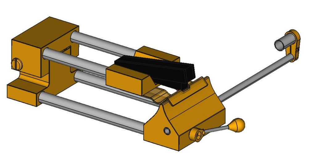

Based on a simular one seen in my fathers printing workshop (made of cast iron) have I intented to make one for my daughter. She like to make and drawing in small booklets. It is made from part from an on the shelf stampler, aluminium tubes, some 3D printed parts and a stick of wood.
It is cabable of stapl booklets made of paper sheets up to the size of A3
The outcome ended up looking as seen below:

Looks good, no need to redesign something that works when you can just use different materials and modern manufacturing methods.
I have never had enough need for something like this so I use the felt method. Place the sheets down on a thick enough layer of strong felt, open the stapler out and use it to put the staples through the fold and into the felt. This does not fold the ends over so you just do that part by hand with a steel rule. Some carpet types also work instead of felt. Not good enough for professional results but fine for the odd personal job.

Being made to work with the booklet flat they won't work well as the professional cast iron one Soee copied or as well as his lighter duty version.
It's rather harder to get things properly aligned for folding when stapled flat. Pre-folded sheets laid on a Vee are easier to align. Pre folding is essential if thicker booklets are to work well. 10 sheets are about as many as can easily be assembled on the flat and folded after stapling. 15 is possible but likely to need practice. I'm told more can be done neatly by the seriously skilled. I managed 15 when I had access to a long reach one but it all came out a bit messy.

I can see the advantage of the one above with the "V" guides, as like Clive says, it can be tricky to get the staples in the correct place, but mine does have an adjustable back-stop to help.
