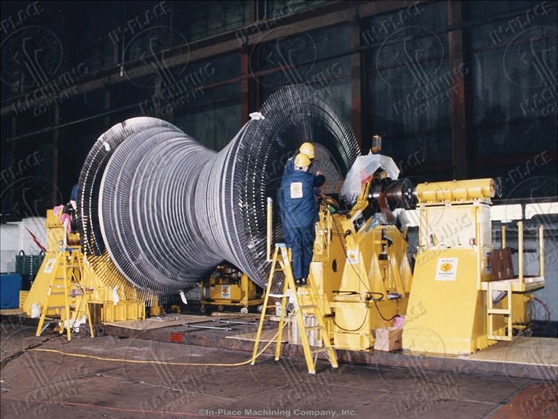

Onsite machining is a big thing these days. And on big jobs with long straight welds, they have a similar looking machine that crawls along a pre-laid track and does the welding, no human hands involved! A perfect weld every time. It is how they weld submarine and ship hulls together these days.
Mining and marine industries use a lot of line-boring machines that are similarly portable and set up on the job. Quite intriguing to see a flimsy looking boring bar set up and running through a series of very large holes, but of course it is usually only taking out a few thou to correct ovality or to fit an oversized shaft or bush etc. And they even have portable lathes now that will machine a power station steam turbine rotor right there on the powerstation floor instead of trucking a 100-ton rotor across the country to a specialist machine shop. Pretty amazing stuff.
First time I have seen a mobile milling machine though. Yes, much tidier and quicker than angle grinding by hand.
