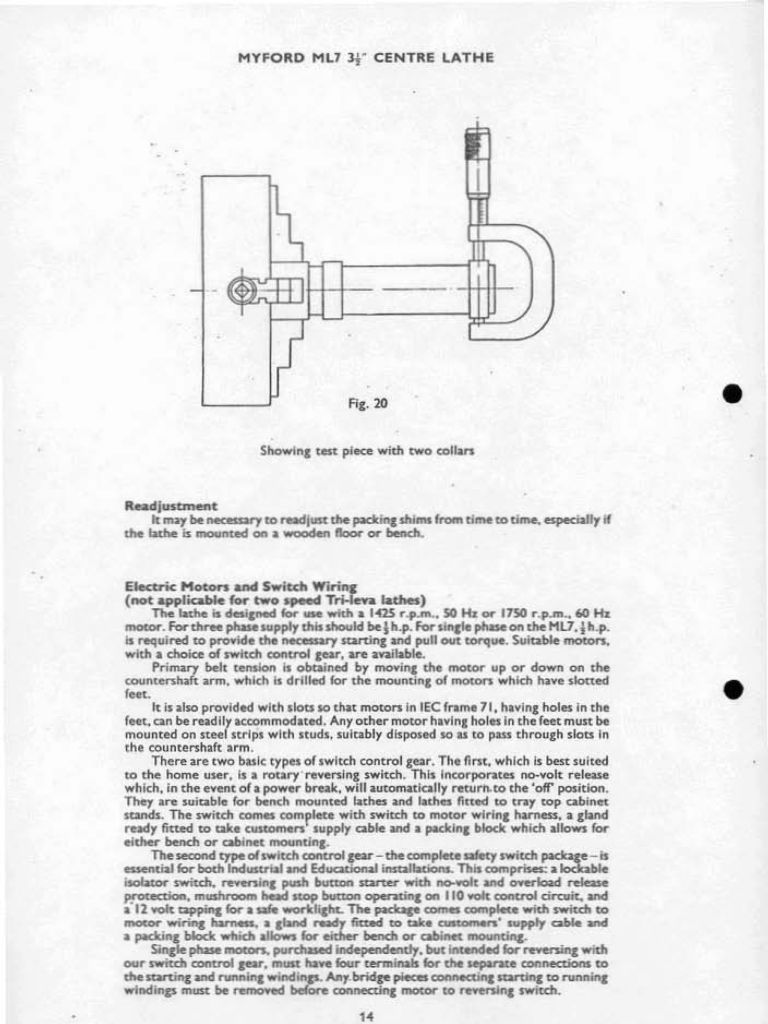

Now, if you want to set your lathe up to turn parallel (without a tailstock centre), do what we all do when all else fails: read the instructions. The Myford ML7 Users Manual gives a thorough run through on how to shim or adjust the lathe bed to bench mounting points to twist the bed slightly to make it turn parallel. You don't need to use a fancy level, and especially not a fancy test bar. It is done by taking test cuts over a piece of 1" diameter x 4" long steel bar and measuring the diameter at each end. You then shim or adjust the lathe bed feet at the tailstock end to make it turn parallel. Simple as anything. The ML7 User Manual is widely available for free download on the internet. It has all you need to know about aligning your headstock spindle to the bed.
On your million-year-old lathe, the internal Morse taper in the headstock spindle is almost certainly scarred up, butchered, abused or othewise out of whack enough to make it run out of true. And the spindle can even have developed a slight bend over the countless eons since is left Beeston. Mounting a fancy test bar in there tells you nothing, as you have found out.
Re your bed measurements, you are on the right track there, if you lathe is a pre-1972 narrow guide model that uses both vertical sides of the front way to guide the carriage. One thou of wear is very good. Three thou is Myford's recommended limit before regrinding. The thickness of that front way measured vertically is allowed a couple of thou more as it is less critical.
BUT, if your ML7 is post-1972 or has been converted to wide-guide configuration, it uses the front of the front way and the rear of the rear way, so you need a 4" micrometer to measure that overall distance to get a true reading of wear.
I thought I had a pic of that manual page on alignment to post but don't seem to be able to find it. But you can fiund the manual all over the net.EG the Myford lathes group on groups.io in the Files section.
Hopper06/10/2022 11:51:24
avatar
7881 forum posts
397 photos
Here is what the User Manual says on setting up your Myford to turn parallel. That's all you need to do.
