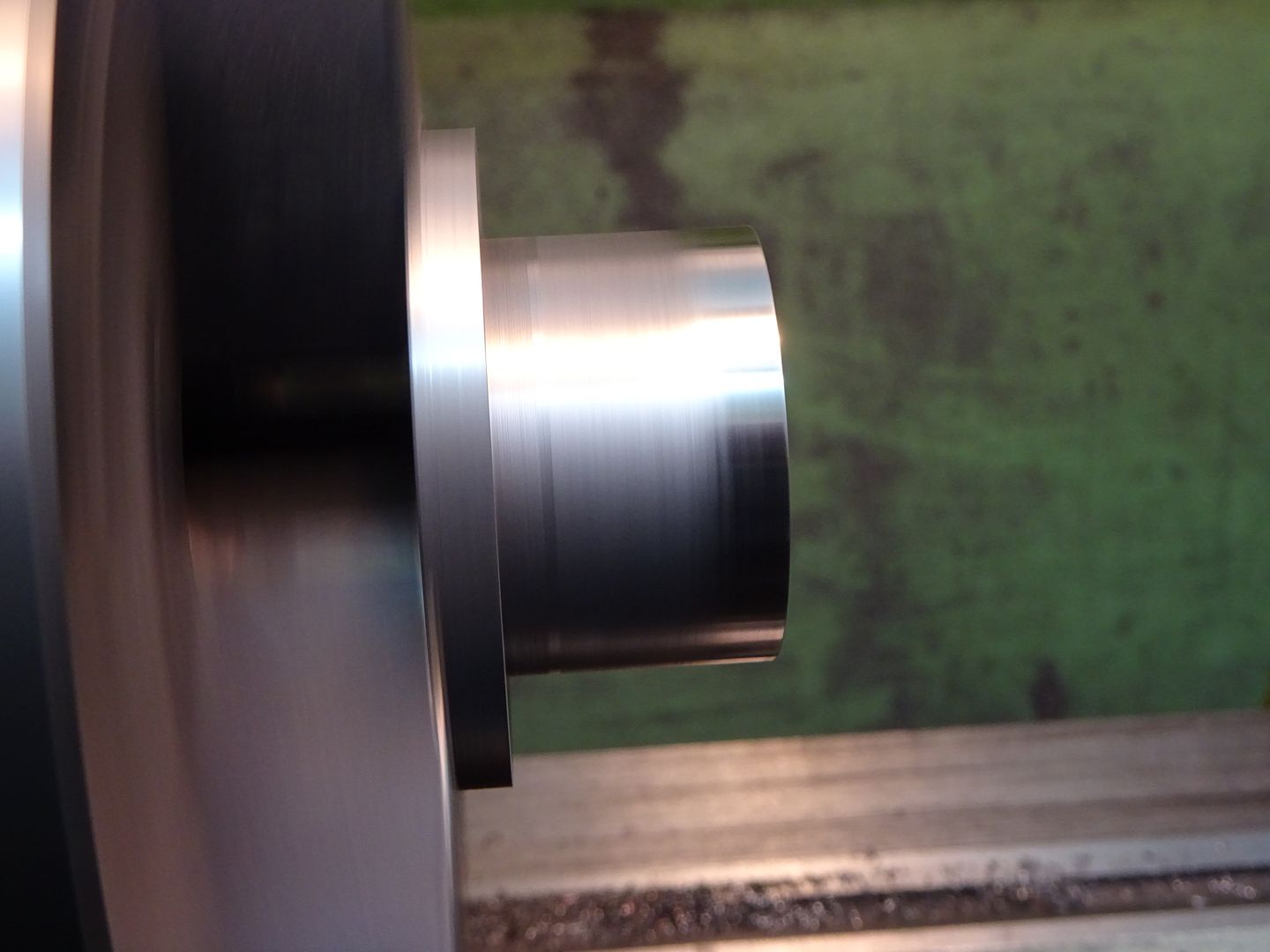

That could well be it, you can often see the harder areas after machining with carbide as they have a much brighter look to them more like steel as can be seen in this picture where the thin edge of the piston has cooled quickly and chilled the iron casting.

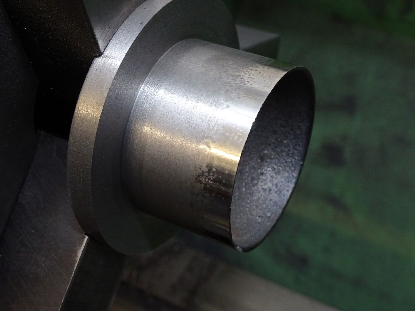

John Gray 723/07/2022 16:16:11
12 forum posts
Thank you JasonB, that is exactly the look my casting has. The surface is best described as “mottled”, in appearance , although the surface is flat. All surfaces of this casting were machined prior to this part of the task so there was not any scale remaining. Even the gland part was drilled and tapped with HSS without any drama, and also the 70 thou hole at the back that I had anticipated would be a problem, but in the event was not. Interestingly these of course were drilled at 90 deg to the problem surfaces. Don’t know if this is significant or not. I was struggling to understand why the iron was hard after it had been heated. Perhaps the answer is that it was hard before heating it! I shall talk to Stuart’s next week and have another go. Thank you again.

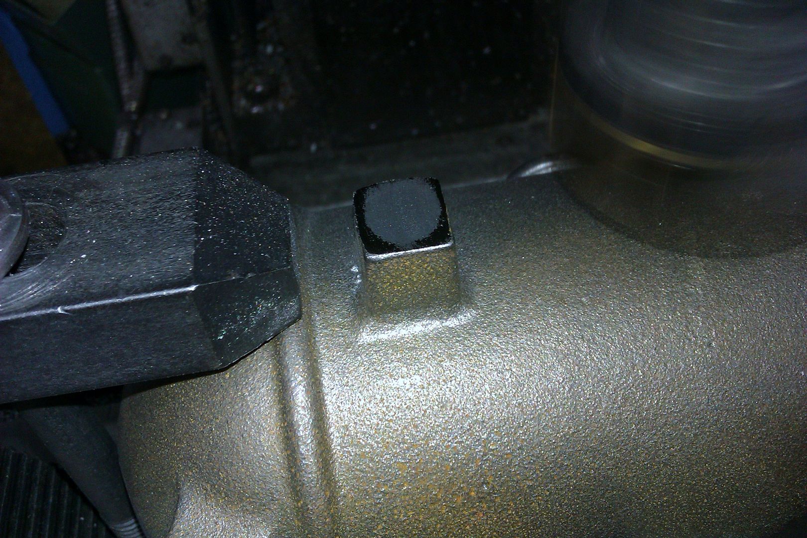

Yes I saw that comment too but the usual way the chill pattern shows on a casting like that is around the corners, the areas with greater volume tend to hold the heat long enough not to chill. So that could well explain why the gland and guide holes went OK but the stud holes at the corners gave problems
As the cover and chest were bonded together the drill would have had to go through the cover first which being much thinner than the chest was the most likely to be hard (and not previously drilled) which would have taken the edge off the drill which then failed to complete the hole in the chest. The covers are known to be the most troublesome for being hard, less so the chests due to being so thin there is no hard skin as the chill will go right through.
Typical chilled corners on this part
