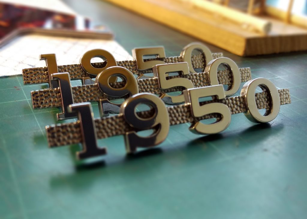

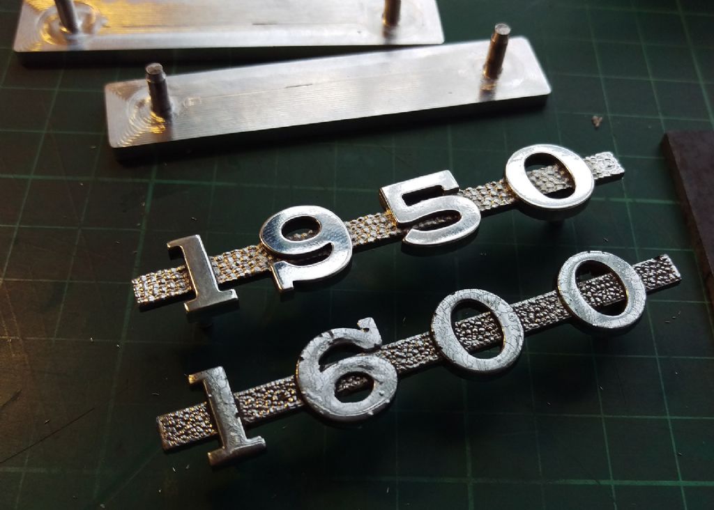

Hello all,

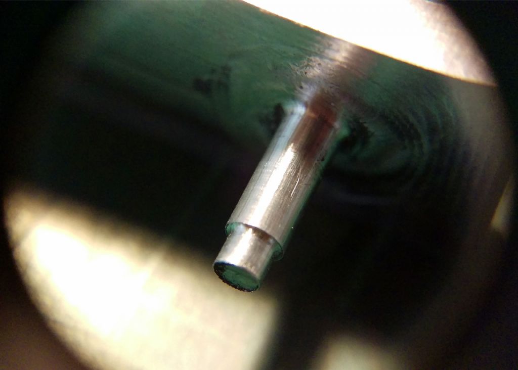

I recently made a new set of badges for a customer who had had his MGA converted from a 1600 to a 1950. The brief was to adhere to the existing style, and to keep the dimensions similar (especially for the mounting spigots). I made the badges in a decent (ie. non-bendy) grade of aluminium, CAD/CAM in F360 and then hand finished.
Just posting here in case it's of interest or useful to anyone looking for something similar (if that's permissible).
Wal.

Very nice. How did you do the texturing on the bar?
Cheers,
Rod

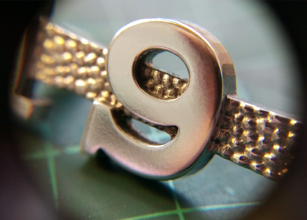

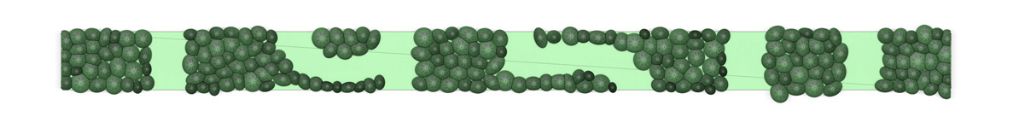

Posted by Roderick Jenkins on 11/05/2022 15:16:01:
Cheers,
Rod
Rod, I modelled it in 3D. There was scope to use a procedural texture, but it proved a bit of a nightmare to control - I automated a lot of the shape creation, but ended up doing a fair bit of the placement manually, which is quite laughable - but needs must (when you're an idiot and don't know the 'proper' way...)
