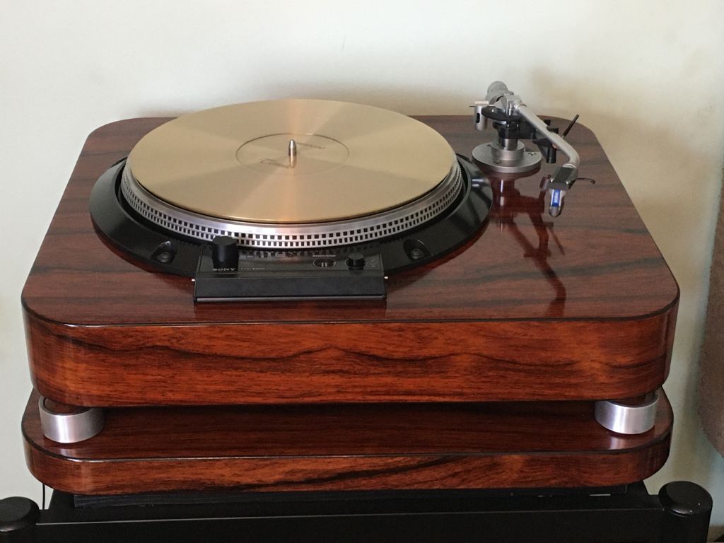

jamie creighton 102/05/2022 14:34:36
25 forum posts
2 photos
bringing an old classic turntable up to date,rare, exotic and top end japanese direct drive, still good by todays standards.. it uses oilites as standard,id like to try and better the tolerances. i have spares so no harm will come to it while i practise. the end goal will be to substitute the oilites for bearing grade torlon.
the plinth i made myself,its panzerholz veneered in cocobolo.

Anthony Knights02/05/2022 16:59:01
681 forum posts
260 photos
Looks beautiful.
Hopper02/05/2022 22:05:07
avatar
7881 forum posts
397 photos
Yes beautiful indeed.
One aspect you might consider is that while it might be possible to better Oilite tolerances in a custom made bushing, in use the Oilite would more likely wear better and stay within its tolerance due to the self-lubricating nature of the oil-soaked sintered bronze material.
Graham Meek03/05/2022 09:55:27
714 forum posts
414 photos
Hi Jamie,
That is a lovely piece of work, you should be justly proud of that.
Using an H7 reamer will give you the same size hole as the Oilite bush. These are normally supplied to give an H7 bore when they are pressed into a hole which is itself H7.
Hopper has the best option and it is something I have done in the past. That being to machine a custom Oilite bush. Billets of solid Oilite used to be available and this would give a better self lubricating bearing solution.
Torlon in my experience takes on moisture so you might have problems with this material. Especially if it is machined in a humid atmosphere and then lives in a relatively dry environment.
