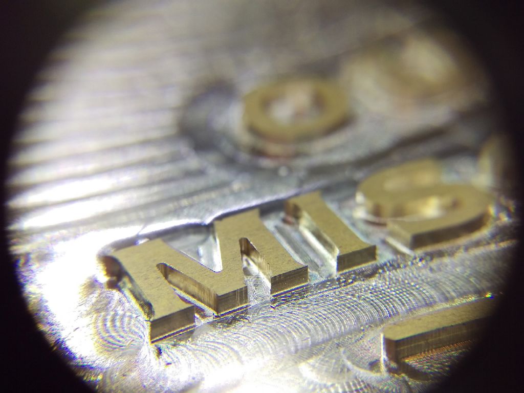

Hello all.
I was recently trying to get hold of some LG2 (or Colphos 90) but in plate form. It soon became clear that these materials are more widely available in hex or bar and that I'd find it nigh on impossible to buy as plate.
My question is, if I absolutely needed LG2 in plate, how feasible would it be to get a foundry to melt a bunch of ingots and re-cast 'em into plate? Would it dramatically change the free-cutting/weather-resistant properties? Would it end up looking like the inside of an Aero bar?
This is just an idle question from someone who doesn't know all that much - I'll likely go with Naval Brass (CZ112) - not as aesthetically pleasing, but available in plate and meets the hard wearing / good in a marine environment requirements. Not as free cutting, but should be OK - there are a lot of letterforms which will need to be machined using end-mills down to 0.5mm, as in the pic.
Many thanks for your advice, excogitation etc.
Wal.

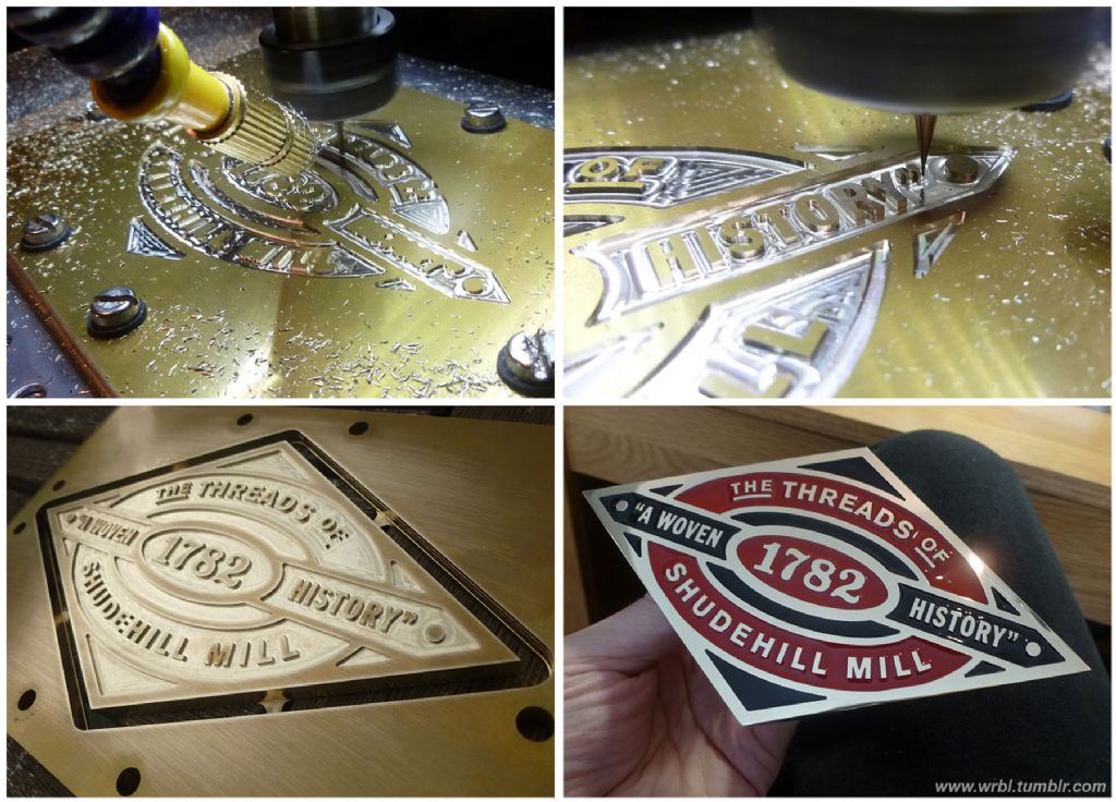

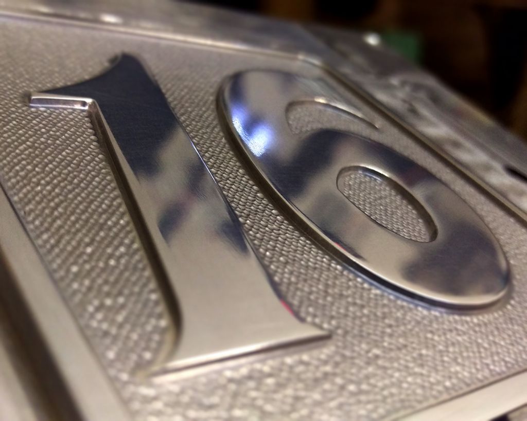

Thank you fellas,
Yes, of course - that's the straightforward approach, just make the pattern and get it cast. So the next part of my question is how much detail can I expect to lose? As mentioned, I know bugger all about casting and what can be done nowadays. Some of the letterforms get quite small (5-6mm in height, occasionally with serifs) and my customer would be after a specific background 'texture' which may or may not be problematic - I'll post a couple of example pics of bits and pieces I've done for him below.
But of course - if bronze is absolutely what's required then casting it is the way to go, I think that in his mind's eye my customer is seeing a rougher, pitted finish and a greater loss of detail than he'd perhaps want - CNC machining it takes away some of those perils of casting.
Paving Inlay Process

Noel would be better places to say for sure but I would say you will loose some fine detail with sand casting particularly your textured backgrounds, if the part were smaller than investment casting would be a possible option.
You would also need to machine some draft angle onto the sides if the letters which either means a 3D toolpath with many fine step downs or using the edge of a tapered engraving tool with single flute, both options considerably add to machine time.

pictures8 099.jpgpictures8 098.jpgA woven background as in old AA badges is copied - every thread ! A showmans loco 3"long in relief, even the lettering round the canopy can be read - if your eyes are good enough. Using mansfield sand you will loose almost nothing BUT it will look cast. Check out any shot of the Fred Dibnahs MADE IN BRITAIN . Look closely and you will see 2 tiny dot marks for drilling, cast in ! Foundry lettering has a good draft as part of it's design. There are 3 standard fonts, flat face serif, 1/2" up, Flat face 1/4" to 4" and sharp face 1/8" up. The bevel gear illustrates the detail that can be achieved ! The 2nd image show the edges rounded due to polishing. Noel
