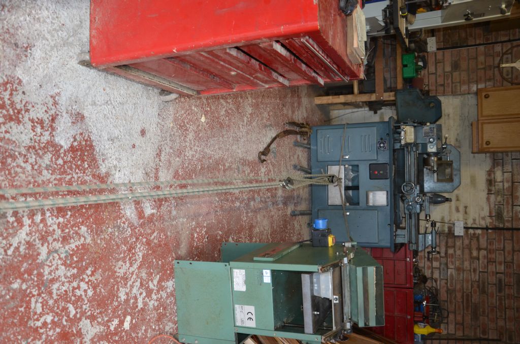

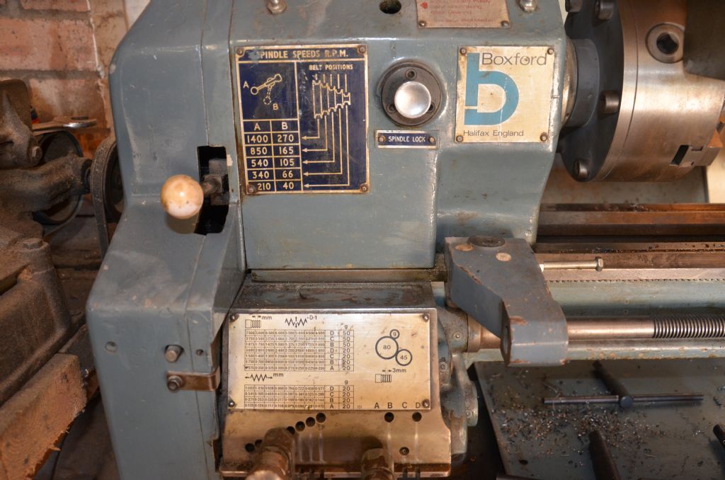

dsc_2133.jpgCould anyone please tell me what model lathe I have just bought, the only number I can find is HEH5656-1-4 and I have looked on the net and my number is nowhere to be found?
Also the lathe wont traverse automatically both in cross slide and in thread mode I have tried ever thing with the levers but I can only use it by hand traverse left to right the clutch wheel only moves slightly to right and left, Before I strip the apron down I just wondered if I was doing it wrong as I am a complete novice. Thank You for any help.dsc_2134.jpg

That's a Model A, looks nice. There should be a serial number on the right hand end of the bed where the tailstock is sitting in the photo. Have a look at lathes.co.uk for Boxford information, there is also a Boxford group on Facebook with lots of scanned documents and knowledge.

hi it’s an AUD , motor in the base. i have one very similar.

It is an AUD. Tat is an Under Drive model A.

Does the leadscrew go round when you rotate the chuck? That's the long rod that goes all the way along the front. If not as Vngvar says have you tried the lever to the very left of the lathe. You need to move the machine so you can open the left cover and see what is going on under it.

Move the white knobbed lever up or down, this is forward or reverse for the leadscrew. Looks like it is in neutral.

looks to me to be an ex schools lathe. At the left hand end of the lathe is a cover which has been locked shut to keep kids fingers out of the way. Remove the small bracket held by an Allen screw and open the cover. I think that you will find that the gear drive has been disconnected.
Most covers/doors on the lathe have microswitches on them. When opened, the power to the lathe will be cut off and you will need to shut the door and re-start the lathe. (May also shut off when you select / change the top lever which engages back gear for slow revs) Ps back gear may be blocked off with an Allen screw - typical schools modification!

It's a single phase as you can see by the double socket I fitted to the wall and I am only a novice where the Boxford is concerned, Enginerr and electrical wise well let's say I am OK, I have made some bushes and used the Boxford milling attachment that came with it already. Thanks for your input anyway.Today I am going to pull the lathe out and open the door on the left as I thik like you all say it's in there, I managed to slide the lathe in alone but I think my son will help pull it out as I'm 87. Thanks again for ALL your very kind replys

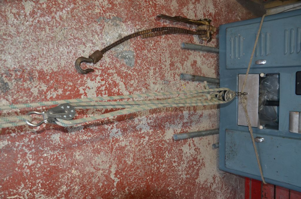

pullcarWhoopee all done and dusted, managed to pull lathe out alone, opened the door and it was obvious what was wrong. working perfect now Thanks everone. You are right Bob.tow
