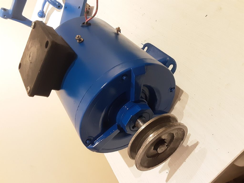

Mark H22/03/2021 07:59:34
16 forum posts
3 photos
The motor fitted looks very much like this:
Motor
The wiring is 4 wires coming from the top, only 2 were connected to the main plug so that must be the run circuit, the other 2 wires, i assume would be direction..
Once i source a cap, im i right in thinking, i will need to wire in the spare 2 wires for the direction?
There is 2 wires for the missing capacitor, ive got the cap cover.
When plugged in the motor hummed but you had to spin the pulley (in either direction) to get the lathe to turn, the guy has been using it for years like that but i dont fancy it !!

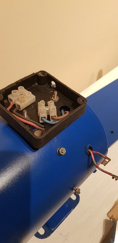

No markings on the terminal plate, the 4 wires just come out of the motor body into the plastic housing, i'll get a pic up as it will make more sense...
Mark H22/03/2021 19:29:18
16 forum posts
3 photos
Hopefully a pic of the motor...
Edited By Mark H on 22/03/2021 19:43:06
Mark H22/03/2021 19:47:17
16 forum posts
3 photos
The red and black wires were connected to the mains plug, the blue/brown wasn't connected at all
Edited By Mark H on 22/03/2021 19:49:05
noel shelley22/03/2021 21:47:08
2308 forum posts
33 photos
black and red are the correct colours for the run windings ! Blue and yellow were the normal colours for the start. In your case blue and brown. One has to assume that there is internal wiring for the centrifugal switch ! Therefore capacitor to the two spade connectors on the side - do you have the proper cover for the capacitor as the terminals will be at mains potential 240Volt. Live and neutral to red / black and blue / brown. If the direction of rotation is wrong then swap blue and brown. Good luck, Noel

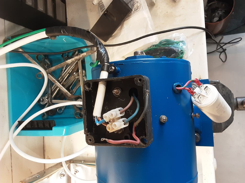

Mark H27/03/2021 15:25:43
16 forum posts
3 photos
Well, this is confusing me, red/black connected, motor runs but anti clock, needs to be clockwise.
Brown/blue, I can connect to br/red and blue/black and runs anti, if I swop them, the rd trips..
If I just use red/black but swop them, motor runs anti, I can connect blue/Brown to mains and still runs anti.
Without cap I can get it to run clock if I spin the pulley, with cap connected..anti
No wire combo with cap fitted seems to get the motor to run clock only anti..
Wonder if something is knackered in the motor ??
Mark H27/03/2021 15:26:33
16 forum posts
3 photos
I'm wondering because its a old motor, it only runs in one direction, thats why the cap had been removed so you could manually spin the motor clockwise to start it.....
