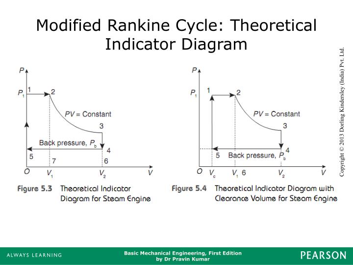

I've been programming my own Walschaerts mechanism simulator and want to add a simplified indicator diagram, but I lack practice in thermodynamics. I will outline my approach to the expansion phase below and hope for comments to confirm that I am on the right track, or to set me right. Steam properties are based on algorithms from **LINK**
a - My expansion phase starts with a given volume of saturated steam at a known pressure (typically 6 bar for models), no superheating, yet.
b - I assume the expansion phase follows the saturation line and get the associated initial temperature, and, subsequently, the temperature for each pressure that I consider.
c - Further, the heat loss by conduction is relatively small, the steam is mainly doing work driving the piston down the cylinder, so it's not unreasonable to assume this part of the cycle is adiabatic, reversible and, hence, an isentropic process.
d - I get the initial specific volume from the steam properties and can determine the initial mass of steam in the cylinder.
e - I assume the pressure decreases by small steps and consider one step at a time until the piston reaches the release point.
f - At each pressure step, I get the steam and water properties and deduce the quality (steam fraction) from the assumption of constant entropy together with the specific entropies of gas and liquid phases.
g - The volume of steam and water then follows from the specific volumes of the two phases, the quality and the total mass; this tells me how far the piston has got by this step.
h - That's basically it. I can add more details and results if needed.
i - The next interesting bit is the compression phase - it's fairly reasonable to assume a little above atmospheric pressure at the end of the exhaust phase, just as compression starts, but I wonder what else to assume to define the initial state of the compression phase.

I think that people are reluctant to comment on your assumptions because the expansion of steam in actual steam engines is very complicated. This Indicator LinK compares the actual indicator diagram from tests with theoretical values for saturated and superheated steam. You may find this study helpful for making assumptions.

Point e - It does, hyberbolically in theory between cut-off and exhaust opening, but wet steam is not a theoretically perfect gas.
Engineering in the first half of the last Century produced many books on heat-engine principles obtained from a blend of experiments with actual machines and pure physics. If you've not already done this, it may be worth searching one out, as they covered steam reciprocating as well as turbine and i.c. engines .

As you are ignoring condensation, re-evaporation and wire drawing, I would just have taken an expansion index of 1 (ie PV = const), which is how the engine builders of old worked out the likely power output of their engines. I've done this in excel many moons ago, if you want a copy let me know. The late Bill Hall went one better and worked out the pressure drop in the ports. It gives remarkably good results compared against full size indicator diagrams from Rugby test house. Unfortunately he wrapped it all up with boiler performance calculations, and these subsequently turned out to be less accurate. I independently repeated his port pressure drop sums and got much the same results. Some hairy maths involved, I doubt I could do it now, very rusty. If I can find it can send you a copy if you like. You can download Bill's programs and the theory behind it from 5AT, scroll right down to the bottom of the page. Some clever person might be able to disentangle the engine bit from the boiler bit, I think I have the code stashed away. If you want to include superheat just change the expansion index.

Thank you, Turbine Guy, for the link to Hall's paper on Measuring Steam Engine Performance - his analysis of initial condensation and re-evaporation is interesting and far beyond what I hope to include in a simplified indicator diagram, based only on basic theory.
Yes, Nigel Graham, I should probably have made more effort to find the right books, I have mainly used a textbook, "Thermodynamics" by G.J. Van Wylen from 1959, which doesn't cover reciprocating steam engines. My other model steam and locomotive books lack thermodynamic theory. Since I am using algorithms for steam properties, I don't need to assume a hyperbolic curve, and can take account of condensation during the expansion phase. I tried to paste in a sample result, which looks somewhat hyperbolic, starts from cut-off with saturated steam at 0.6 MPa and ends up with 1.3% condensation at release, but failed to paste in this graph with the available tools.
I am hoping someone will reply to this post and confirm that I am using a reasonable approach or tell me where I am going wrong. I suppose another possibility is to say that a simplified indicator diagram is a complete waste of effort, because a real, experimental indicator diagram would be so very different. I am hoping that it will be useful by adding a little more information about the effects of the valve events from the simulation.
Well, what you're doing is a couple of notches above my pay-grade, but it seems reasonable to me!
I did wonder what the practical value of an artificial indicator diagram was because, as you say, a real one would be different. A real indicator diagram reveals faults directly, whilst comparing real diagrams with theoretical perfection suggests where the design needs attention. I'm not sure the effort of artificiallirecreating the curve is worth it when the ideal is already defined: the Rankine Cycle covers steam engines:
If the purpose is to study valve events, perhaps a Reuleaux Diagram would be more useful?

Quickly looking at your initial comments you appear to have a good grasp of the subject/problem. At this point, before going on to valve gear which is complex to say the least, I would get a steam chart, or set of steam tables, and a good thermodynamics text book that includes steam. From being an apprentice to retirement the go to book was Rogers & Mayhew, the title was something like "Engineering Thermodynamics". I looked at Amazon last night and they had two second hand copies for about £50 each, ouch. Your county library should have one or the local model engineering club may even do so. Failing that put the word round, a retired engineer could have a copy, have a chat with the local charity shops etc (Charity shops know the value of books. I believe they are sorted at local depots and high value items set aside. All second hand text books from ancient greek grammar to boundary layer theory are worth money), you may be lucky. Do you have a knowledge of calculus? Your comments suggest you may have. If not, also get a A Level maths book, calculus is not difficult.

Realeaux diagrams only work for pure sinusoidal valve motion. A good Walschearts or Stephenson will get near, but not quite there. I've never got on with them, but then I'm biased towards sums

No, I would not dismiss the theoretical indicator-diagram outright. It will not match reality, but act as a guide to designing the engine and subsequent testing, and I think were used as such industrially.

Thank you all for helpful replies and comments to my post. So far, no one has actually said my approach to the expansion phase is unreasonable, I have received some support, and, of course, it is simplified and does not accurately represent real life. So, here are a few results, starting from saturated steam at 0.6 MPa, with 5% clearance volume and release at 95% of the piston stroke:
cut-off
Release
temp. (C)
Release
press. (MPa)
Release
quality
80 151.7 0.498 0.987
70 146.2 0.430 0.978
60 140.4 0.366 0.968
40 126.1 0.240 0.944
20 105.3 0.122 0.910
One advantage of this approach is that it provides direct results for the quality or steam fraction; e.g. 5.6% weight of condensed liquid at release for 40% cut-off. Nor do I need to assume an expansion index of 1 (for PV= constant); in fact, I can find an expansion index of about 1.14 by curve fitting to the results. The hard work behind this is taking the algorithms for steam properties (steam tables) from the Int. Assoc. for the Properties of Water and Steam "Revised Release on the IAPWS Industrial Formulation 1997 for the Thermodynamic Properties of Water and Steam" and putting them into computer code. There are hundreds of numbers that define the functions they have fitted to empirical steam data. Afterwards, it's a doddle; no more table look-ups and interpolation, just subroutine calls. I'd be happy to pass on my Fortran routines for the steam properties if anyone is interested; they only cover the region relevant to live steam, not the full region in the document.

In an engine using saturated steam you don't get adiabatic expansion, there is initial condensation followed later in the stroke by re-evaporation, so steam table values are going to be inaccurate. That's why I suggested that PV=const would be a lot simpler and probably just as accurate (or inaccurate).
With a single piston valve or slide valve, as you change the cut off you change the release and compression.
