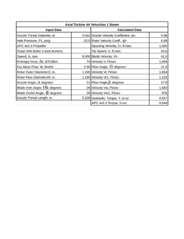

23/09/2023 16:22:47
I have done very little testing of Axial Turbine 4A on steam, so I ran a test yesterday on steam using my Stuart 504 boiler. I used the APC 4x3.3 propeller since it is the smallest propeller I have that is not overpowered by this boiler. I added the results of this test to the test sheet shown in the 26/05/2021 Post. I stated in that post that the torque shown for the other turbines appeared to be too high. The test with Axial Turbine 4A found a torque even larger than these turbines by an amount that appears to be consistent with the higher efficiency of this turbine and indicates the torques shown in this table appear to be correct. I made the Velocity 1 spreadsheet for Axial Turbine 4A running on steam shown below. The mach number, pressure drop due to friction in the nozzle, and clearance were lower with steam than with air so I recalculated the nozzle velocity coefficient. I estimated the nozzle velocity coefficient of Axial Turbine 4A to be approximately 0.88. This velocity coefficient was determined by starting with the velocity coefficient of 0.93 for the conical nozzle as explained in the 29/03/2023 Post then finding the reduction for the pressure drop due to friction. The reduction due to pressure drop was 0.98. This reduced the nozzle velocity coefficient to 0.91. I then found the reduction for expanding to supersonic velocities with a converging only nozzle shown in the diagram in the 29/03/2023 post as line A. The Mach number for Axial Turbine 4A was 1.3 and the reduction for expanding supersonic is approximately 0.98. This reduces the nozzle velocity coefficient to 0.89. The last reduction was for the distance between the nozzle outlet to the rotor. This was 0.010” for Axial Turbine 4A and the correction is 0.99 for this distance. This reduces the nozzle velocity coefficient to 0.88. I kept the same rotor velocity coefficient used for Axial Turbine 4A in all the other velocity spreadsheets and once again the estimated torque was quite close to the actual test torque.

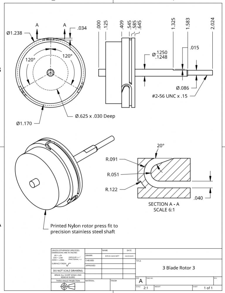

10/06/2023 17:38:13
I had a few problems making 3 Blade Rotor 3 and 3 Blade Turbine 3 shown on the drawings in the last post. When I machined the OD of the rotor, the cutting tool that was very sharp did not scrape all the nylon off but caused some of the material to wipe over the edges of the channels. When I tried to clean up the edges with a razor some of the wiped over material still would slide under the razor. The first photo given below shows an example of the best I could get the edges. The second photo shown below is a picture of a 5 blade rotor used in one of the reports I read discussing this type of turbine. You can see in the second photo how sharp and smooth the surfaces of the channel need to be to get the maximum performance. I will describe another problem found in the next post.

10/06/2023 16:28:19
I decided to give the drawings shown in the 26/05/2023 post new names since changing the rotor from printed aluminum to printed nylon was more of a change in rotor than a revision. The following drawings show the new names and the dimensions shown are the actual dimensions and position of the rotor in the housing after all the machining. I had to make several compromises in making this turbine that will be explained in the next posts.
