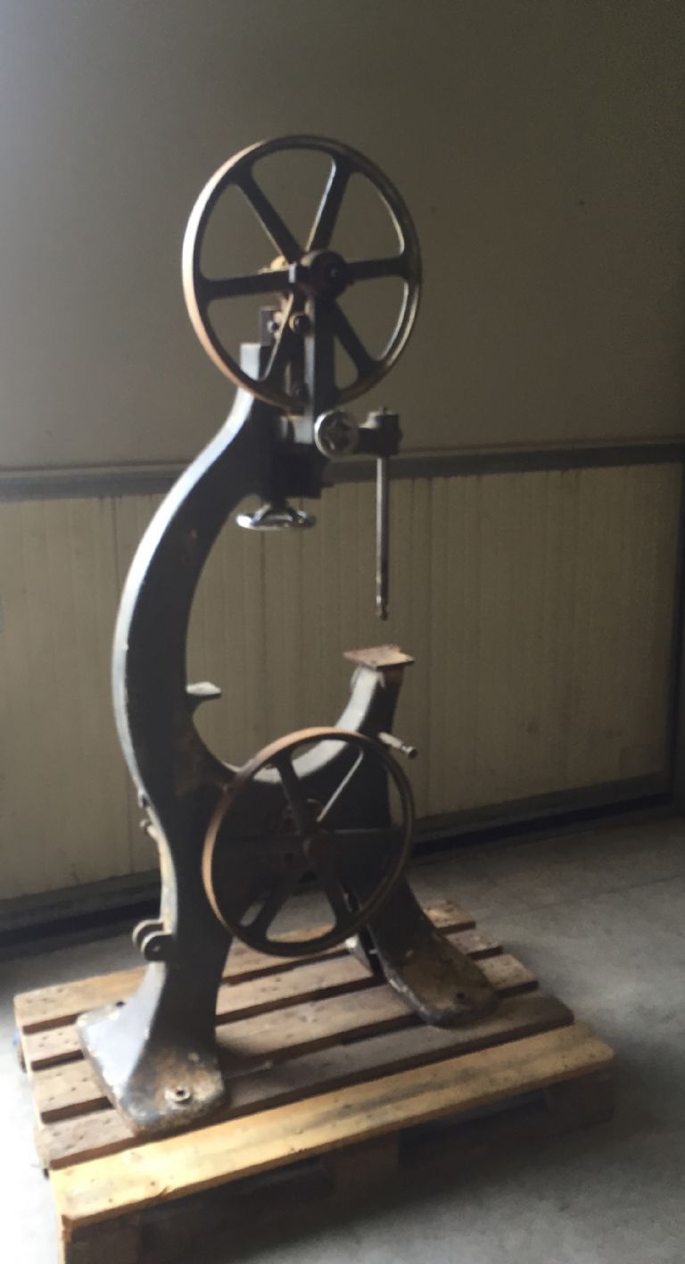

pgrbff30/01/2021 16:46:37
261 forum posts
31 photos
I'm guessing at the mid century.

SillyOldDuffer30/01/2021 17:03:25
10668 forum posts
2415 photos
Posted by pgrbff on 30/01/2021 16:46:37:
Having seen the photo, which century?
smiley
That's a classic Victorian design. They might still be making them!

Posted by SillyOldDuffer on 30/01/2021 17:03:25:
smiley
Did they have 3 phase motors back then?
