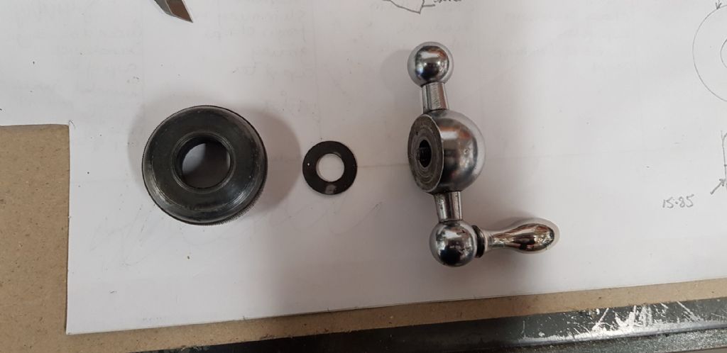

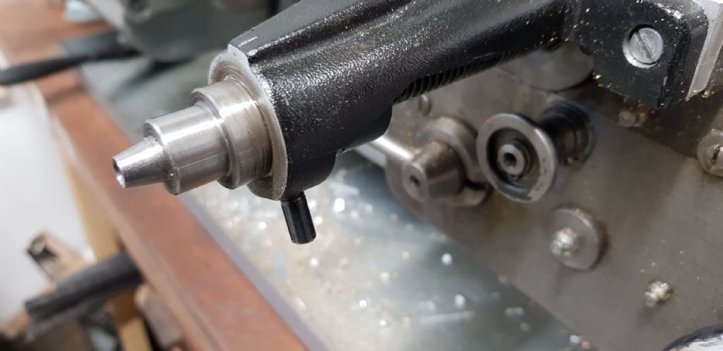

Steviegtr26/01/2021 16:17:13
avatar
2668 forum posts
352 photos
Some pictures for von dutch.
This may help you if you decide to do the mods to yours. These are from my Super 7B.
Steve.
von dutch26/01/2021 17:19:34
69 forum posts
Stevegtr,that is superb,is that drawing the standard size of the super 7 dial,and photo of crosslide is standard super 7 as well ?,if so it looks like I could make a bush for the inside retap it for 5/16 thread on ml7,at brief glance?!
Steviegtr26/01/2021 17:58:33
avatar
2668 forum posts
352 photos
Posted by von dutch on 26/01/2021 17:19:34:
Yes my crosslide is all standard Myford Super 7B. The sizes are all for the standard parts.
The dial is only held in place by the winding handle, which presses against that spring washer. Nothing is threaded, it just sits in position. I am sure you can make some sort of adaptor. I am not sure what the Ml7 parts look like.
Steve.
