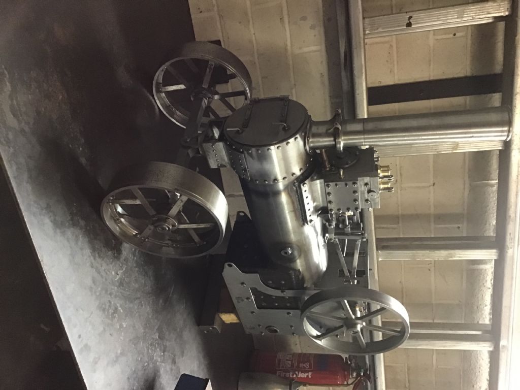

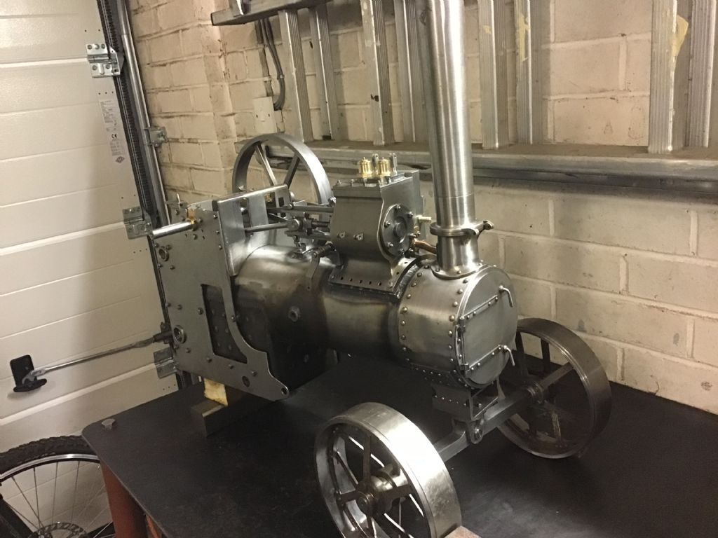

Thanks very much guys I can see where I went wrong now. Did you all make the selector from one piece or did you all solder the flat brackets onto the back of the ring as the instructions say?
anyhow here is where I am up to on my build. It’s taken a few years now because of work commitments and being a tight yorkshire I refuse to buy any castings. Everything has been made from scratch or fabricated, including the steam chest. All the gears are made as are all the wheels, the next major part will be the tender for the coal, after I get this damn selector ring

Yes it’s a steel boiler that I made myself. It’s made from high grade boiler tubing as used on an actual steam turbine.
I made the wall of the boiler shell slightly thicker to allow for any rust erosion. It’s been tig welded and then pressure tested with water to 250psi with no problems . Everything on the engine has been built from scratch.
