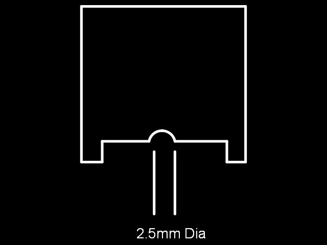

Hi Guys,
half circle bore.jpegI intend boring a half round groove of diameter 2.5mm into the bottom of a 15mm mild steel cube. Not sure what tool to use any suggestions welcome.
Regards
Chris

You could make a D bit or use a 2.5mm ball ended milling cutter, in both cases just plunge straight in.

Looks to me Chris has drawn a 2.5mm diameter dimple in the part, so as said a form tool or a 2.5mm Ball Nose slot drill could be plunged in 2.5mm for the desired shape.

Hi Guys, thanks for posts for clarity the half round groove goes right across the face in a straight line.

But now we know the groove is right across the part then it seems a round nose form tool/slot drill is the tool needed.

So it is beginning to sound like a groove 1.25 mm deep across the face with a 2.5 mm ball nose end mill.
Personally, I would be wary of doing it all in one cut, half the diameter of the end mill, even with a very fine feed.
(Unless you have LOTS of spare cutters to hand! )
Maybe gradually take out out some of the material with a 2mm end mill, for part of the depth, and then finish off with the ball end cutter.

Chris now we know what you need to do my suggested ball nosed milling cutter would do but if you don't want to buy one then you can actually do it but simply drilling a 2.5mm dia hole right through the cube and then using a standard milling cutter to form the rectangular recess shown on your sketch which will split the round hole in two.

Jason has given you an excellent choice. Should you decide to get a 2.5mm ball ended milling cutter to do the work, you will have to be very careful milling it. You will have to do the groove in careful stages to avoid breaking the cutter. With that size, I would recommend the following stages;
First cut 0.5mm deep.
Second cut 0.3mm deep.
Third cut 0.2mm deep.
Fourth cut 0.15mm deep
Fifth cut 0.1mm deep.
Run the mill at its maximum speed. Don't rush the feed rate. You can cut in either direction as you increase the depth.
Use oil if using HSS, or dry if solid carbide.

Like it Jason, clever. many thanks.
