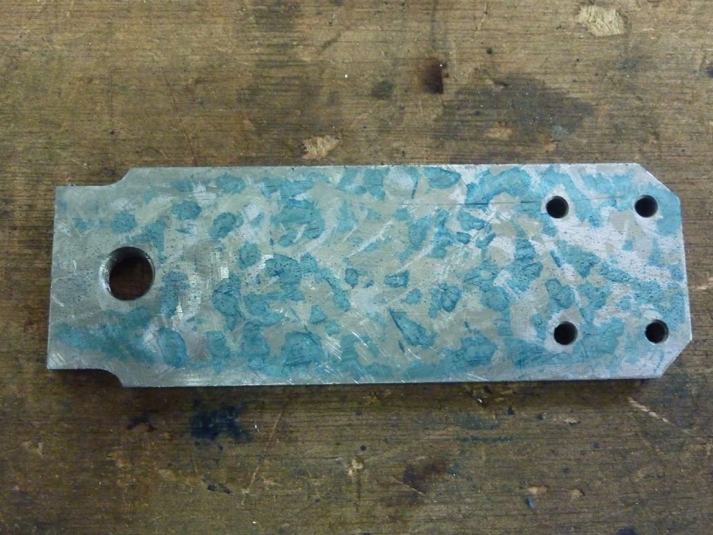

So I got some work done on the machine this weekend.
The piece below is the bit that goes up and down sliding on the main casting. It is supported and guided by the bits above. I rubbed it on the surface plate and as you can see there is very little contact.
After about half an hour with a carbide paint scraper blade that has been soldered to a length of steel rod it looked like this, which is looking much better.

Buffer13/12/2020 18:33:43
430 forum posts
171 photos
The 5 tooth shell mill actually gives a very nice finish when you want it too but I knew I was going to scrape this bit so I didn't hang about with it.
This is the casting after about an hour with the home made scraper

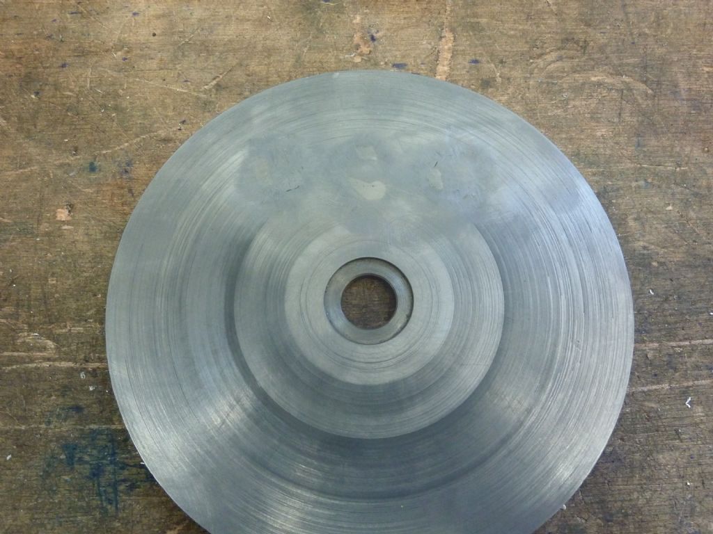

Thanks guys.
Well Wifey went to work today and the kids seemed happy scrapping with each other so I sneaked out to get another bit knocked off.
Now the instructions do say that you should give the table a skim over to get it flat. The piece is punched out so it has clearly taken on a bit of a curve. It's not obvious by looking at it so I wouldn't worry if your 4 jaw can't cope but mine can so I gave it a long going over. You can clearly see here that the middle is a bit lower than the edge. It's not a lot though probably less than 1/2 a mm.
This is the other side and its pretty obvious but the middle is now being cut before the edge. I only cut enough to get a flat surface for the casting to bolt to it.
