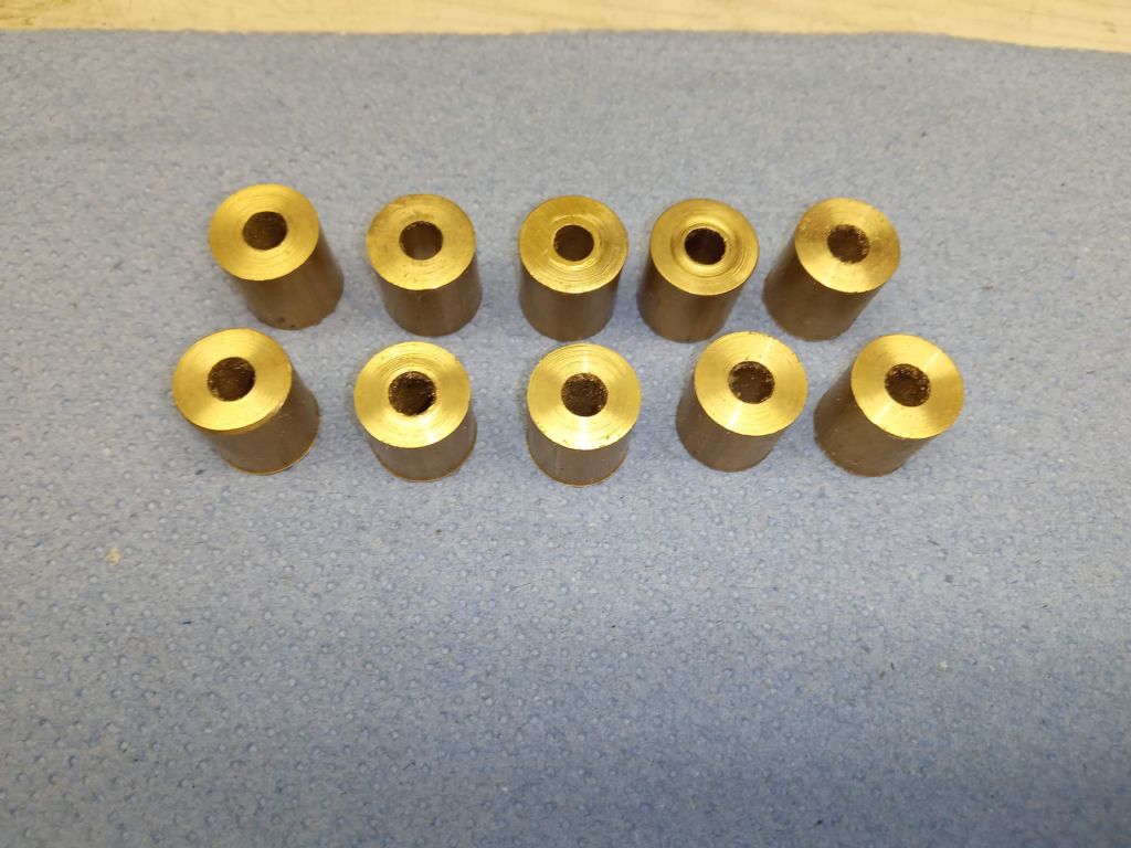

At the moment I have been using (under supervision) my old mates lathe to produce these.
These are simple brass rollers 14mm wide and 17.5 mm long with a 5mm bore/hole through them.
Like i say, dead simple product.

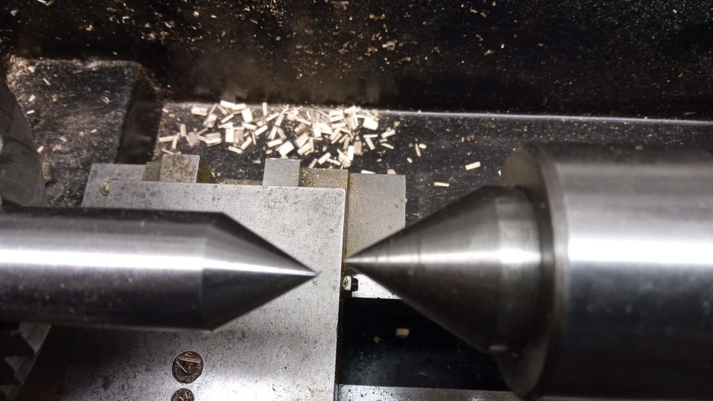

Ok chaps, I bagged a cl300m in pretty good nick second hand but I did notice this problem.
Its fine regarding level, it just seems to wander away from me when I tighten the bolt holding the tailstock, it all seems to move around a bit before the bolt grips then has I tighten the bolt it moves away from me and ends up in that position.
any thoughts?

My first thought would be to check to see if any of the bolts/screws have been bent.
Have you cleaned the Morse taper?
JasonB17/12/2020 11:43:03
avatar
25215 forum posts
3105 photos
1 articles
If you look at the underside there are two cap head screws in slotted holes, loosen these slightly and slide the head into position then tighten up again. There may be a grub screw on the right hand side that needs undoing too.

Tail-stocks are right-left adjustable so you can turn tapers. On my mini-lathe (now gone so I can't photograph it) there were four adjusting bolts bottom right of the tail-stock. The end pair lock the slide in position, while the two on opposite sides control the offset.
With the tail-stock locked down on the bed, in theory all you have to do is to free the slide by slackening the two end bolts, and then twirl the side adjusters in opposite directions until the tailstock aligns correctly with the headstock. (Done initially by eye with centres as in your picture, then by nipping a few inches of shim or a 6" steel rule between the points - the shim sits straight when the points are accurately aligned.) When the offset is correct, it's locked with the end screws. Sort of!
In practice all four screws effect alignment and adjustment is tricky because this is a crude mechanism. Inside the tailstock the adjusting screws bear on a rough steel block, causing erratic adjustment. Don't panic - it can be done! But it might take several attempts to get all four bolts 'just so'. Once adjusted I suggest leaving it alone! Fortunately, I only needed to cut a couple of tapers on my mini-lathe!

The Tailstock looks to be out of alignment. If you try to drill with it like that, best case you will get oversize holes.
Worst case you will break the drill! (Always start a drill with either a Centre Drill or a Spotting Drill )
As Jason says, find the capscrews and adjust them to bring the two centres into alignment.
When they look to be OK, trap a thin piece of steel between then, so that it is horizontal.
When it lies exactly square across the lathe, the centres are aligned. If it is at an angle, adjust the two capscrews until it is. Lock the two capscrews against each other so that the steel is still square across the lathe.
Eventually, you will be able to make up, or buy, and alignment bar and set the Tailstock with the bar between centres with a dial indicator.
