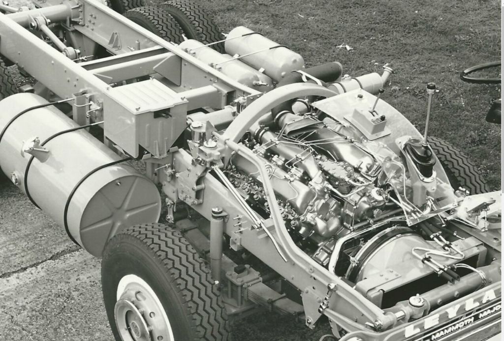

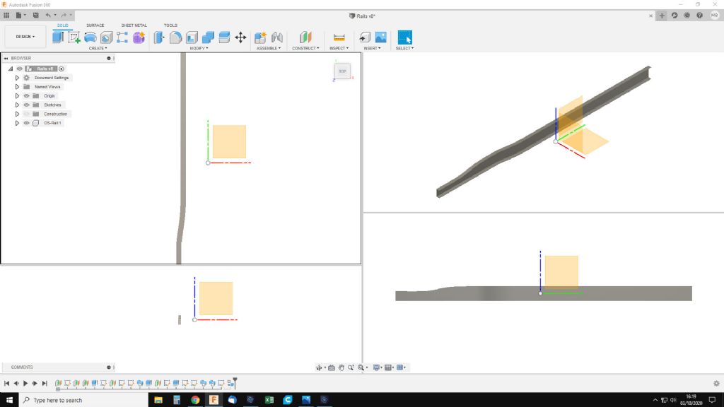

DollyDigger03/10/2020 16:28:20
51 forum posts
7 photos
Jon, i want to start with a chassis frame, this way i can add to the main part, trouble is if i get the dimensions wrong of this then the rest will never fit
It seemed a simple part until i found the layout of it. I dont suppose it will do no harm to start here
Picture of my drawing and the other picture with permission of Richard Staines brochure collection.
The rail i was originally going to use Ali channel, but now i am thinking Steel but its the profile making that i need to get around as mentioned a bit earlier

Delighted to see you speak Fusion360 Bernie!
Just to get the ball rolling because I'm no expert:
Is the problem making the U channel, putting the crank in it and/or working out how long the unbent channel needs to be?
  • If not available from the plan, I'd get the length of the unbent channel by bending a bit of thickish copper wire to fit the plan, then straighten it out and measure it, scaling as necessary.
  • I'd mill the straight U channel from solid mild-steel. (Full size would have been rolled, but that's too hard.)
  • Mild steel can be bent, I'm on thin ice here but in the absence of better advice I suggest making a jig consisting of suitably hefty removable pins let into a strong plate. Mild steel bends easily at red-heat, so the straight channel is warmed at the bend point, then plonked into the jig and worked around each pin in turn until the crank is done. I'd notch the channel edges so they don't buckle at the bends. Body fill the notches if strength doesn't matter at all, silver solder is good for strong models, safety critical should be welded.
If you have Fusion, the whole bus could be modelled and assembled in CAD to confirm dimensions, holes and joints etc. Not necessary to model every little detail because most designs have a limited number of key points that have to be accurate, then everything else relates to them. Be great if a loco modeller would describe how they do this sort of work rather than me mislead you by guessing.
