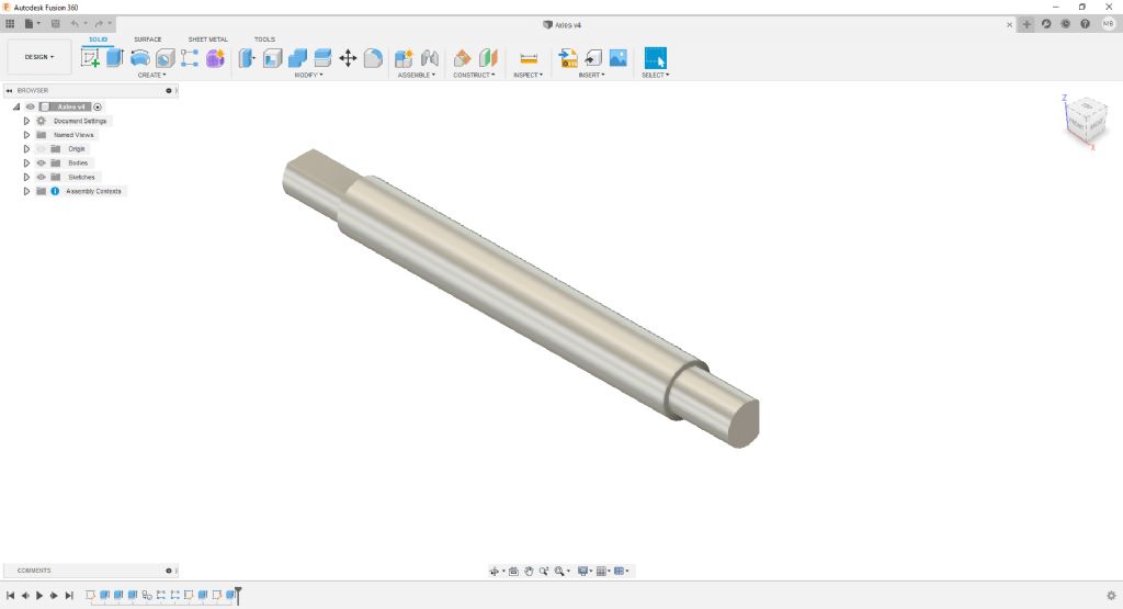

Hi
Lets take a 15mm bar 100mm long, put in the lathe and cut 20mm in to leave 12mm stubs ea end.
Put the bar in the vice on the mill and machine a flat across the 12 mm end 4mm from ctr.
I want to machine a flat at 90 degrees to the first one on the other end, i would like it to be as accurate as possible, how would i go about this?
cheers
Malc

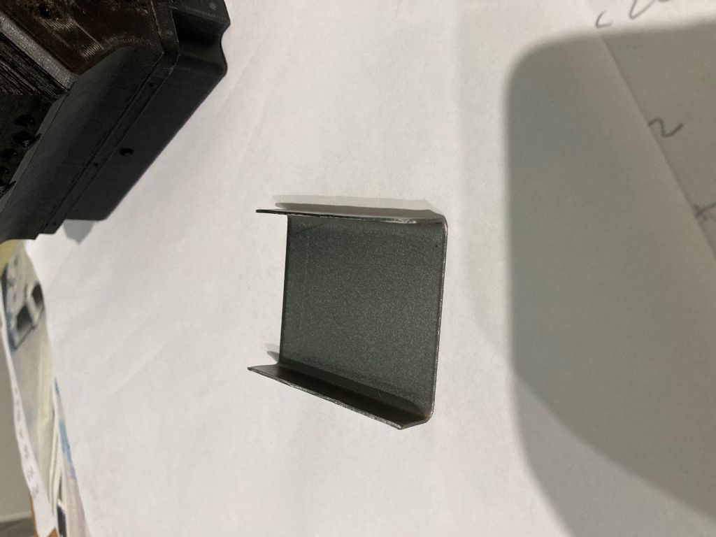

I had forgot about fusions sheet metal , cheers gary, that was sooo easy, although it came up with 69.7mm and i double checked the settings, the only bit i am not sure of is what the k setting should be, i put 33

Paul is correct; the neutral axis is not usually at the midpoint of the material, but is closer to the inside of the bend. I normally do sheet metal design using the sheetmetal function in Alibre CAD where the K-factor is 0.33 by default, ie, the neutral axis is one third of the material thickness from the inside of the bend. Assuming that a box and pan folder is being used the other important factor is the bend line, ie, the start of the bend. This is where the material is clamped. Based on previous work if I made the part shown I'd expect overall dimensions to be within 0.1 to 0.2mm.
For large bend radii, as in this wheel rim, assuming that the neutral axis is at half material thickness is valid:
The length of material needed to get the final wheel diameter was based on the diameter at half material thickness. After rolling and welding the final wheel diameter was about 15 thou off the target of 14.5".

Thanks for that Paul, i gave Jason's diagram a real good go over until i was fully conversant in how it all comes together and i really feel i have a much better grasp on metal bending, thanks to all.

To get my req piece size of 12.5 x 50 x 12.5 mm i ended up with a 72mm strip, bending it a 11mm in from the edge with the tightest radius the bender could accommodate

Does this sound right?
I started with 1.2 mm thick steel x 61mm depth.
I bent it in my Sealey 760 metal bender to start practising ready to make the chassis rails.
The top and bottom flanges are to be 12.5 mm wide and i bent at a line of 13.5 to allow for a 2mm radius.
Now measuring the total top to bottom and the 12.5mm widths (which were 13.5) it comes to 64.5, its grown, glad i got plenty of scrap.
