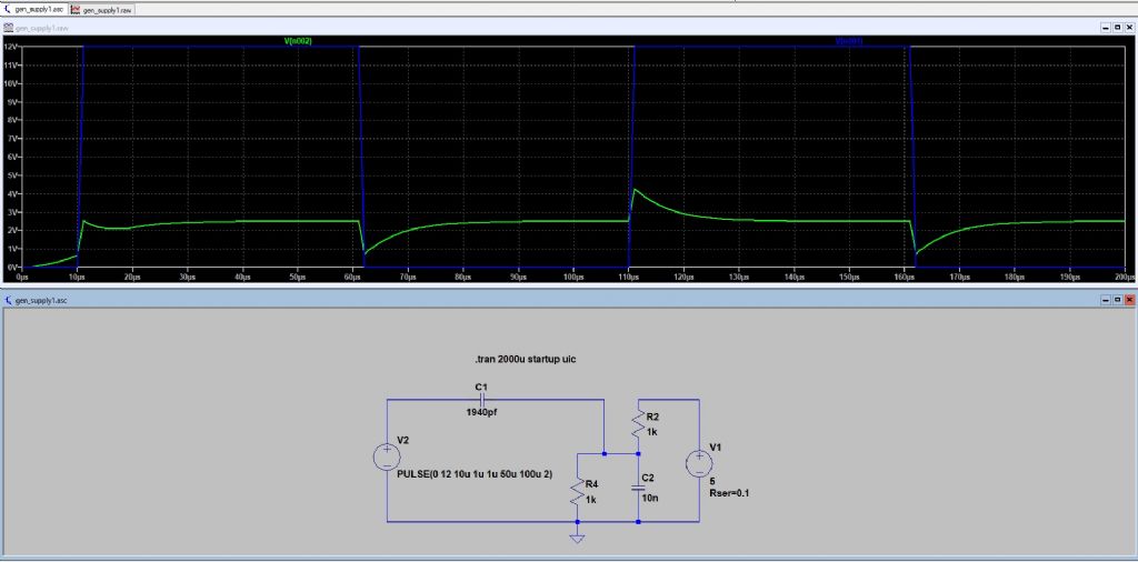

Now one for the electronic gurus. The signals on our track are connected together by 3 core cable, mostly 1 sq.mm 3 core twin and earth. At one end what I'll call the message core is connected to ground via 1k resistance, at the other it is connected to 5v by 1k resistor, but of course there is no 5v before the 12v is established. There must be some capacitance between the cores, so what happens when I switch on? If the message cable wasn't connected to anything else I'd expect it to go to half of 12v, which would be embarrassing as it would exceed the 5v limit on the electronics. If I had a battery scope I'd just measure it, but I haven't, and we have no mains power. We do have a generator, but would that be good enough for my expensive scope?
I'm tempted to fit 4.7v zenners both ends, but with the lack of mains that isn't all that easy either. Would a capacitor to ground work? I imagine that if the combined capacitance core to core pu external cap is say double the core to core then I couldn't get more than 1/3 of the 12v. Anyone advise? Its way out of my understanding

Duncan,
lets assume a 8mm OD 3core cable of 1mm sq Cu - this has typically around 97pf/meter tween cores.
take 20 meters - thats 1940pf, with a R of 1k to gnd and one to 5v.
A +12v pulse on an adjacent wire will spike the signal wire up to approx 10v, and down to approx -5v when the +12v turns off.
Add a 10n cap tween signal line and ground, and the spike reduces to +4.1v and +0.9v when the 12v is turned on then off.
Here's reasonable proof..
2x1k load, no cap to gnd
2x500ohm load, no cap
2x1k load, 10n cap

I don't quite understand why you think it would go to half 12v. The peak voltage on the signal cable would be dependant on the capacitance of the cable and how fast the voltages rise on the 5V and 12V. The examples I have seen on Google give capacitances of 100pF/m.
I assume the signalling you are talking about is manual on/off, not fast data signalling. I would connect a capacitor e.g 470nF on the signal wire. This would not only suppress any transients caused by the switch on, but also suppress any mains hum on the signal wire.

470 nF at 50 Hz is a reactance of 6.7k - not much hum reduction especially if inductively coupled.
I don't see why you are driving the line like this Duncan? Surely with a 1k pullup and a 1k termination the "high" level on the line is only 2.5V? Would be better to just terminate on a gate input, maybe with some additional protection diodes?

Joseph Noci 111/09/2020 12:46:19
1323 forum posts
1431 photos
Posted by duncan webster on 11/09/2020 11:27:12:
Do I add zenners or caps, or both? I'm going to repeat Joe's experiment and will report back, in fact I've just remembered we have a 100m drum of cable waiting for the next phase of extension, so I can try it on that in the comfort of my workshop. Just one point on Joe's test, shouldn't there be a capacitor from the nominal 2.5v point to ground?
Thanks for all the replies.
Either zeners or caps - don't need both. If you had lightening in the area, zeners would be better, but then the ground is probably questionable with lightning around..
Caps are all that is needed - 10nf for 20m, 47nf for 100m good enough.. The simulation is a 'perfect' one - the voltages you get with a scope will most likely be a fair bit less, as I have not modeled the inductance of a 100meter length in the setup, nor taken any dielectric ( cable insulation) losses into the model - but that is becoming esoteric.. and offers little to the solution here.
Uhmm, there is one....?? 10nf...3rd solution image..
Joe

Silly me, I meant a second 1940pf in fig one to replicate the message to ground capacitance of the cable in fig 1. Capacitors it is, I've got a big bag of 0.1uF, if these are too big I'll order some 47nF
