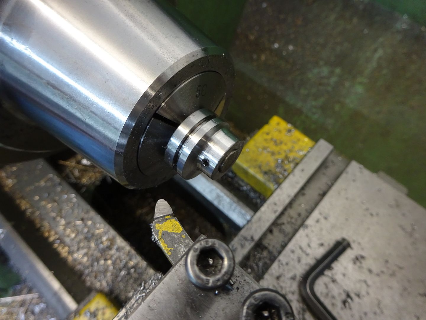

Another vote for using the mill to put the hole in after turning the OD and cutting the groove. If you then drill for the grub screw you can use that to hold the eccentric onto the end of a piece of bar back in the lathe so that the boss can be turned concentric to the hole.
