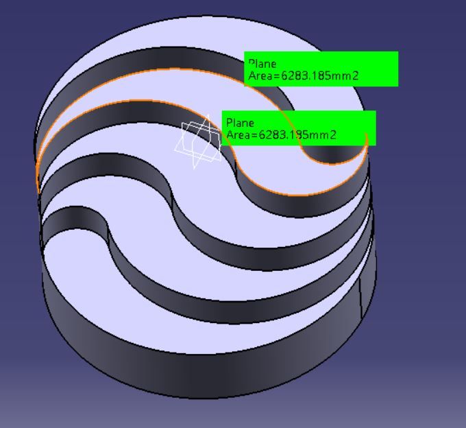

In that spirit, I offer a couple of examples. In the CAD package of your choice, or paper and pencil, how easy or difficult is it to replicate them?
First, two lines at an angle (any angle), connected by a pair of reverse curves. This is a common problem laying out railway lines, where the line is run around an obstacle rather than build expensive tunnels or bridges. In this example the tight curve is radius = 1 and the broad curve is 1.75
Second example is decorative:
Not difficult except the swirls are 36° off horizontal.
Bonus question, are the five curvy segments all the same area or not? Can your CAD tool measure areas?

Alibre has answered the bonus question, I'll post the answer later after a few other have posted.

If Dave is bored this afternoon then maybe he could have a go at machining his spiral pattern on the end of some bar and see if he can get it to look like thisdevil

Both F360 and Alibre start any item with a two dimensional "sketch" eg you draw one elevation, then the extrusion is really nothing more than adding another elevation to give the part depth just as a drawing side elevation would give depth to the front view.
Dave's part I showed above was just a series of three arcs on a two dimensional plane for each area which I chose to give different heights to.

Pretty easy with Fusion, and the areas are equal.
