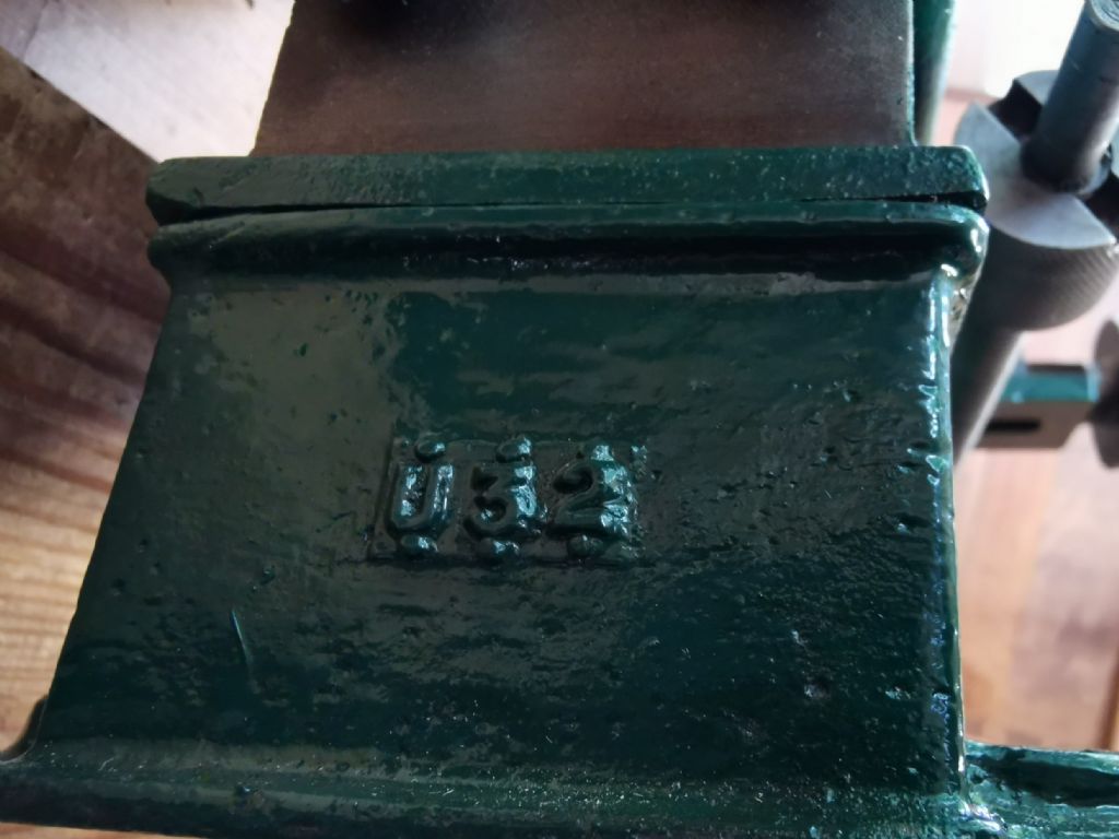

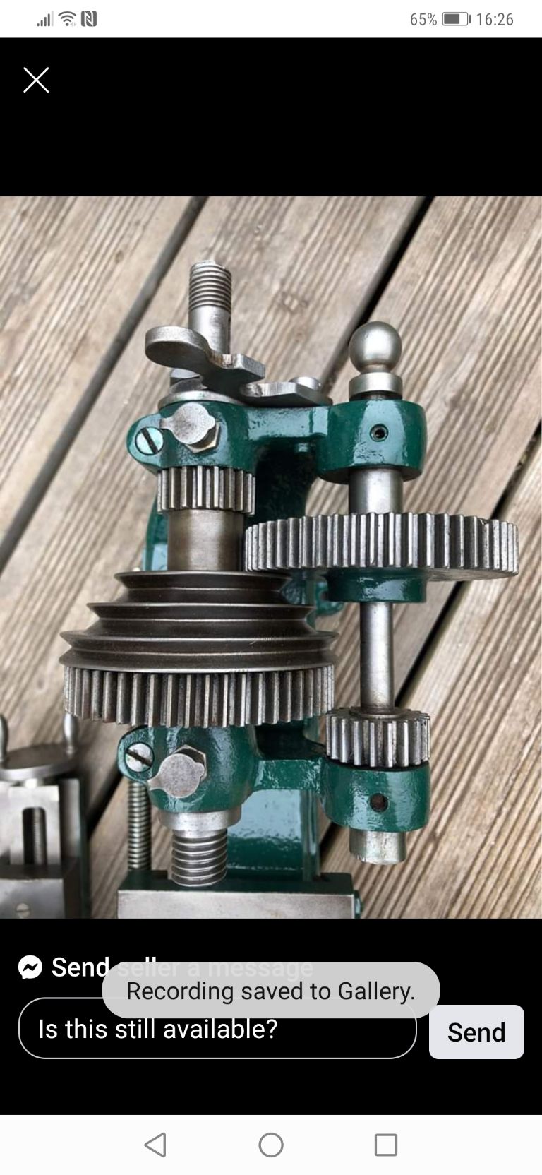

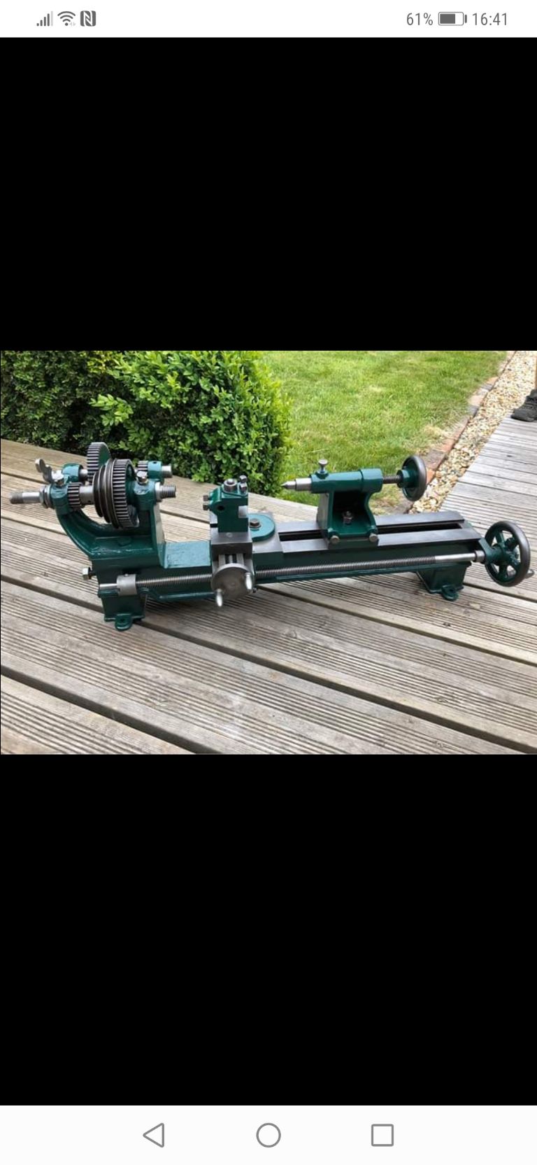

img_20200513_171405.jpgscreenshot_20200510_162638_com.facebook.katana.jpgHello my name is Jim and I'm from West Sussex.
I recently bought my first lathe. It looked like a little gem when I saw the listing and for £120 (not complete however) I thought bargain. Look really well made.
I went for a small lathe as I don't need anything too big and I thought it would be easier to learn with.
I can't find out any information about this lathe or who it's made by even, the only marking is U32 in the leg casting. I need to source some compatible parts and ideally the auto feed parts as they are missing.
Any info would be a massive help, thanks.screenshot_20200510_164156_com.facebook.katana.jpg

Hi Jim & welcome. Wonder if it's an early Myford, although I think they had flat belts. Someone will be along in the morning with an answer. Horlicks knocks you out. I think I decended from a tabby cat.

I don't think this is an early Myford, but I am willing to be proved wrong! We'll see what others think.

Portass or IXL?

The toolpost and probably topslide are Drummond as is the style of the back gear lock but not the rest of it.

On Lathes UK, "Small Unknown British Lathe no 99" is very similar, though the bed is different.
It looks a nice old machine, but don't expect too much from it. It will be difficult and probably uneconomic to restore fully. As your first lathe, if it is not too badly worn, it is worth setting it up with a motor and a countershaft, and you will learn a lot.
You don't need an auto feed to start with, but you will need a chuck, or chucks, so the first thing is to find out what thread is used on the mandrel nose and try and source a suitable backplate.

I doubt it ever had an auto-feed - but that could be overcome with modern-day electronics, if really wanted.
Personally, I would only consider a counter-shaft and motor if I had a suitable gash motor to hand. More likely fit a 1/2HP 3 phase motor (with VFD) with a suitable multi-sheave pulley and attach that as a drive.
It looks well made and may not be too worn. V (or round?) belt drive might give a clue as to maximum age.
If you are lucky, there may be suitable chucks on epay or gumtee. With luck, it may be the same as some more common lathes - thread size, pitch and form (along with the register details) posted here might even turn up a suitable candidate.

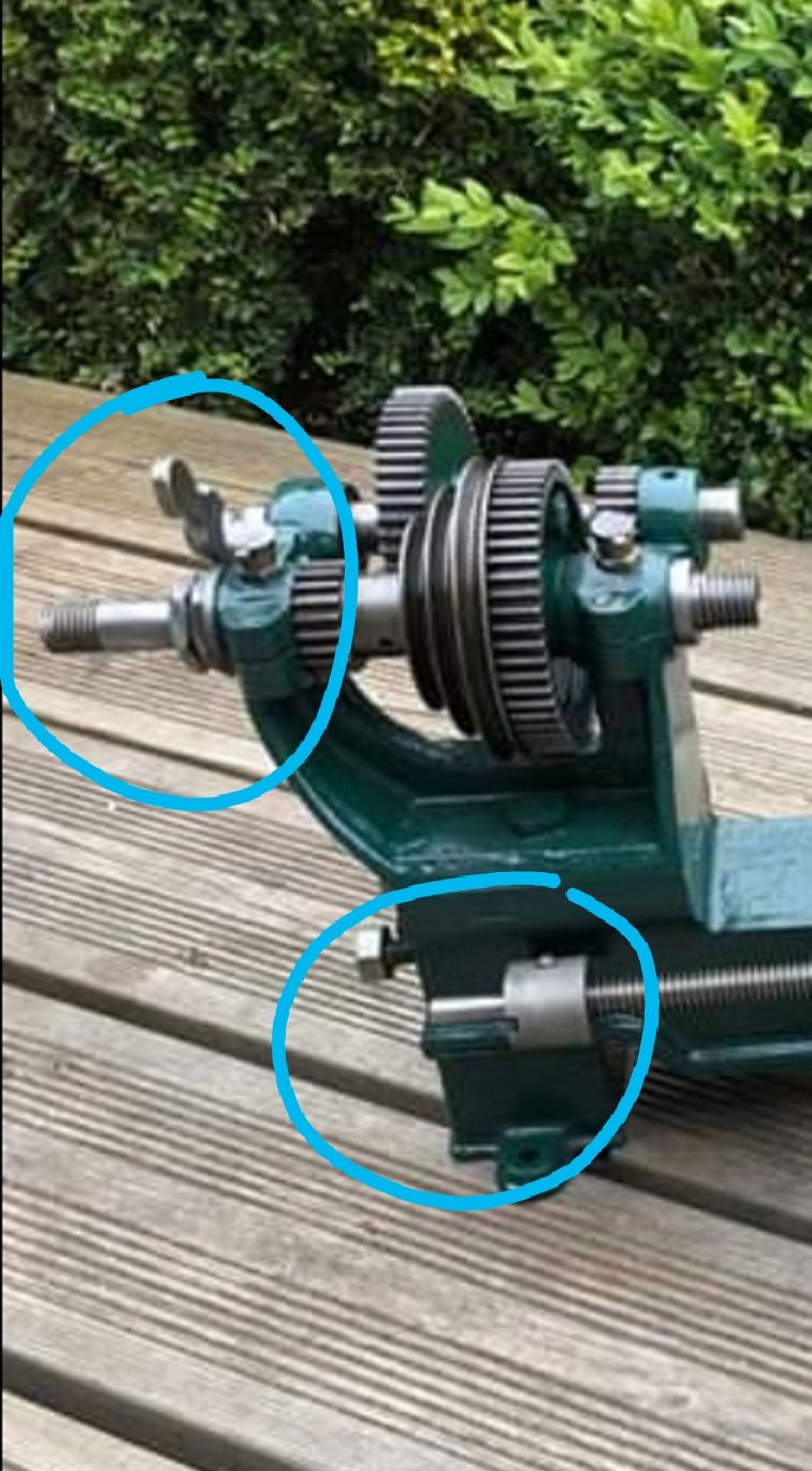

You can see on this pic here hopefully; the slotted drive fitting in the feed screw and also off the back of the drive spindle where gears would have been. It would be nice to cut threads one day. The dovetail bed has adjustment in, although the tailstock does seem a bit worn, I can probably shim that though np.
The spindle thread is 3/4x10. When I Google that all that comes up are adaptors 😆 I assume from that, people use more common chucks with a different thread.
What size chuck would you suggest for such a small lathe? Do you want some measurements?
I have a 350W ac motor I was going to try to begin with. They are V pulleys, tiny... 7mm.

I would think it uses round belts, judging from the angle of the vees in the pulleys. Leather with a simple link of bent iron wire for the join. Its hard to tell from just the pics, but a 100mm chuck looks possible. Give us the measurement from the centre of the spindle straight down to the frame. You have six speeds over a quite good range with a very strong looking back gear.

with that style of headstock bearing spindle speed doesn't want to be more than 700 rpm ish, so unless you're prepared to only use the big pulley direct driving to a little pulley on your motor, a counter-shaft is called for

It would be interesting to see some of the principal dimensions - height from the top of the bed to the centre of the spindle being the main one (easiest to measure from the bed to the tip of your tailstock centre). An idea of the overall length would be good too.
I'd guess about a 3 or maybe 4 inch chuck based on your photos... but that's guessing your dimensions from the wooden decking.
You're in need of a chuck backplate. I can't immediately see any off the shelf ones with that thread size. If you can't find a second hand one then getting from not having an imperial threaded backplate to having your first one may be a bit of a 'chicken and egg' problem because ideally you would use a lathe to machine one from a suitably sized blank and it's hardly an ideal first exercise in lathe use. Do you have any friends who could help?

James,3/4in. x10tpi (3/4 in.BSW) is the same nose thread used on the Drummond round bed lathes,so by keeping a look out on EBay and other sales site you might well be able to pick up chucks and faceplates that will fit straight onto your lathe without having to do any machining or modifying.
