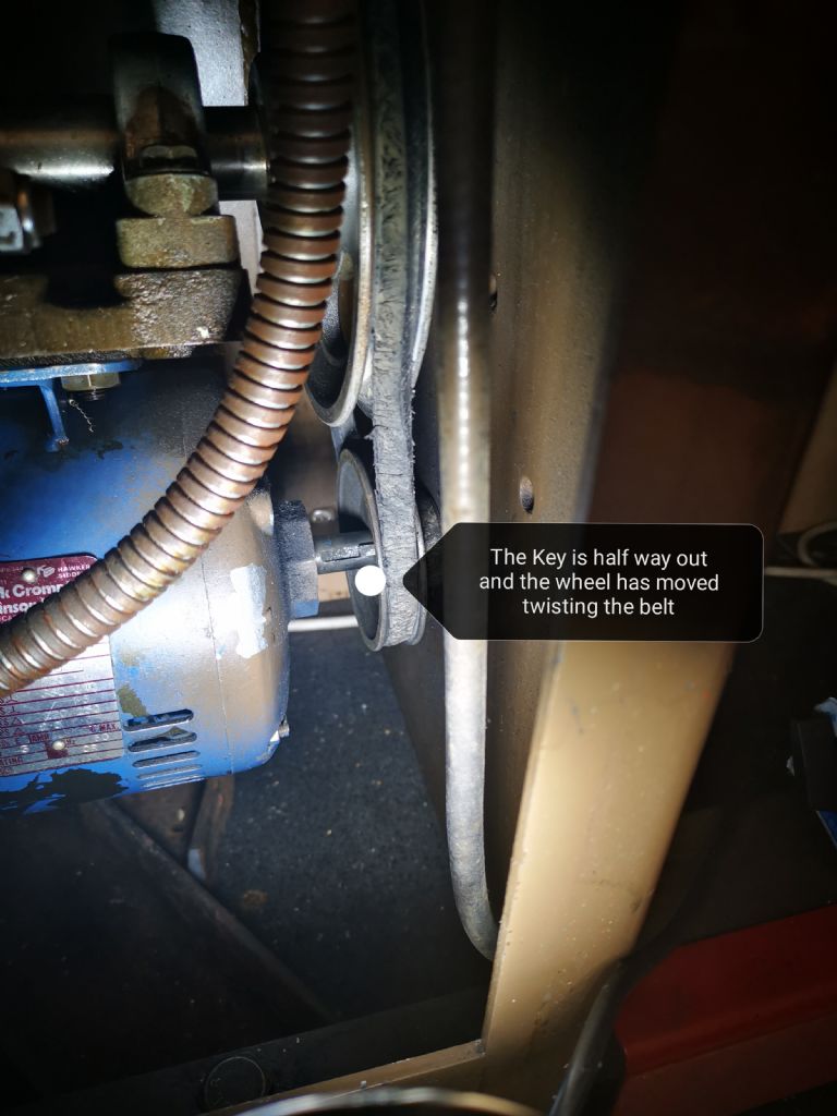

1) the key is slipping out of the keyway of the spindle on the rhs of the motor. I only noticed recently when the drive belt wheel was grinding against the wall of the motor compartment! The belt had twisted too so I'm glad I caught it early. This all happened when the key presumably slipped. I managed to get it all back into place with gentle use of a crow bar and I tightened up the grub screw in the spindle.
Sadly the key has slipped out again.
My first question is then, do I have to remove the motor to gain proper access to sort this out? There is virtually no room to work on this in situ.

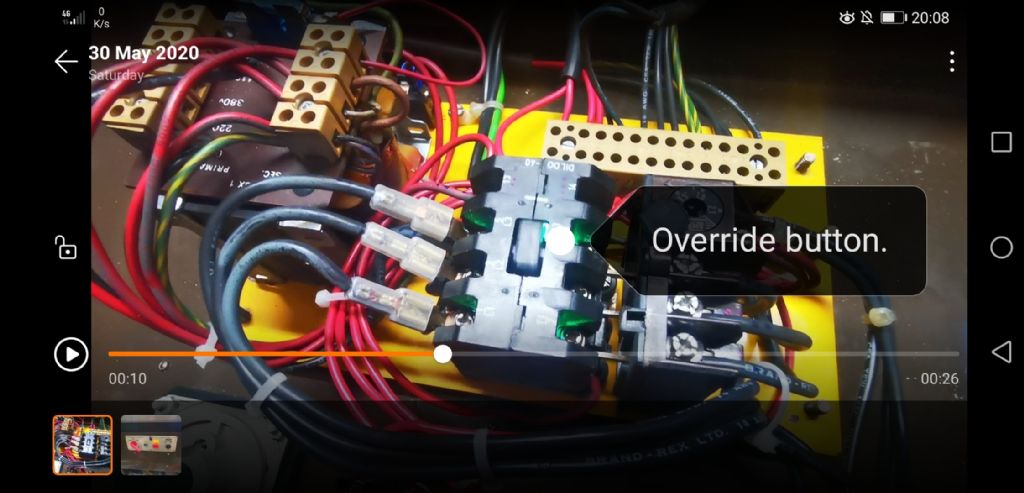

2) a few weeks ago I was practicing thread cutting. I was starting and stopping the motor quite a bit, in retrospect maybe a bit too frequently. As a result the reverse switch began failing to engage.
If I hold the green start button in, I get a very noisy stuttering as the safety electrics keep shutting it off, like I'm pressing the stop button at the sage time.
So I opened the panel and analysed how things work. I can manually switch the reverse on by pressing the black button on the main junction box. The emergency stop doesn't engage. This makes me wonder if there is something wrong with the reverse switch controlled from the front panel. I am on single phase and the reverse switch had been working since I bought the lathe last year.
My second question is then, does anyone have experience of this happening? And if so can you advise.

It sounds as if the latching contactor in the start switch could be failing. Does the same thing happen in forward ? or perhaps -
My AUD is an ex-schools model with safety cutout switches on the motor cabinet, the gear casing and back gear selector knob. If any of these are not adjusted correctly, the self latching start contactor would drop out.

Motors often have specifications such as duty as well as current, power and rpm. The duty may be something like 20 minutes per hour or continuous. Another may be maximum number of starts per hour. The later is important for single phase motors that have a start circuit as well as the run circuit. The start circuit only kicks in when power is first applied and pushes the motor in the correct direction until the motor is up to speed when it is disconnected. This becomes an issue when you are stopping and restarting the motor frequently on a motor with limited starts per hour.
The limitation is due to excess heat build up in the motor needing time to dissipate. There is a possibility that you have overheated the motor and this has had knock on effects in the rest of the system.
The next possibility is that frequent reversals has resulted in the contactors shaking something loose.
Another possibility is that you are using a reversing switch that should only be operated when not powered up. Some reversing switches need the power off before they are operated otherwise the contacts arc and either weld together or fail to make contact due to oxide build up on the surface.

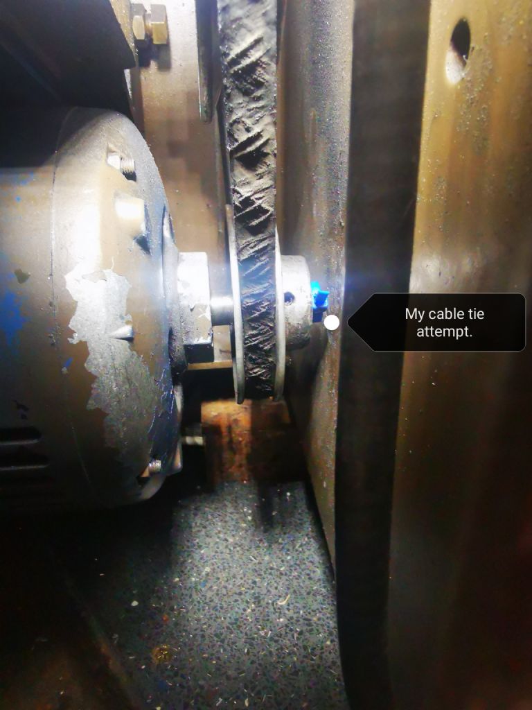

Bob, it looks like a royal ball ache to remove the motor but I will do it if it's the last resort. I've loosemed the grub screw and eased the key back along the keyway and retightened the grub screw on the wheel. In a pitiful attempt at stopping the key moving again I've put a plastic cable tie on the end of the spindle. You never know a tiny bit of resistance might just stop it edging out.

Inside control panel
Fergus Davidson30/05/2020 20:14:05
29 forum posts
19 photos

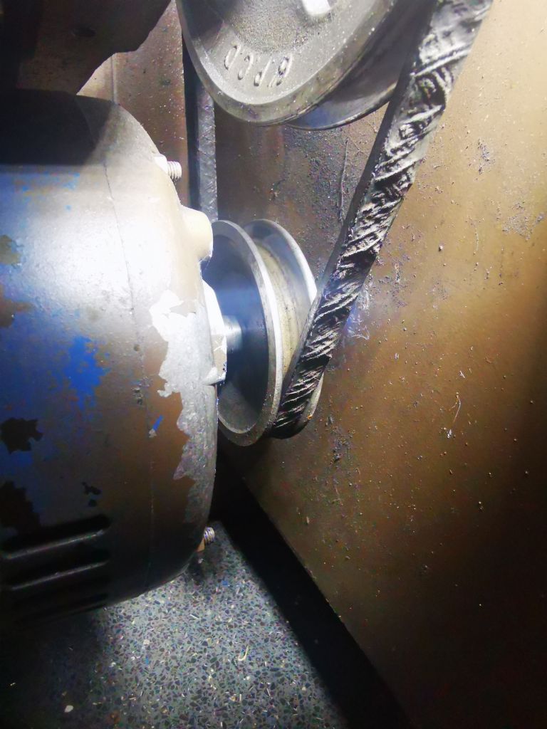

Belt wear
Fergus Davidson30/05/2020 20:14:29
29 forum posts
19 photos
Twisted belt
Fergus Davidson30/05/2020 20:15:04
29 forum posts
19 photos
Wheel slip
Fergus Davidson30/05/2020 20:17:10
29 forum posts
19 photos
Cable tie

The picture posted at 20:14:05 shows the drive belt . It seems in good condition although the outside looks very rough.
The control wiring picture shows the button I press that allows the reverse to engage. I just did this to show the reverse actually works but not by the normal method of pressing the green start button on the front panel. This is entirely for demonstration as it's totally impractical to open the panel every time I need to engage reverse. I took a video but I don't think I can pay this here .

Are you sure there is not a second grub screw under that one ?
Doubling securing screws is very common.
larry phelan 130/05/2020 20:45:37
1346 forum posts
15 photos
Just as a matter of interest, how or why is the key moving ?
Is it the wrong size ? Why is the screw not clamping it in place ?

Also check for a second grub screw positioned at 90 degrees to the one you can see.
Martin C
Fergus Davidson30/05/2020 21:41:09
29 forum posts
19 photos
Hi
John, that's interesting I'll check it out tomorrow.
Larry, I've no idea. I find it a trial sometimes getting a gear back of I'm changing gears, with the key being a very tight fit. How this one is slipping is a curiosity! There's a possibility this motor has never been removed so I imagine the key is original and I can't see why it would be the wrong size. The grub screw is about 20° anticlockwise from the key so it only there to secure the wheel. I just can't figure out then why the key is moving. Clearly through vibration but normally the are such a bugger to get in I'm surprised it's moving.

Check Your pulley keyway and the key for wear , both need to be a good fit , Does you belt show any signs of wear also check the motor bearing for any movement , Have had this problem many times with motors and belt drives. If the motor shaft has any wear then this needs to be rebuilt and then turned down to the correct size and a new keyway cut , the pulley can be rebored and sleeved and a new keyway fitted , Continued use can result in your motor shaft breaking off at the point where this comes out of your motor , A difficult and then complicated repair to due , complete shaft can be replaced .Further investigation required to avoid a possible difficult repair..
