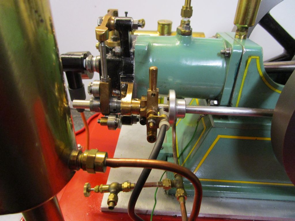

Hi all,
I’m looking for some much needed assistance as I come dangerously close to the completion of the build stage ! The areas that I am unsure of are:- 1. Exhaust, any advise on design would be much appreciated. 2. The ignition system, electrics has never been my strong point! so a circuit diagram would be a help together with the necessary components needed. 3. And finally? Fueling the thing, any advise on type of fuel Gas or Petrol? Here’s hoping for some tips from any engine builders out there or indeed anybody with this knowledge. I hope to get this engine finished shortly. Best regards, Jim.

Jim. You can do your own thing with the exhaust on the Wyvern, my version shown in the picture, I used a Hall sensor for my ignition by Minimag Link , however you can use points and coil ignition.
I run my Wyvern on petrol, you can use propane but I am not up on that method but it would be worth looking into.
Hope this helps.

Michael R - Thanks for some great photos of you engine, it’s given me some ideas for exhaust and cooling methods. Presumably you exhaust is a steel tube with holes in the blanked off end. Is it willed with some sound deadening material? The ignition system is interesting and so I will have a look at the Minimag and if ok get back to you for some fitting advise ?

Jim. My exhaust has no sound deadening just the expansion box, sounds not to bad noise wise.
