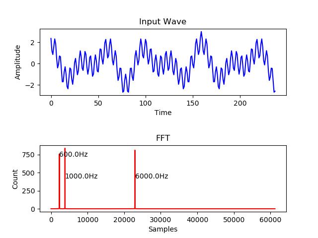

Got a book describing machine tool installation c1930. After levelling the floor, and maybe digging a deep 6" wide trench around the machine to isolate it from nearby machines, the first test is for vibration. Not levelling the bed or runout - they're for later. Vibration gets top priority because it's the main cause of poor finish. To detect it, a mechanical device consisting of several suspended pendulums was plonked on the ways. Any swinging indicated vibration frequencies to aid diagnosis. Much testing at various speeds and cuts. Here I attempt to replace the pendulum device with a computer, and investigate my WM280.
Running machines make noise due to bearings and gear settings. The noise is a rich mix of frequencies. Not a problem unless there's a match to one of the machine's natural resonances causing shaking at the cutting point.
I put a laptop on the bed of my WM280 and used its built-in mic to record the noise idling at 1260rpm. (Ubuntu command arecord -d 180 -D plughw foo.wav records 180s of audio from device plughw (the microphone), and saves it in a unsigned 8-bit mono wav file, sampled at 8000Hz )
Next is identifying frequency spikes in the sound. A wav file is a list of numbers representing frequencies changing over time. The image below is a simple test wave made from 3 clean sine waves and its already hard to see what they are. A Fast Fourier Transform converts the wave from the time domain into the frequency domain producing a sort of histogram showing how frequencies are spread across a spectrum.
Wunderbar, FFT found 3 inputs!
Applying FFT to the WM280 recording:wm280fft.jpg
Complicated result, but big spike at 400Hz, which seems nicely related to the chuck at 21rps (19*21). Also related spikes at about 200, 600, 800, 1000, and 1200Hz.
No conclusions yet! Next, I'll look for lathe settings producing poor finish and repeat to see if it occurs at particular frequencies.
Python program doing the work:
Don't understand why I had to multiply frequencies by 44 to get the graph X scale right. Hate fudge & I'm baffled! A promising start though. My brain is cooked...

I expect the odd multiple to get the frequency axis correct is due to incorrect scaling in the time domain to start with. Caveat, see next paragraph.
If the chuck is rotating at 21Hz why is 400Hz (and the times 19) important? I'd expect a fundamental at 21Hz and multiples thereof depending upon the number of teeth on gears.
It might be a bit more difficult to implement but I expect that measurements from a vibration sensor will tell you a lot more than a microphone. Looks like cheap accelerometers are available for the popular single board computers. Quite small vibration levels may well affect surface finish, but won't produce much sound. You definitely don't need resonance to spoil a finish. Machine tool makers will design to avoid obvious resonances. If something is creating a regular impulse the item being impulsed will vibrate, resonant or not.

Thanks Andrew,
I've ordered an Arduino KS037 Vibration Sensor Module (which does analog level and digital level detection) and an accelerometer. The first is simple to program, the accelerometer more tricky. Delivery expected next week.
Tried to justify my 400Hz and times 19 spindle speed claim by relating it to the lathe's change gear set-up and FAILED. On the assumption the noise is change gear whine, I reckon I should be seeing 126Hz, 504Hz and 840Hz. Calculations:
I had the fixed gearbox engaged on the half speed setting and turning the Feed Shaft, but not driving anything. I doubt it explains the discrepancy.
I assumed 19:1 would be the change gear ratio. Not so, if I've done the sums right, fine feed on a metric WM280 banjo is 14:1.
Back to the Drawing Board...

Could the "44" be the 44 Khz audio sample rate ?

To John - good idea! Full of optimism I checked the file:
dave@hawk:~/grc$ ffmpeg -hide_banner -i foo.wav
Guessed Channel Layout for Input Stream #0.0 : mono
Input #0, wav, from 'foo.wav':
Duration: 00:03:00.00, bitrate: 64 kb/s
Stream #0:0: Audio: pcm_u8 ([1][0][0][0] / 0x0001), 8000 Hz, mono, u8, 64 kb/s
Blast, it's 64kb/s, not 44!
Have to agree strongly with Mike: 'making sense of the data will be the hard part I feel.' Bitten off more than I can chew and am currently gagging on it. Serves me right for being a smart-ass!

The multiple frequencies you are seeing as harmonics (200, 400, 600, etc) could also be created by 'aliasing' if the sample rate is not correct.

Just a thought re your 44 fudge factor 8000/180 = 44.44444. Your scaling factor in the fftfreq is 8000/size and size is 8000*180

The 44 fudge factor mystery is solved. My mistake - I plugged in the wrong sum instead of 1/sampleRate.  See AdrianR's post!
Latest version of the Python program that does the analysis:
Probably ought to mention in connection with the maths that 'data', 'normalData', 'fftResult' and 'xfreqs' are arrays of numbers, not individual values. An audio sample lasting 15 seconds consists of over 100,000 numbers, so - despite the programs' apparent simplicity - it's doing millions of floating point calculations. Not a job for a slide-rule or calculator!
Anyway, next analysis is of something bad! I rubbed a carbide insert on the shoulder of ⌀38mm steel at 1260rpm, which produces an awful 'stop now you idiot' screech. The frequency spectrum is:
There's a fundamental at about 864Hz, second harmonic at 1728Hz, third at 2592Hz, and maybe 4th at 3456Hz. Rubbing vibration completely dominates whatever other noises the lathe is making. So what's vibrating at 864Hz? It can only be the tool.
Applying the tuning fork formula to the size and material of my insert holder gets close:
The formula suggests a 12x10x106mm steel tool would vibrate at 864Hz, which is delightfully close to its actual size, 12x10x100. However, I don't believe it! Unfortunately the tool is clamped to the tool-post with three bolts, and its overhang is only 17mm. I think I'm measuring the vibration of the tool, tool-post, compound slide and saddle. Also, because the tool is rubbing, the vibration may be more forced than free. Not sure what part is played by the tool rubbing on a 33mm diameter shoulder rotating at 21 revolutions per second. Is my insert-holder & tool-post vibrating in tune like a violin string, or is it just responding to a frequency generated by the spindle and tool rubbing at a surface speed of 2.5m/s? I've no idea!
