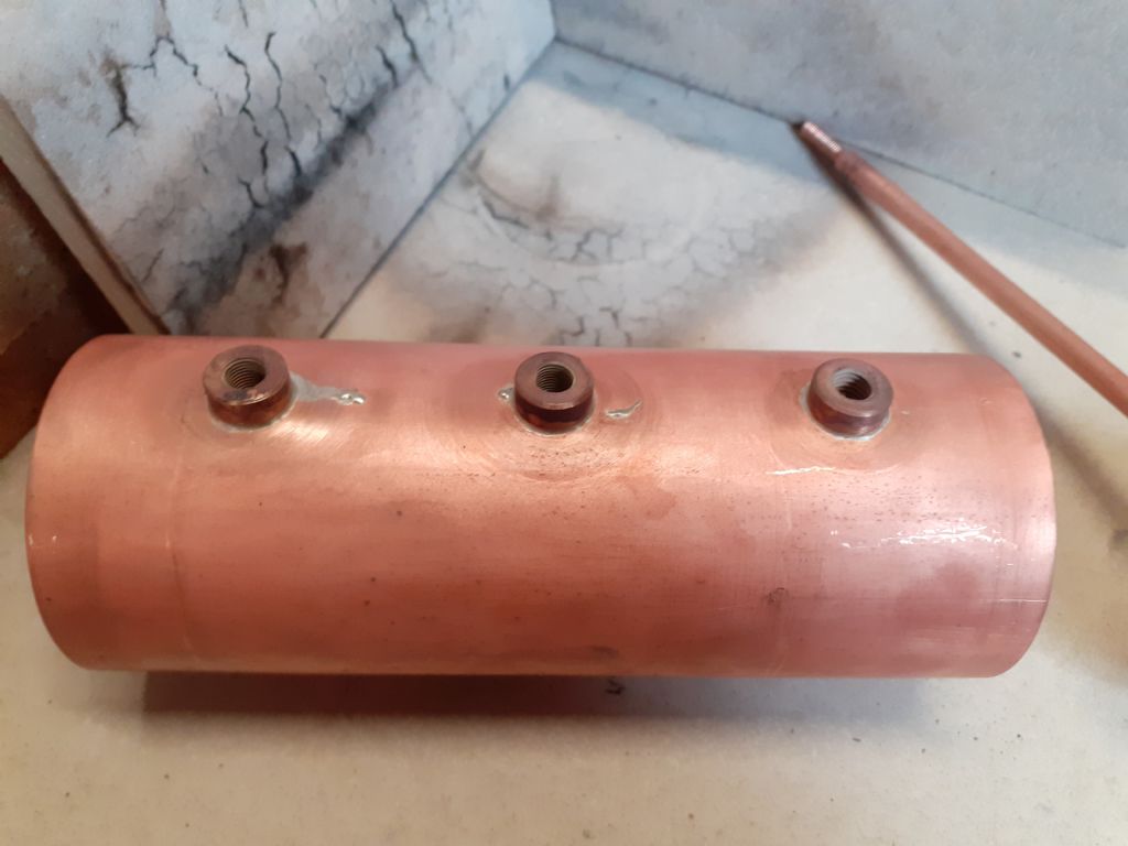

I am almost ready for silver soldering a new boiler for a small engine. The boiler is copper and phosphor bronze bushes. But there is a copper rod from front to back with bronze nuts. Where do you start do I solder the nuts on to the ends first then solder the end caps on to the main tube then solder the bronze bushes the copper rod has to be tight to hold the ends under pressure.

The boiler appears to be quite small. I'd assemble it with perhaps 3 or 4 small bronze screws holding each end plate to the barrel and solder all in one go, including the bushes. The bushes couid be done earlier, maybe with a slightly higher MP solder if you wish, but I don't think I'd bother with that.

The end caps are held on with the copper bar with bronze nuts but do I solder the bronze nuts at the same time as the end caps which are 12mm lapped on to the tube but about 5 thou clear to allow the solder to go up between them. The tube is 2 1/4 inch diamiter by 6 inch long.

5 thou sounds a lot. If you put an end cap in position and hold the barrel vertical will the cap fall out? They want to be a close sliding fit. Otherwise the solder can run straight through the gap and out the other end. I believe the advice to leave a gap for silver solder (and Loctite!) has caused more grief with boilers than any other thing. You need some gap, of course, but not much. I learned that lesson after much anguish and waste of ss.
I would pickle, rinse, assemble, and flux generously, set vertical, solder one end flange, stay and nut, set other end vertical and repeat, then set horizontal and do the bushes. If not confident, or worried about flux exhaustion, do one operation at a time, cooling and pickling between steps. My similar Ellie boiler has plain stay without thread or nut; they are unnecessary and just more work.

I have silver soldered the boiler. I decided to do it in stages, firstly I soldered the three bosses in the top of the boiler, then I soldered the boss for the level plug and the end nuts into the end caps and then the end caps were soldered one at a time on the ends. I pickled between each go and with a clean and flux on to the next stage. After fettle and a bit of scouring pad it looks ok.

David, You have made a nice job on your boiler very neat, just one point you really need your pressure gauge on a "U" Bend syphon to form a water slug which protects the gauge from damage by direct steam pressure, although you may know this already.

That's a smashing job David, especially as it's your first one. A very neat job of silver soldering.
Michael is completely correct, it really needs a 'U' bend or a coil of tube but a 'U' bend looks better.

David, the initial test is normally carried out at twice working pressure and subsequently at 1.5 times W.P. It is best (in my opinion) to pump it up in stages to work harden the copper. Say, up to 10 psi and release, then up to 20 and release etc.

Hi Geoff there us a web site                      http://www.stevesworkshop.co.uk/steammodels/simpleoscil/simpleoscil.htm                         I got the idea from there is quite a lot of info there but got material from M machine metals but I upgraded the tube size a bit and am changing a few sizes to suit what I fancy, like I have bought a solid fuel burner and am waiting for it to be delivered so I can set the boiler height to flame. The copper is 16 gauge thickness. I bought some insulating boards which helped with getting the parts hot enough https://www.cousinsuk.com/product/square-soldering-boards with fire bricks underneath. the solder was Cupalloys 455 1mm and easy flow flux.

I have a bullfinch blowtorch and bottle. I was surprised how hot it had to be for the solder to flow I was half expecting it to melt the copper and bronze.
