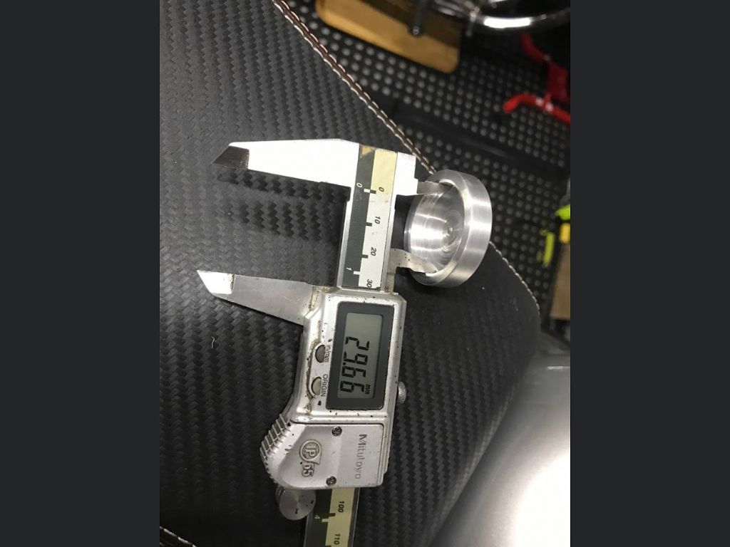

Hi guys - son is using a warco 240 lathe to make motorcycle fork nut caps - is there a quicker way to make a large internal rather than using the boring tool and taking 0.3 mm cuts from the centre - not sure how else to describe this - one is a 47 mm internal and the other a 30mm wide and around 10mm deep

Gavin Mclean26/04/2020 19:21:41
14 forum posts
6 photos
