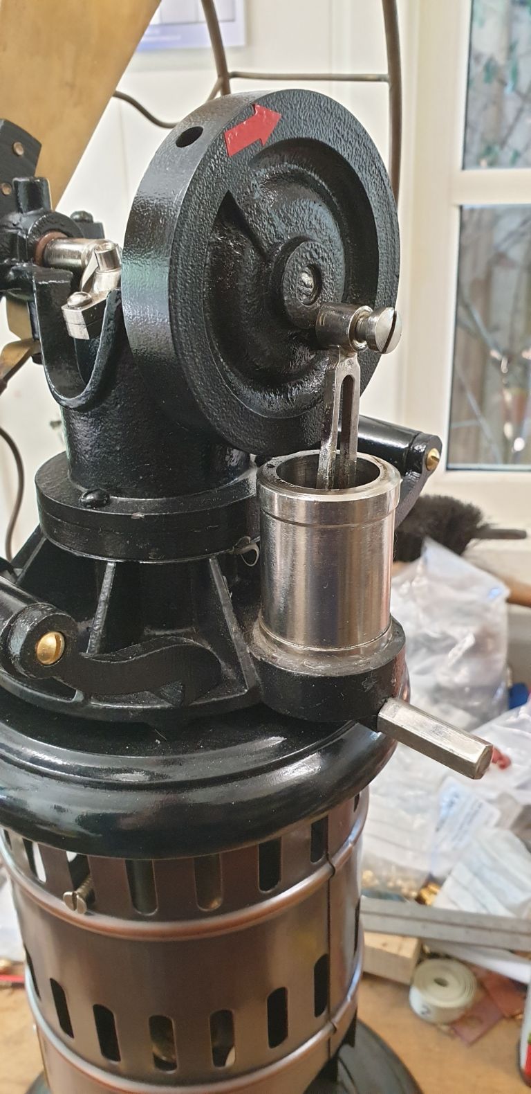

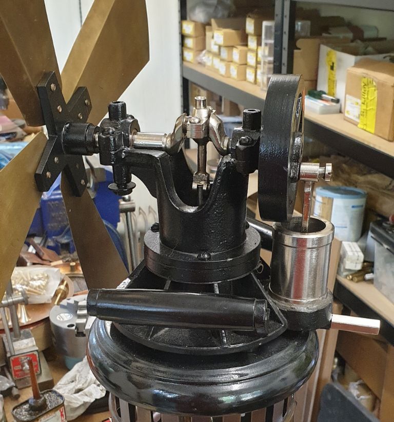

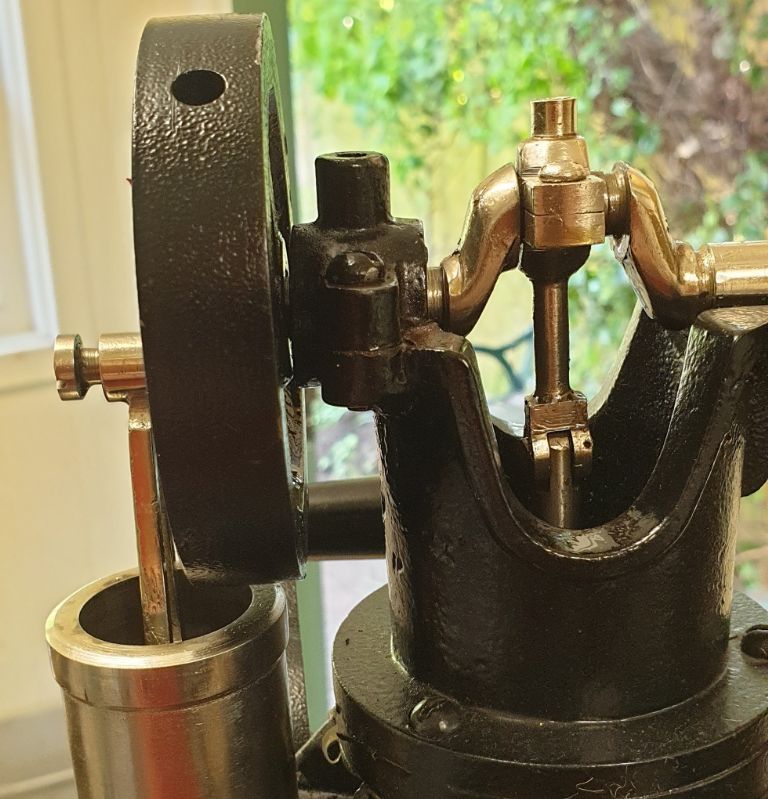

Good evening,
This afternoon I have been trying to sort out an Indian made Stirling engine fan. When it arrived it was clear there were issues and so far I have sorted the main (?) one which was a bronze bearing was out of place causing binding. Its now pretty free running, I am aware Stirling engines in general can be quite sensitive in this regard. However the engine is not yet running. The flywheel is attached to the crankshaft by a socket grub-screw through its rim but there is no indication as to where on the crankshafts circumference it should be secured. I have photographs showing the crank is in the uppermost position and the flywheel, which I have tried at various points, so I could really do with some advise as to how to align the engine parts in question as this affects the piston position.

I should add that at one point it felt like it wanted to run but did not quite, but backwards. Any help would be much appreciated.

Try adjusting 180° out and note the change.

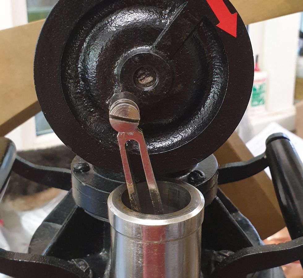

Usually the crankpins are set 90 degrees apart. Looks in your last pic like the displacer crank is at TDC but the power pistons crankpin is at about 4 or 5 o'clock, so a little bit out. Maybe try moving the flywheel so the central displacer crank is at top dead centre and the flywheel crankpin is at 3 o'clock.
From memory - which is vague - the displacer (centre in this case) crank leads the power piston by 90 degrees. So if it runs the wrong way, as Mark says above, move the flywheel 180 degrees to reverse the direction.
Two things stop Stirlings from running mostly: Friction that absorbs the little available power. And leakage around the displacer con rod seal or around the power piston or at some point in the connecting ports etc.tini
The fan looks like a beauty. More pics would be much appreciated. Let us know how you go getting it running.

As hopper says 90 deg would be a good starting point and the displacer leads

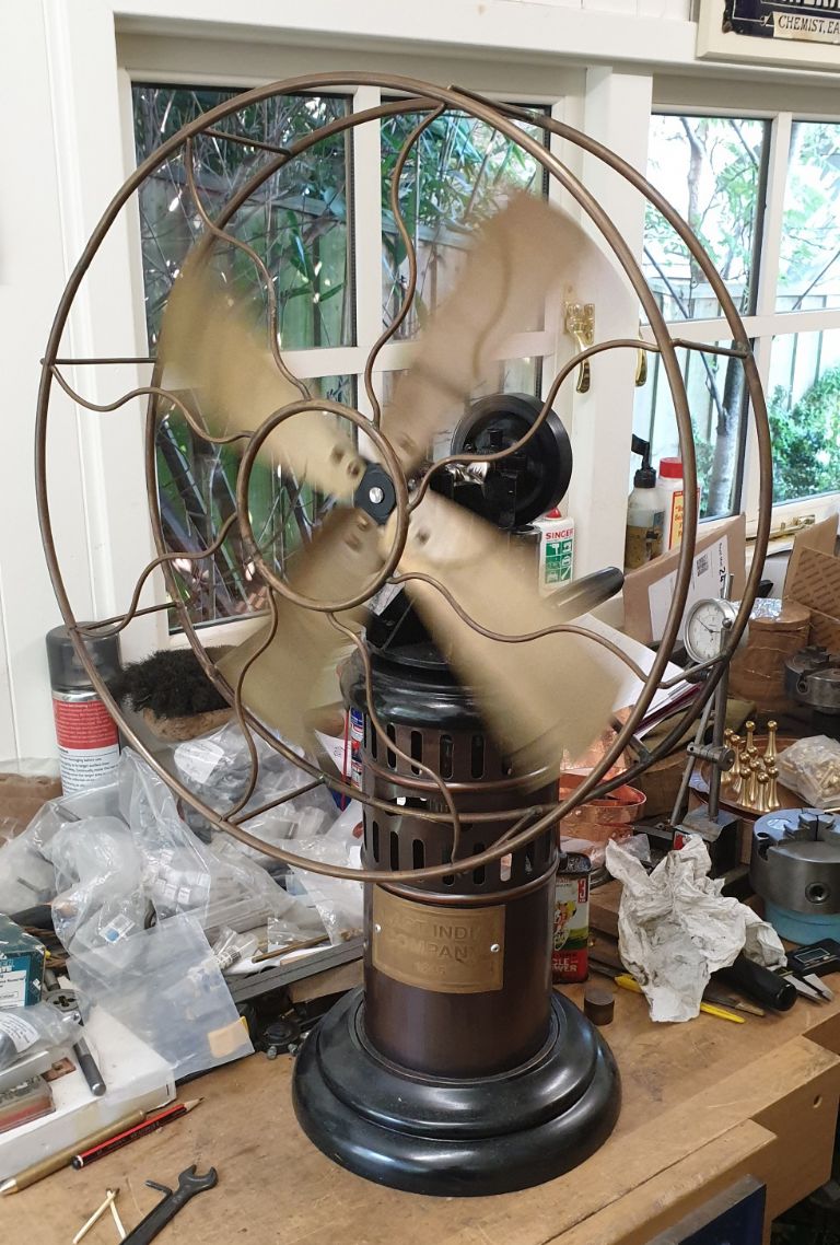

Ok Progress! (-: Thanks again to all so far, especially Hopper for going into detail, as a novice engineer spelling it out to me is what I needed!
This morning I set it at TDC & 3 o'clock and off it went...backwards. Re-set at 9 o'clock it ran forwards for maybe 5 mins...happy as a happy person can be (me, not the fan). I tinkered with the positioning and got a second run of similar time. Then I could not get it going again. Even though there seemed to be a decent flame still I tried putting more meths in and then I got a good run of maybe 15 mins, then it stopped. After lunch I will try with the remaining fuel, if it doesn't start I will refill the burner in case its fuel hungry.
Ok its now after lunch and restarted it ran for 15mins, so it wasn't low on fuel. Inside the vented body there is a funnel which you can adjust up and down, as it was at its lowest I raised it but could not get it to run. So lowered it again and topped up the Meths and it ran for about 45mins.

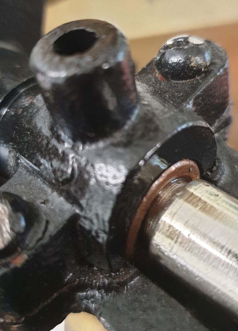

As mentioned one of the bronze bearings was out of alignment, when I removed the clamping plate that secures it (does that part have a name?) I noticed that whilst it has an oiling hole cast into it there is no corresponding hole through the bronze bearing.
To my mind there should be, otherwise the oil will mostly only travel down to the outside of the bronze bearing bush, not to the crank. If I should drill the bronze bearings what sort of size hole please?

It looks like a sintered bearing (oilite type), so no problem?

Thanks Not done it yet & Dave,......My understanding is sintered bronze(?)/ oilite is oil impregnated bronze, so no need to drill through, but still add oil which will seep through the bearings to lubricate the shaft?
