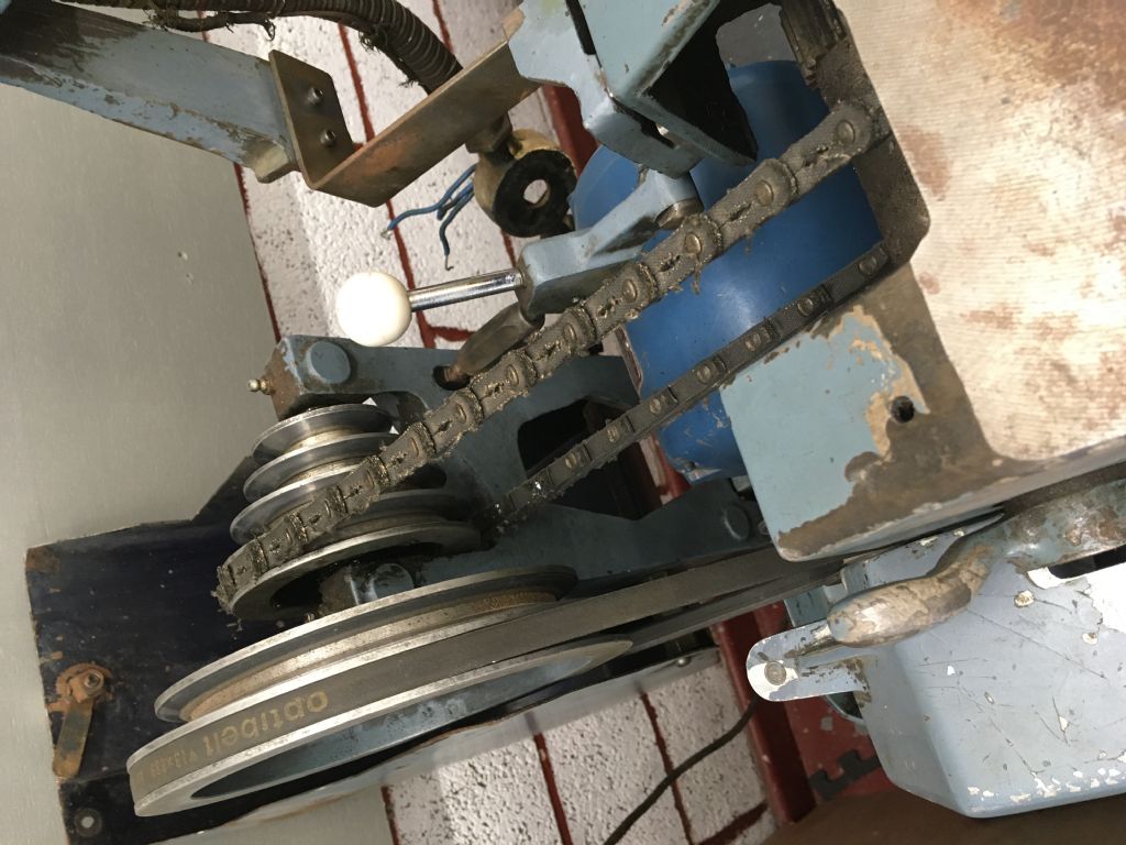

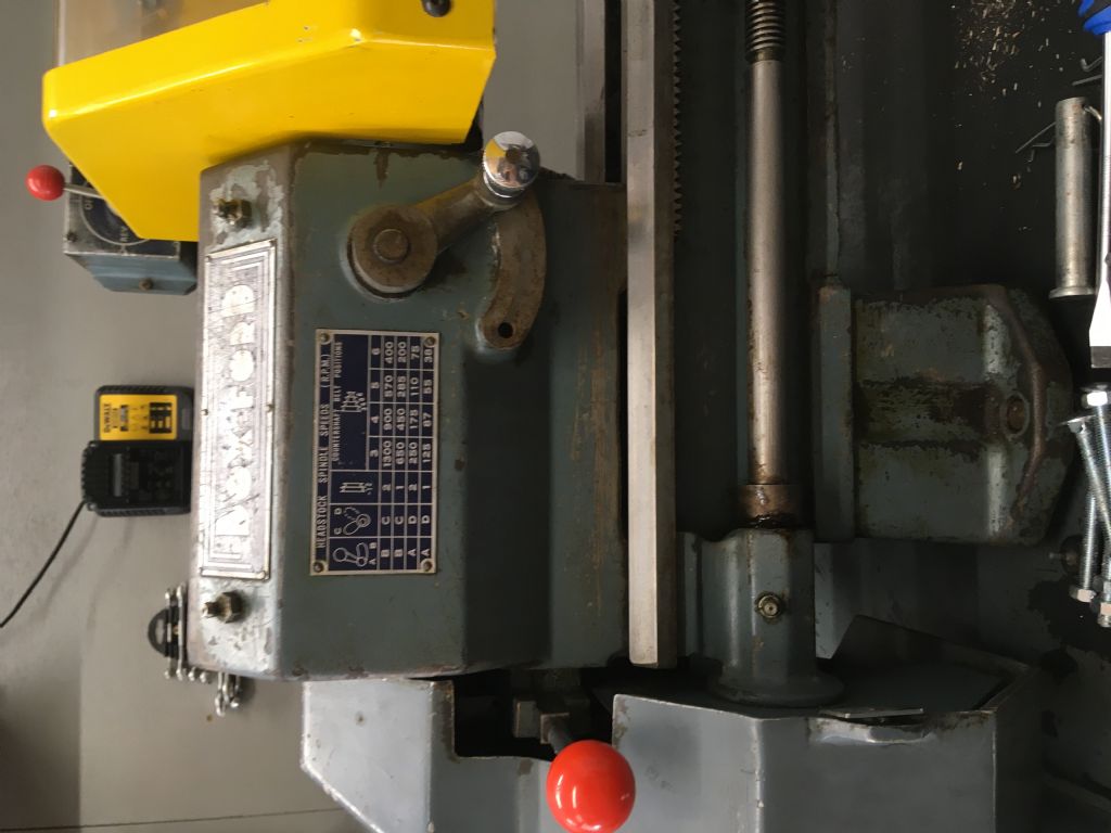

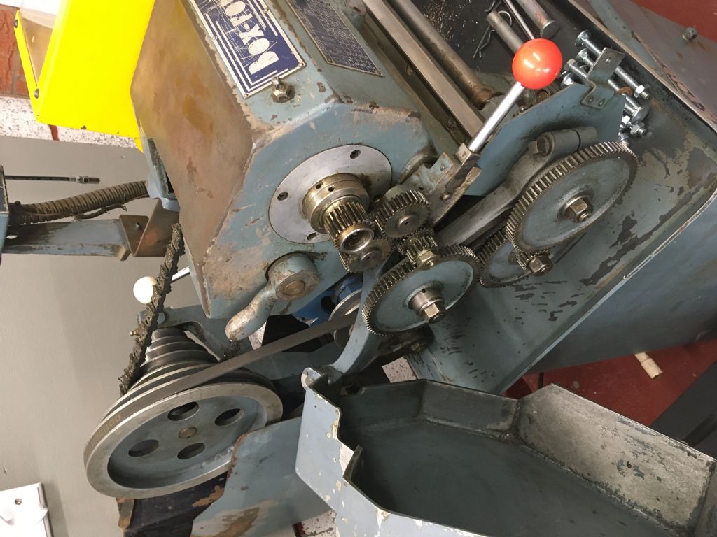

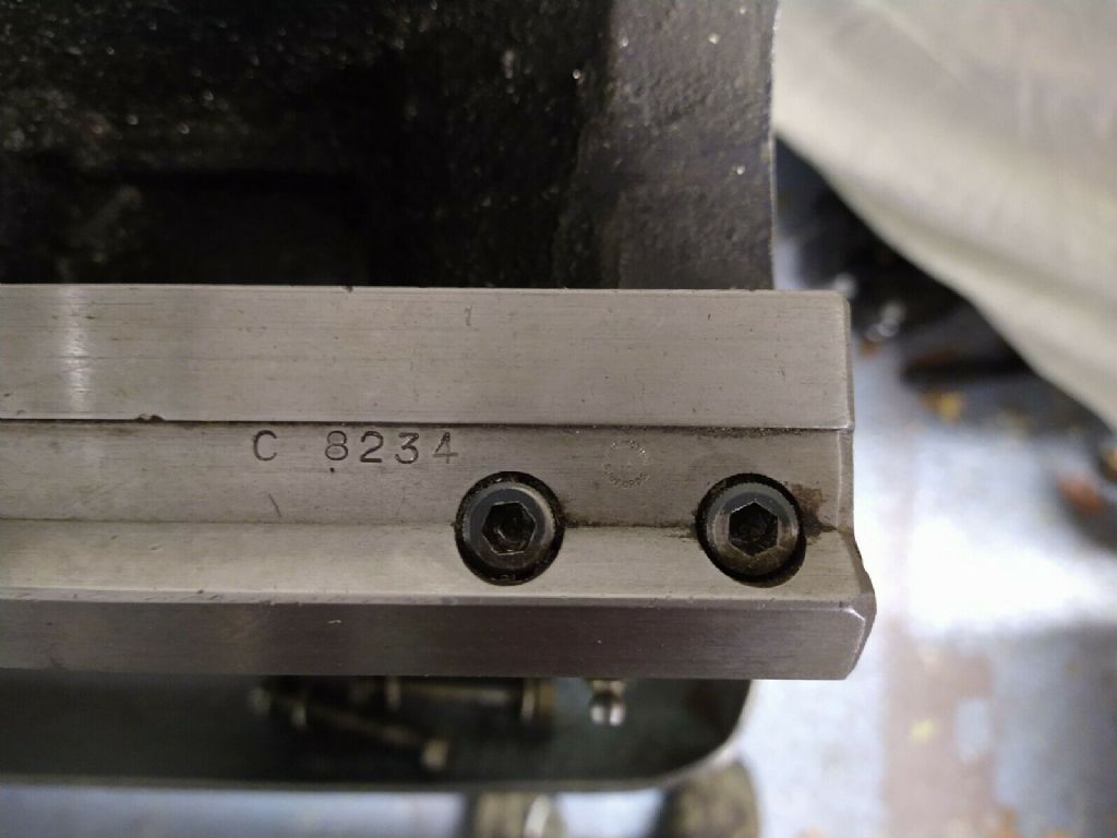

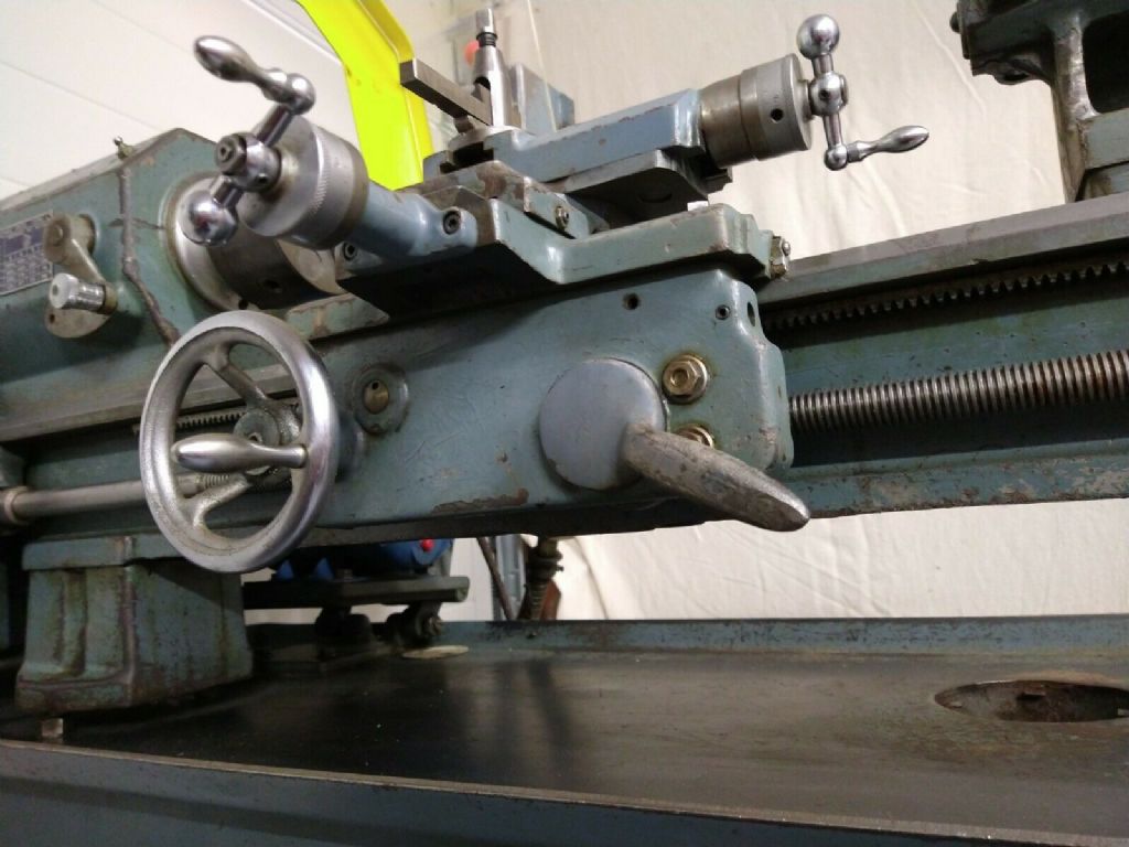

Because I’m a novice to using a lathe I was wondering if anyone could identify my boxford lathe model because the home of Boxford said I had a Boxford BUD, but I think I have a Boxford C lathe?
The lathe is stamped: C8234
see pictures below. What do you think?
Steve.
Edited By Steve Jones 20 on 14/04/2020 14:17:06
Yngvar F14/04/2020 14:16:26
75 forum posts
54 photos
You are right , it is a model C made in 1958.
Your lathe has the same rear drive as the original South Bends.
Most later Boxfords had the motor inside the stand, or a under drive UD.
Edited By Yngvar F on 14/04/2020 14:16:58
