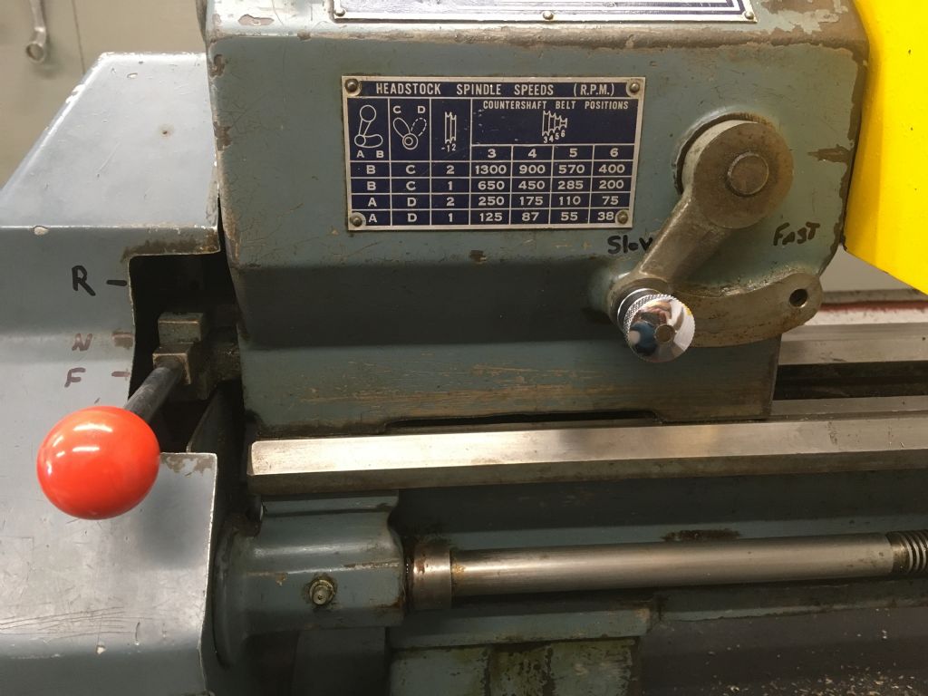

23/04/2020 10:52:28
Ok, so I’m happy to report that the issue here is me and not the lathe (easier fix). Now that I know where the correct position is with all the various levers all seems to be great so I can forget about a reversible motor to change the direction of the spindle as I don’t need that anyway now that I’m beginning to understand what I want to do with the lathe and how a lathe works.
So what I wanted to do was actually make the leadscrew move forward and then backwards as required so that the saddle moves automatically.
I have now identified the following options with all your help:
  • 2 speed lever (Fast or slow)
  • Auto Saddle selector lever
  • Saddle move forward, neutral, and reverse lever
You guys have all been brilliant with advice and pictures. I can’t thank you all enough. Sorry if my questions are a little confused at times but I thank you for being understanding.
image 1: showing my markings for the 2 speed lever (Fast or slow) and Saddle move Lever marked as R,N,F for Reverse, Neutral, and Forward.
Image 2; showing the grey lever (Saddle selector lever) in the position to engage the Auto Saddle.feed

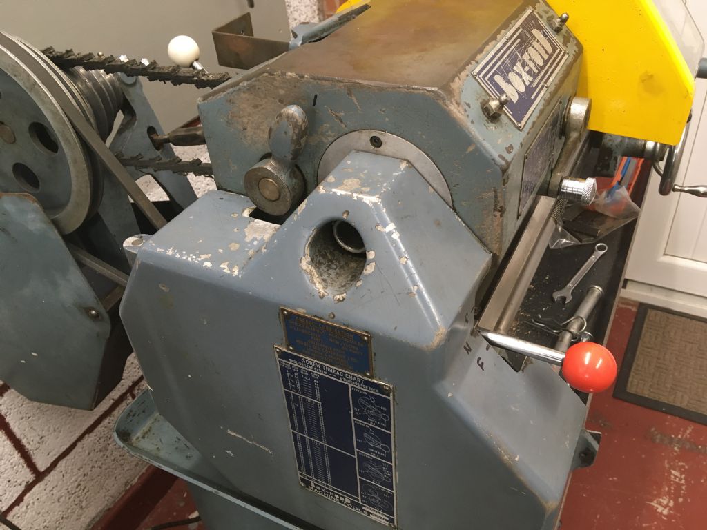

18/04/2020 21:55:39
So, I followed instructions from “Know your lathe manual” and advice from those above (thanks guys, much appreciated) but I’m still having some issues. If I want to do some screw cutting I cant reverse the lathe.
Apart from the neutral position, when I put the reverse lever in the up or down position the main leadscrew revolves in the same direction as the main spindle.
18/04/2020 14:15:21
My 1958 Boxford C Lathe is not letting me select reverse, am I doing something wrong or are the gears faulty. I can use the lathe normally but not in reverse.
When I select what I think is reverse (as I’m a novice) the gears seem to just lock up.
What advice can anyone offer?
Steve
