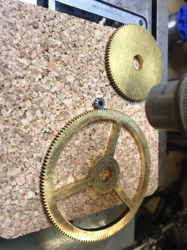

Dave S14/04/2020 19:12:19
433 forum posts
95 photos
Here’s my 144 and 12 tooth, as cut. They are 48dp, not 32 as I misremembered earlier.
Photo taken at 40x mag through a toolmakers microscope.
Whilst I would agree that relief makes a better cutter it is possible to make good work without, but you need to have sympathy and understanding of the cutting process.
