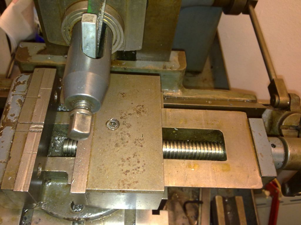

Posted by Joseph Noci 1 on 10/03/2020 15:21:48:
I believe the shaper vice screw is under tension while a 'normal' vice screw is under compression....
Well, so it is, on mine at least:
The nut behind the fixed jaw is in fact two nuts locked together,, and is clearly where the reaction takes place in contrast to the weedy collar at the other end. Generally I'd have said that shaper vices tend to be brick built outhouse style compared to machine vices of comparable capacity. Not sure if it's odd but the vice pictured has a square thread rather than Acme.
