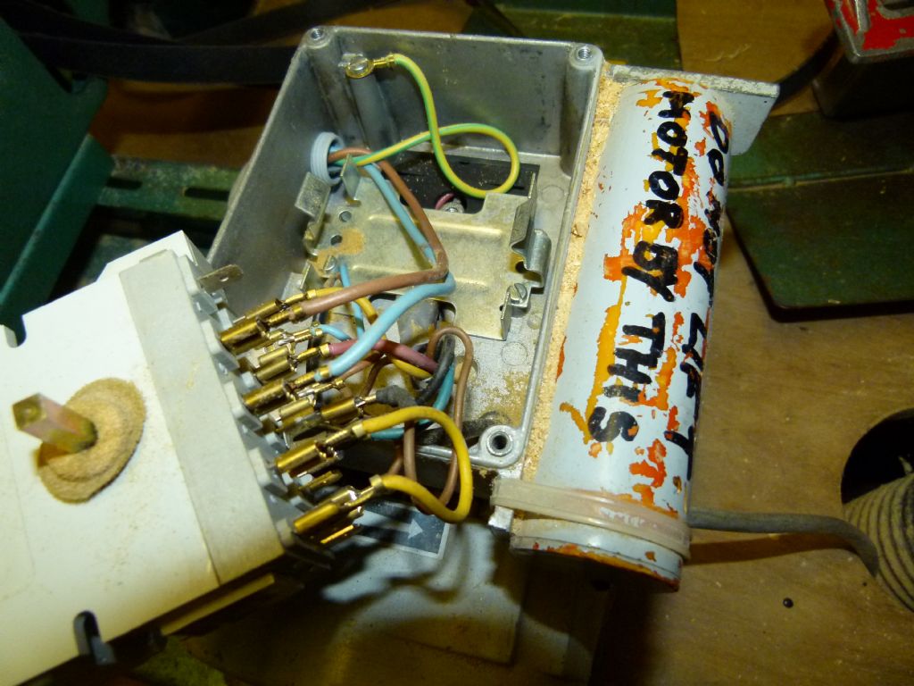

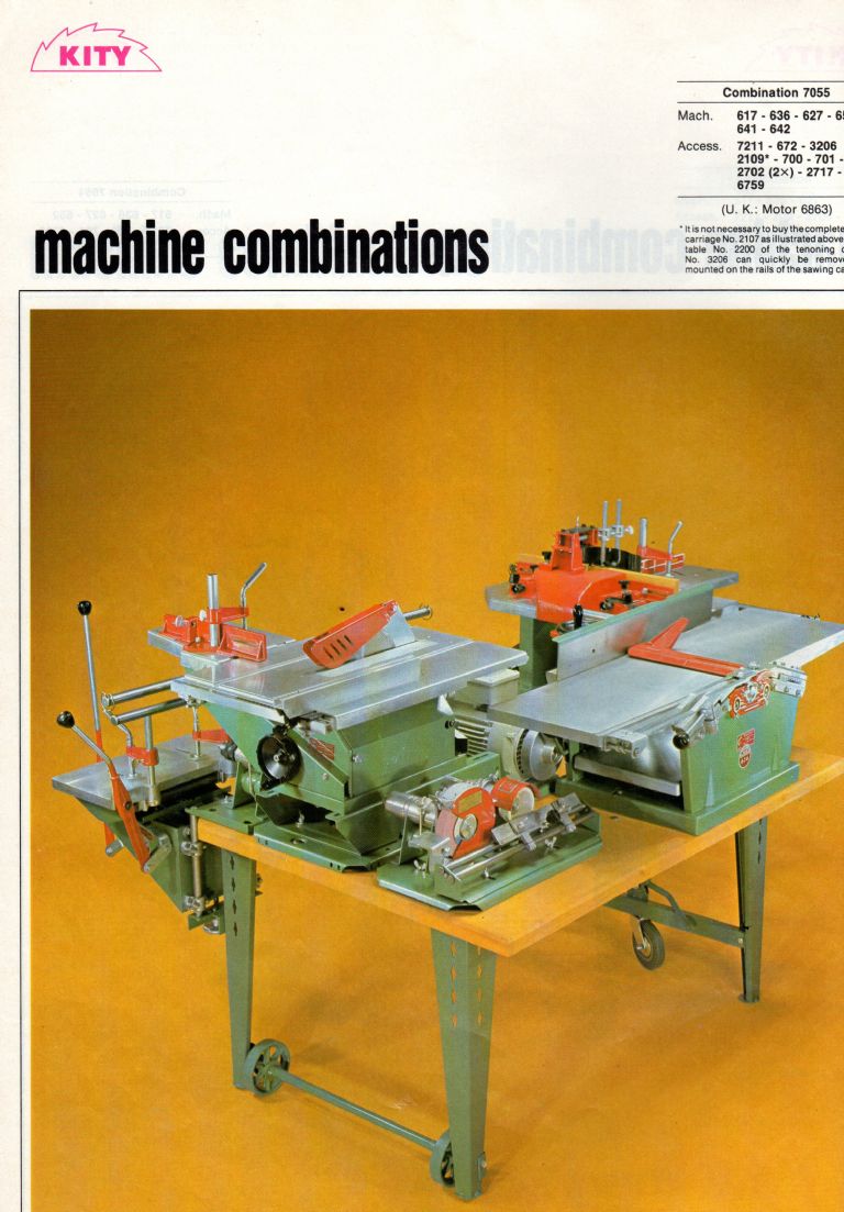

Hi Everyone

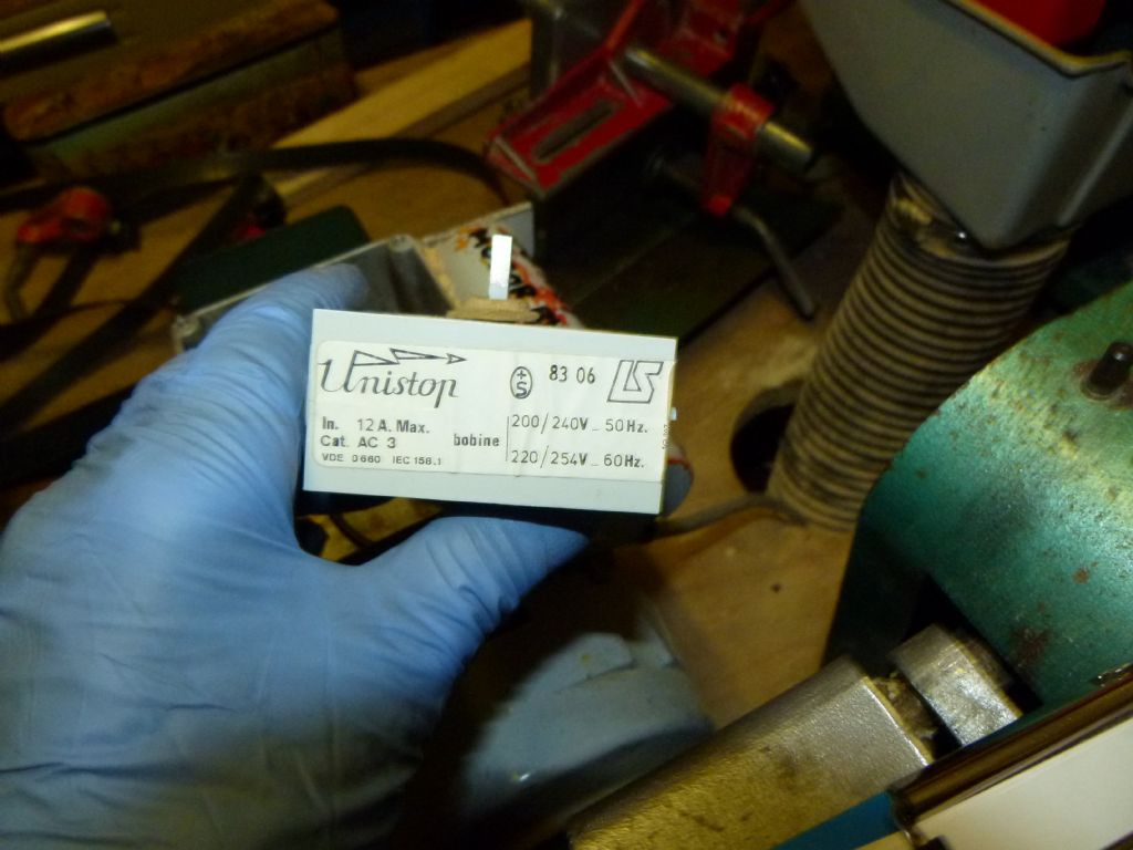

Can anyone advise what would be the best setup for a switch or switches for my woodworking machine.
Just to put everyone in the picture I’m referring to an old Kity Combination Machine, the type where the individual machines were fixed to a wooden table and a motor placed in the middle of them with the NVR switch attached to the top of the motor.
I've used the machine for a good many years with this setup but I’m getting a bit older and don’t really fancy having to lean over running machines in order to turn the motor off, just to add the switch is still working perfectly but I would like to change the setup if I can, I suppose a switch near each machine would be ideal or one which could be moved about if thats possible.
I’ve included some pictures just to show the present set up.
My thanks to anyone who can come up with some suggestions. kity combination.jpg
daveb02/01/2020 20:35:30
631 forum posts
14 photos
Fit a DOL starter switch at the edge of the bench. Connect the existing plug lead from the motor switch to the OUT terminals and the original plug lead (or a longer one) to the IN terminals.

The original switch is a nvr so Daveb,s suggestion won’t work.
i would replace the switch with a contactor and then place as many fixed stop switches around the machines as you feel you need
then have a start and stop switch on a pendant that you can place next to the particular machine you are using
The idea of having fixed stops is so you can be sure you can get to one in a panic if the pendant moves

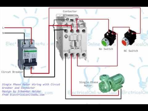

Would a wiring setup similar to the attachment work only with more stop buttons?

you can wire in as many stop switches as you desire in series with the stop switch in the diagram.
its always best to put an overload in as well with a motor (although one wasn’t there with original switch)

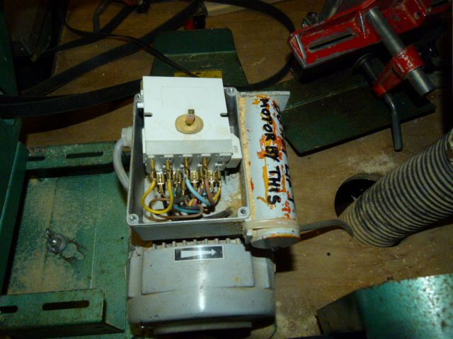

the round cylinder mounted on the side is a capacitor which kicks the motor to start in the right direction.
that motor you have is a French one ..they always seem to be able to do things electrically differently than anyone else.
the switch is a contactor with a rotary start switch and it only relies on the plug fuse for overload protection
a modern starter has a thermal adjustable trip to protect the motor better.
its best to look after that motor as it will be difficult to replace.. as its double ended ?

Thanks for telling me what the cylinder/capactor is for, I must admit I thought the motor rotation direction was derived from the windings, but then I don't know much about electric motors other than they can turn clockwise or anti-clockwise.
I also uploaded a picture from the Kity booklet and it looks like the motor is equiped with a thermal overload no volt release.
I take your point about the double ended motor drive, I'd probably stand a better chance of motors.jpg the lottery than locating a replacement motor, so yes I will continue to look after it. smiley

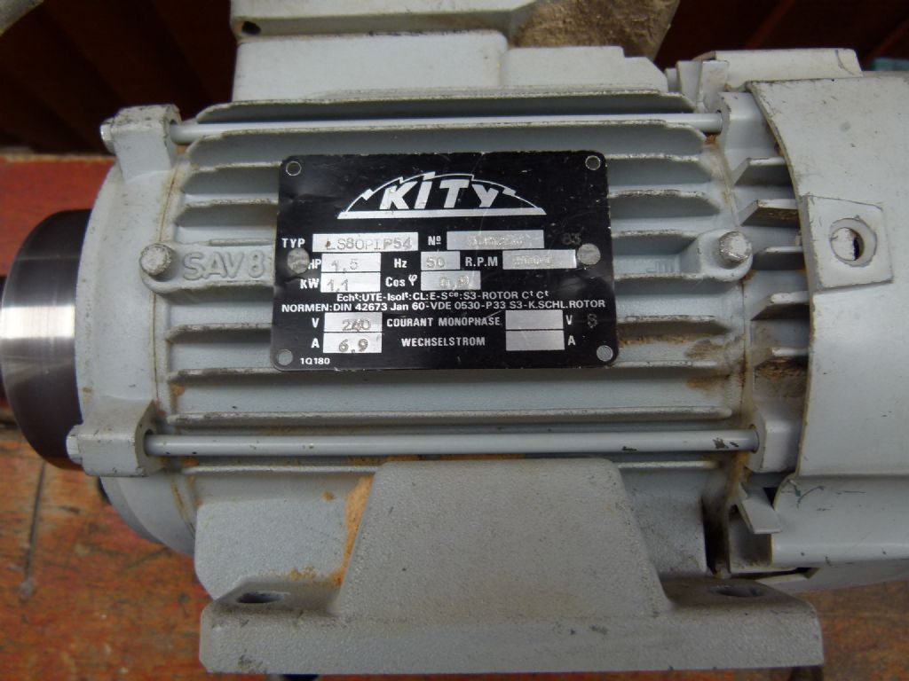

Emgee

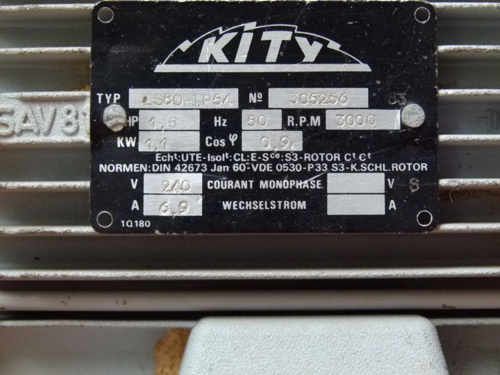

Iv'e taken the motor off so I could get a good look at the spec. plate and typical it doesn't say a blind thing about FLC or in the booklet about the motors (as in the picture I sent to Ian)
All thats on the plate is as shown in the picture below.
Any ideas on my best way forward with that one?
I guess I can have a look at some DOL starters and get in contact with the sellers or manufactures and hopefully they will be able to advise if their product would be suitable for my needs, having said that the motor itself is only 1.5HP, so I don't think the street lighting will dim on start up serge.
I still haven't got around to doing a sketch of how I think it should be wired, but I will post it on here and hopefully someone if not yourself can give me the thumbs up or let me know if I will end up blacking the whole of the UK out laugh.

Your thermal overload may only be thermostat in the windings it’s hard to see from your photo how many wires dive into the motor itself
your current is marked as 6.9 so you need an overload say about 7.5 or so
Clive B 107/01/2020 19:07:57
110 forum posts
76 photos
Hi Ian
The current is marked on the plate as 6.9A it’s anyone’s guess if that’s the start-up current, so as you say 7.5 should be ok.

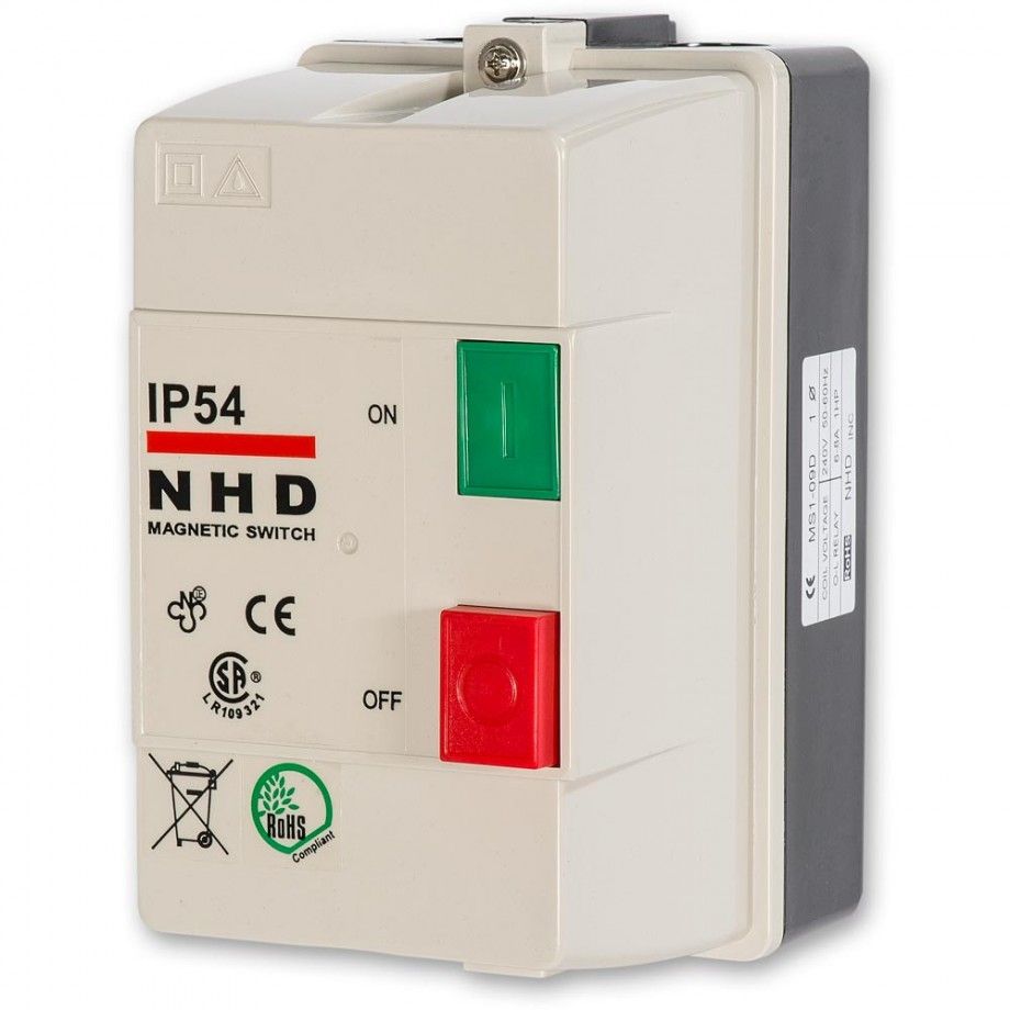

Anyway, I’ve been having a look at the starter in the picture advertise by Axminster Tools £54.50 of which they do one rated at 1500w so should be good for 1.1Kw
I’m not 100% certain it comes with overload protection, so I’ve sent them a message asking a few questions including how big it is.
I don’t really want something that’s too massive if I can help it.
Emgee07/01/2020 19:58:02
2610 forum posts
312 photos
Clive, see spec below, make not shown so may be an import from China which could be bought for £30 on ebay.
  • Adjustable overload protection: Order number 340192 for 6A to 8A overload (suits your motor)
  • Can be used with additional foot switches, interlocking micro switches or thermal overloads
  • 175mm high x 100mm wide x 130mm deep

Emgee07/01/2020 22:38:38
2610 forum posts
312 photos
Clive, search for this item number: 331208499128
230v coil
5.5-8.0 A overload
Emgee
