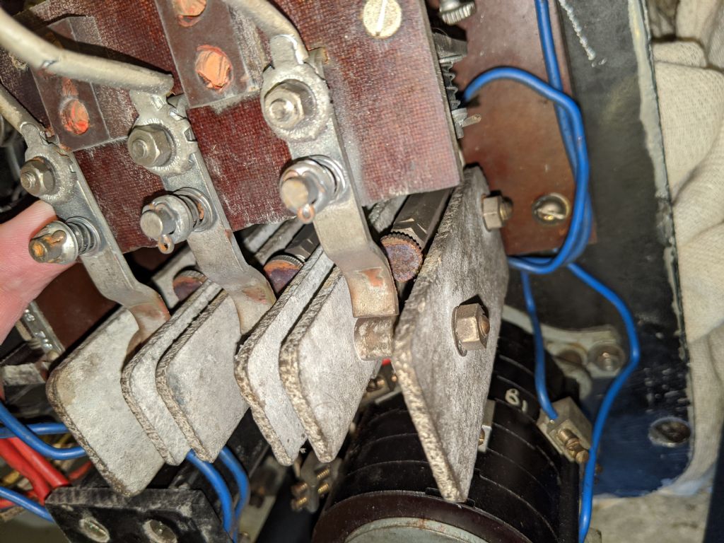

may be the centre tongue from whatever this is: (I think it's the contactor)
Slightly worrying that someone has already been at the electrics.

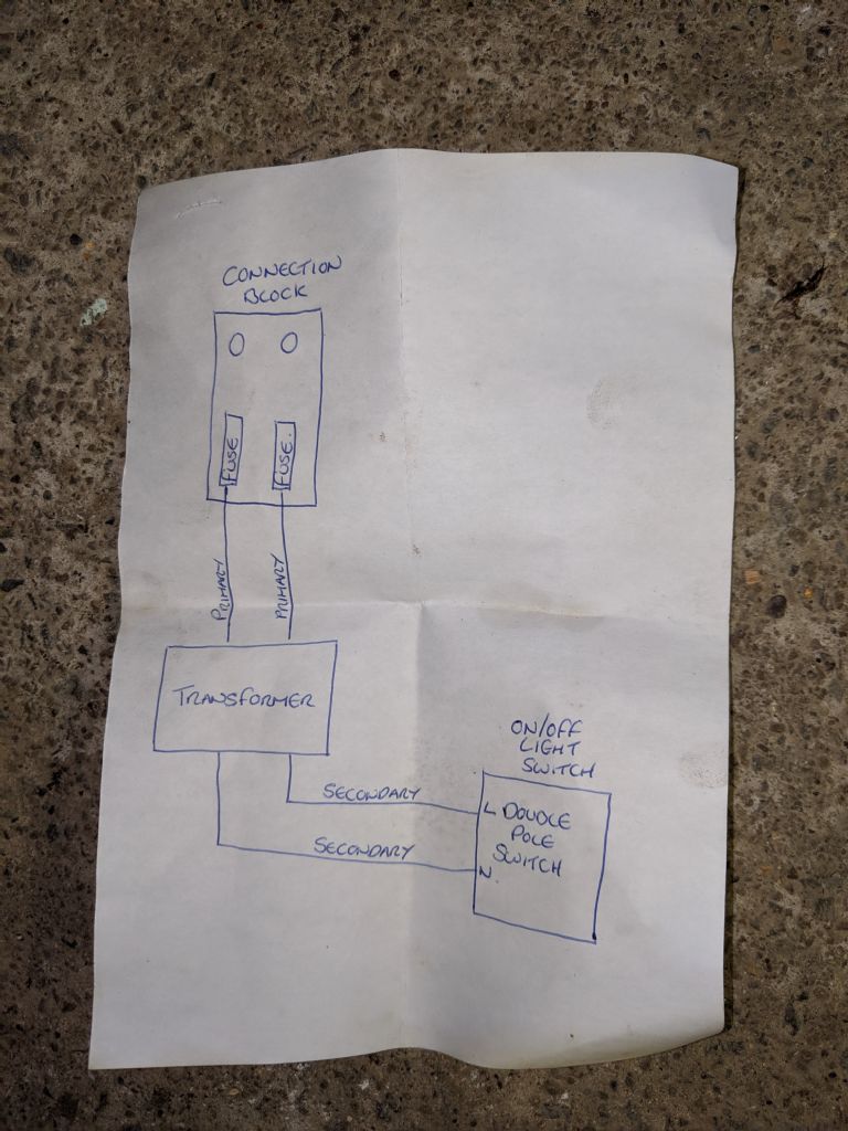

and the missing indicator lamp:
Tempting to assume it's a major rewiring job, but it's possible it was left in running condition. Check everything obvious first. Then look for missing connections, bust contactor, broken rotary switch, or duff motor. That will involve tracing the circuit with a test meter, which is another subject.
Any Colchester owners able to positively identify the contactor? Are those fabric insulated pillars inside short wide coils thermal cut-outs that might need TLC?

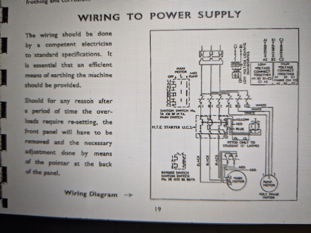

Hi there Richard, first off, do you have a manual? If you search the files at colchester lathe user, you can download one, if you have problems I can send you a pdf. There is a wiring diagram in it. In the pic below, the square box on the back of the headstock operates the contactor, and is operated by pressing the front lever with the red knob down.

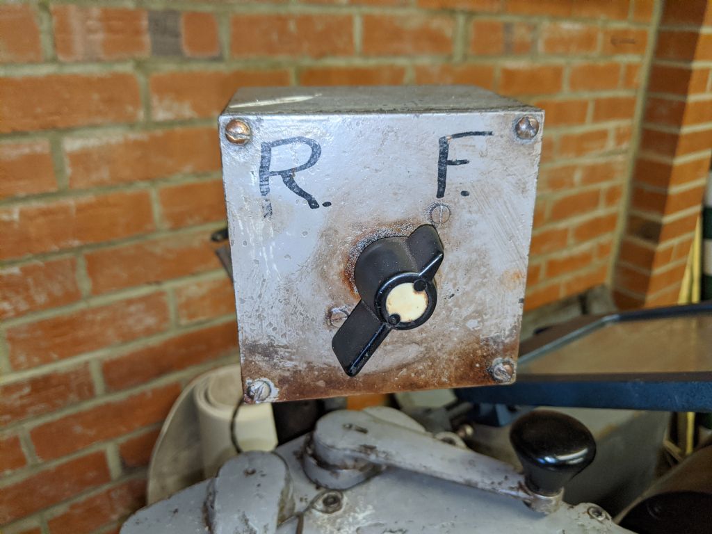

Just a small thing, and probably wont apply, but the Student has a key switchin the opposite end of the metal cabinet, you put a small key in it and turn it, and it opens the cupboard doors, and turns the power on. most of these are disconnected very quickly by owners, but worth checking. You need a mains tester with which you can check the presence of mains power at the contactor terminals safely!! First, check that the front lever is operating the switch correctly. can you send some pics I have a student Mk1 and I am next to it every day, and can answer most questions you might have by checking mine. Where are you in the UK?

Colochester lathe user has changed to https://colchesterlathe.groups.io/g/main, The manual is in the files section for download.  just thought if the coolant pump is running switch is either bridged out, or in the on position, forget that bit!

But in this part it looks like the contacts are very rusted, if they are contacts that is.
As far as the light switch not being there, I would like to fit one, but I cant seem to find a genuine replacement for the part(any direction from anyone appreciated?)

Someone has definitely been in here before me as when i first took the cover off I found this drawingimg_20190906_213337.jpg

And yes I do have the manual specifically for the earlier model and this is the wiring diagram from itimg_20191125_133412.jpg

Hi Richard, mine is definitely a Mk1, but looking at the levers on yours I would say it is a very early mk 1, I do not have the "safety apron". If you can hear the contactor pull in when you press the front lever down, and the switch for the main motor is set to on, then it should run, stupid suggestion, the chuck guard doesnt have a safety switch on it? The main contactor is pulling in, and usually the safety switches are wired into the coil circuit, but who knows if a second contactor has been added. Turn OFF and disconnect the power, and with a multimeter, see if you can test from the contactor to the reversing switch, and from the reversing switch to the motor. This does depend on whether the reversing switch is before the contactor or after it, but I suspect it is after, it is a start anyway!

I'm getting quite confused with all these terms. Specifically which part is the contactor, is it this part? And if its not this part, what is this part and what does it do and why?img_20191125_125101.jpg

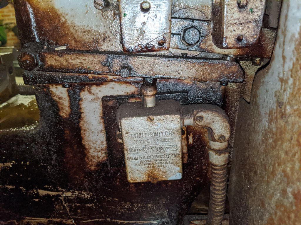

Or is it this part at the back. The piece that says limit switch has a pin that moves up and down when i switch the lathe on from the lever on the front and makes a click as it goes into place. But, I'm not too sure what noises i'm looking for?img_20191125_130059.jpg

Don't know if it's been mentioned but from memory Colchester students have a limit switch on the gearbox door, presumably to knock the power off if its opened whilst in motion. Might be worth checking.

The item pictured with 3 contacts separated by grey (asbestos?) insulation panels is the contactor. The contacts don't look great. If you can hear this clunking with the start lever operation the PC40 is powering it.
Do you have a multimeter / test meter? You really need to get into some fault finding.
First thing would be to check the contactor contact resistance you can do this with it unpowered by manually closing it , pushing down on the brown (Tufnol) insulator that carries the moving contacts and then checking the resistance across each contact.
